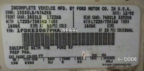

Related: SD Springs has a product chart using the spring code from your Ford door VIN label.
http://www.sdtrucksprings.com/ford-spring-code-listings
My code is N4J, so the rear springs are code J, and sure enough under the + E-Series Van link on that page, it cross references to a 3 leaf spring, with capacity of 3450 lbs per side.
Btw, my axle code is E2, which is a Dana 70 HD limited slip with 7400 lb capacity and 4.10 gear ratio, which is the standard setup for an E350 cutaway (limited slip was an option).
http://www.blueovaltrucks.com/tech-arti ... r-sticker/
I believe the E450 used a wider Dana 78 (80) with 4.56 ratio.
