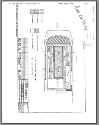

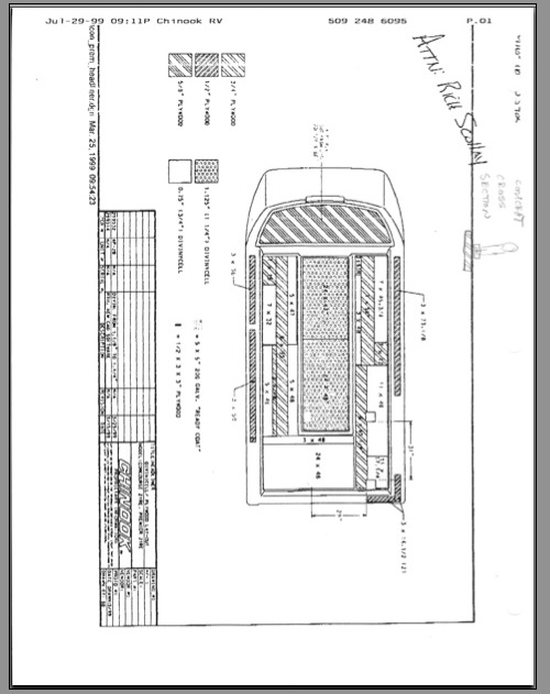

Here is a document showing what is in the roof from 1999 (my era). You can see that there is a strip of 3/4" plywood where the upper/inner edge of the cabinet is attached to the overhead. Hmm, well okay, .pdf is not allowed to be uploaded, and when I took a .jpg screen shot the detail was all blurred. Anyway, there is a strip of 3/4" plywood (in '99 anyway) that runs along where those screws are at the upper/inner edge of the cabinets over the couch. It is 6" wide and 95" long and starts right where the roof goes up and flattens out behind the overcab.

Testing on now being able to post .pdfs (thanks, Manitou!).
Roof and wall diagrams from Chinook/1999:
Okay, well I have another issue now. That is that each attachment is only allowed to be 256kb, and these are around 650 kb each (I did divide the document into separate pages, but each one is still around 650kb). But since they are .pdf, my normal ways of reducing a file such as a .jpg are not working.
Edited May 28, because Manitou fixed things up so larger files could be uploaded (thanks!)
Okay, so these don't show up as thumbnails, I guess, and you have to "download" them to be able to view them (at least I had to in my test). I know I don't like to "blindly" download things, so I will try to put a .jpg thumbnail here to show what these are. The .jpg will not be very legible, but it's just to show what the .pdfs are. Since this would make for four things in one post, I'll put them in the next post.
Also, if anyone downloads these successfully, could you let me know? I can't really be sure since already have them.
