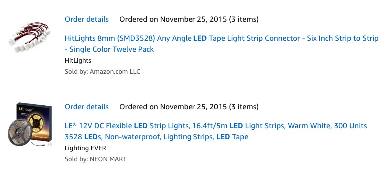

Most people want the "warm white" color. Not knowing which one at first, I bought both warm and cool white. The cool is too blue for normal lighting, so I used it inside the cabinets. You can also mix them to get a more flourescent like color.reddingnative wrote:On another note, can to point me to a thread regarding LED upgrades. This Chinook is loaded with 12v flouresent tube fixtures and need advice on color temp., fixtures and what not.
Also get strip-to-strip connectors. You can use them to connect two strips on either side of the old flourescent tube fixtures, and you can cut them in the middle to create two strip-to-switch connections.
Basically, you just turn off the flourescent light, remove the lens and the inside metal cover, cut the power and ground coming in from the switch and ceiling (honestly you could remove all the flourescent parts... no one goes back to them), and wire in one, two or more LED strips that you scissor cut from your peel & stick LED roll.
Personally I like to also wire in remote control switches / dimmers as well. Only a couple of dollars from China!
