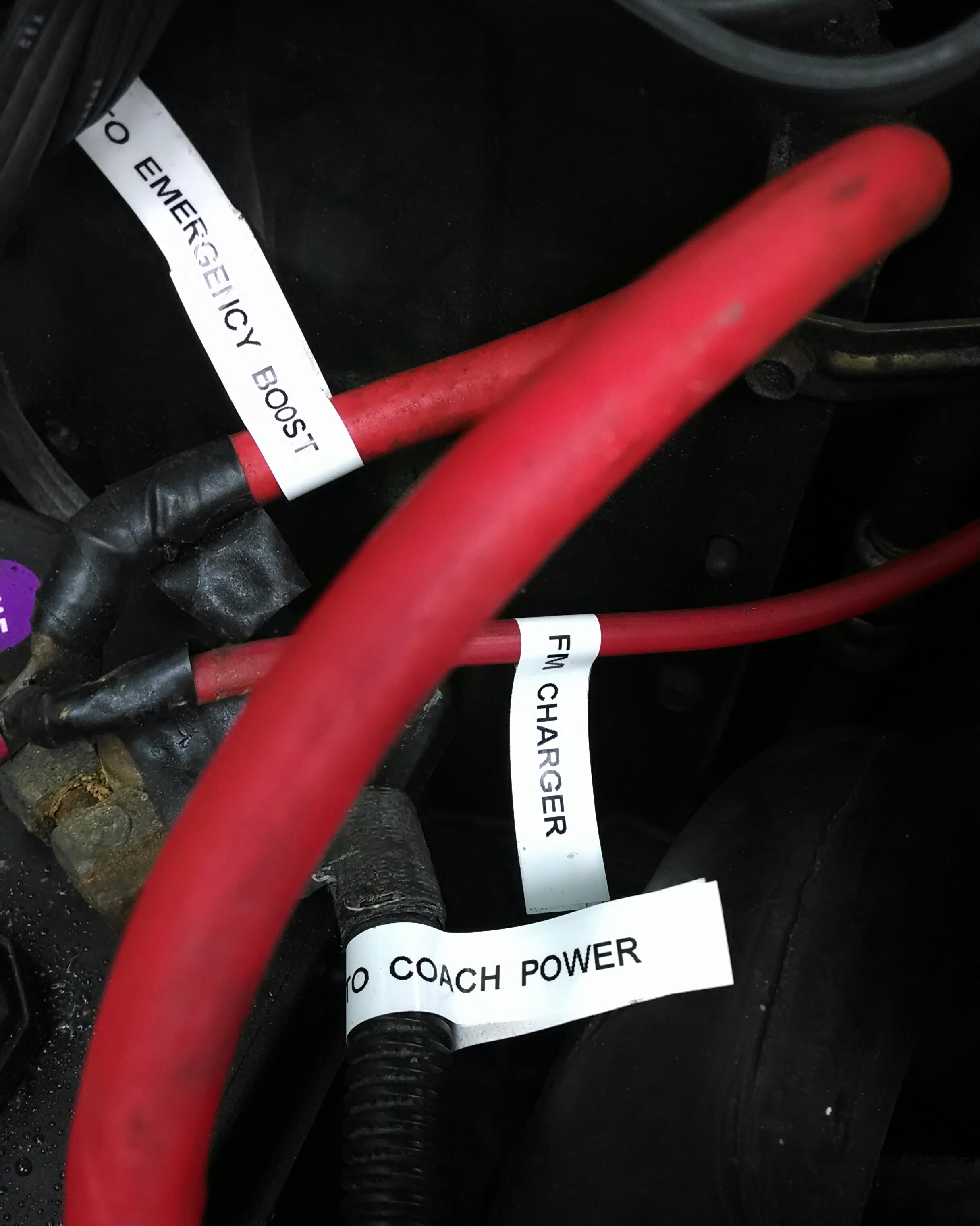

Yeah I've gone crazy labeling all the wires, from under the closet, to behind the fridge (helped when troubleshooting and replacing the power supply), and now plan on laminating wire color reference cards to go under driver's door sill, and under chassis for the big rear lights bundle. Will save me and others from having to dig through reference manuals all the time.

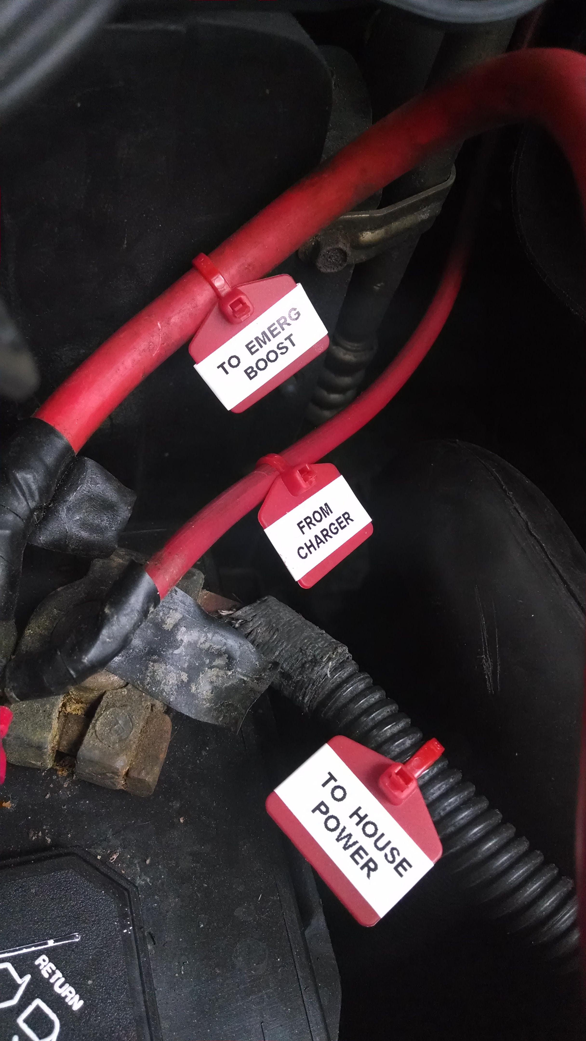

I started with masking tape but they didn't last. Here's what I use for labels now. Also bought an extra roll of tape. The only trouble is looping around larger cased cables. So now I just ordered these zip tie labels, and I'll either use tiny fonts on the labelmaker to write with, or just a Sharpie by hand. Edit: here's the new tags: Regards,

Yeah, I keep meaning to go back and wrap a strong clear tape around each label and its tag.
