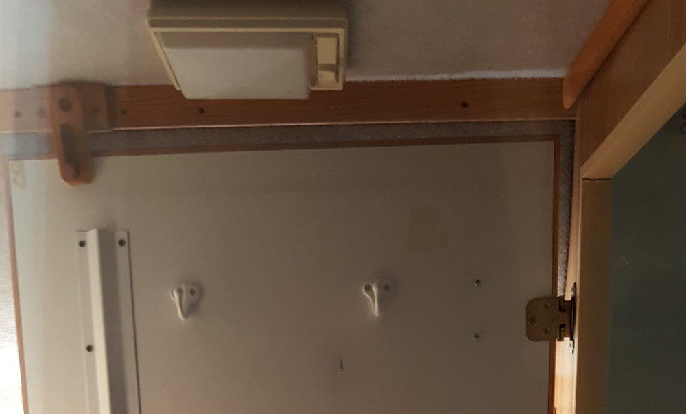

My Premier had a catch for the bathroom door that I suspect was installed by a previous owner rather than the factory. It's just a piece of wood that swivels down to catch the door, but it works great. This is a lousy picture that was taken for another purpose but that happens to show it. I can get a better picture if you want one.Colorider wrote:Also, as a side note, I'm planning on buying an extra catch to mount on the interior above the rear entry door to hold the bathroom door open for those times when we're barely off level. Has anyone else tried this?

Thanks for the responses. I think I'm going to try the .77" ones and drill out the hole on the catch (not the rv) if necessary.
I like that bathroom door solution. I don't have a piece of wood across the back to mount a door latch on. That gives me a good idea of how I can build one, though.

I like the wooden bathroom door holder. That "turn button" type of catch is often used on boats. Wood is nice because it's light, doesn't rattle, is easily formable, doesn't corrode, etc. It's easier with a door that is flush with the surroundings but can be done like yours with a pad. l like it!
I don't have wood there either (maybe it was added as a base for the turn button?), but then I don't have a bathroom door either
