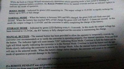

Okay, so they are doing a 14.4 volt absorption stage. That's good to know. They call it "boost" mode. Then float is their "storage mode." It's not uncommon for different names to be used for the various stages. They kind of gloss over bulk, but it's kind of in there (and that's not where chargers usually fall down anyway - it's just heave amps at the things).
So as long as 14.4 and 13.2 are good figures for one's particular batteries, and the battery temperature stays at around 77ºF, it looks pretty solid. Funny but those would be almost exactly the right numbers for my Lifelines (they call for 14.3 and 13.3) at 77ºF. But, my batteries are almost never at 77º during solar charging times. Since my rig isn't as "climate controlled" as a house, and since I like sleeping in cool rooms anyway (my batteries are under the couch), they are typically closer to 50º or so (cooler in winter) when they are charging (the mass takes a long time to warm up). Hence they actually need closer to 14.7 and 13.7 or more when cooler.
