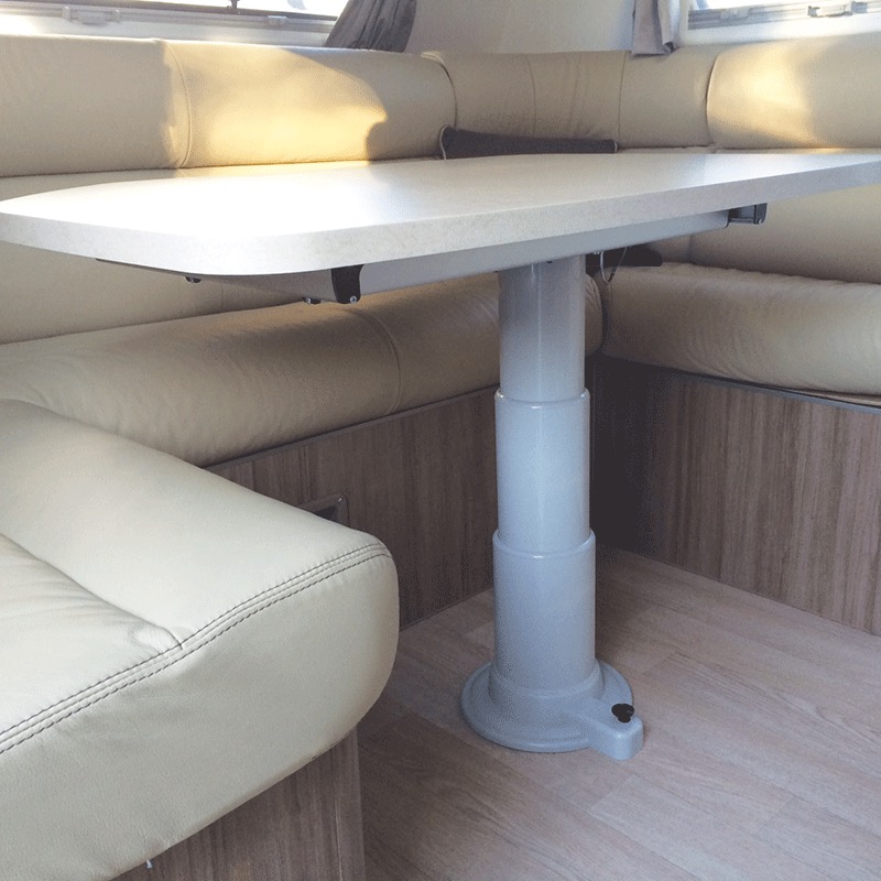

I have seen some tables with a telescoping center floor pedestal (originally meant for boats, I think). Check this AUD $350 (USD $270) baby out: https://youtu.be/tXfffo8TN3s. Also has a neat dual axis sliding top that rotates as well. If I were to make an RV office nook from a dinette, I might use this to switch from dinette mode, to desk with long edge along the wall, and a chair in the aisle. https://www.rvpartsexpress.com.au/index ... ystem.html

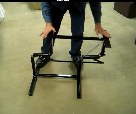

Or a USD $70 standalone hinged stand like this one: https://youtu.be/Zu1QpNzKtFY. Although it has much less leg room, I like the way the whole table can be moved. http://www.factoryrvsurplus.com/product ... ct_id=2546

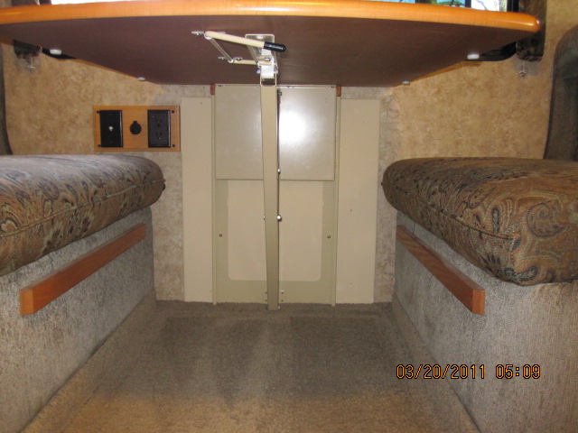

Got any pictures of the gizmo you saw on TV? Oh wait, did you mean this? https://youtu.be/K8tvZdb1dVY
If so, it's called the "Dream Dinette" mechanism and I have a link to the maker somewhere. Ah, here. They used to have a photo of it but not now. https://casshudson.com/12-specialty-rv-components.

Here's a link to someone's DIY installation: http://www.irv2.com/forums/f258/weekend ... 87412.html. Says they paid $150 plus shipping. Here's the installation instructions PDF: https://comnet2.newmarcorp.com/instance ... 104265.pdf

Thanks, Kev! The Dream Dinette is exactly what I've been trying find.

The problem I have now is that now that I've seen that Mapa table pedestal I really like the idea of being able to swivel the table top to create more space in the aisle between the sofa and the dinette. Now I have to decide if I want to take on the task of convincing my wife that we can't live without the Mapa pedestal. I may have to wait until my rig gets back from the guy who converted our jackknife sofa from an instrument of torture to flat surfaces who is now reupholstering the dinette side in matching material. Since we bought our rig last year I've dropped a lot of money into to it to get it right for us so I'll make the argument "we've come this far we may as well go for broke".
