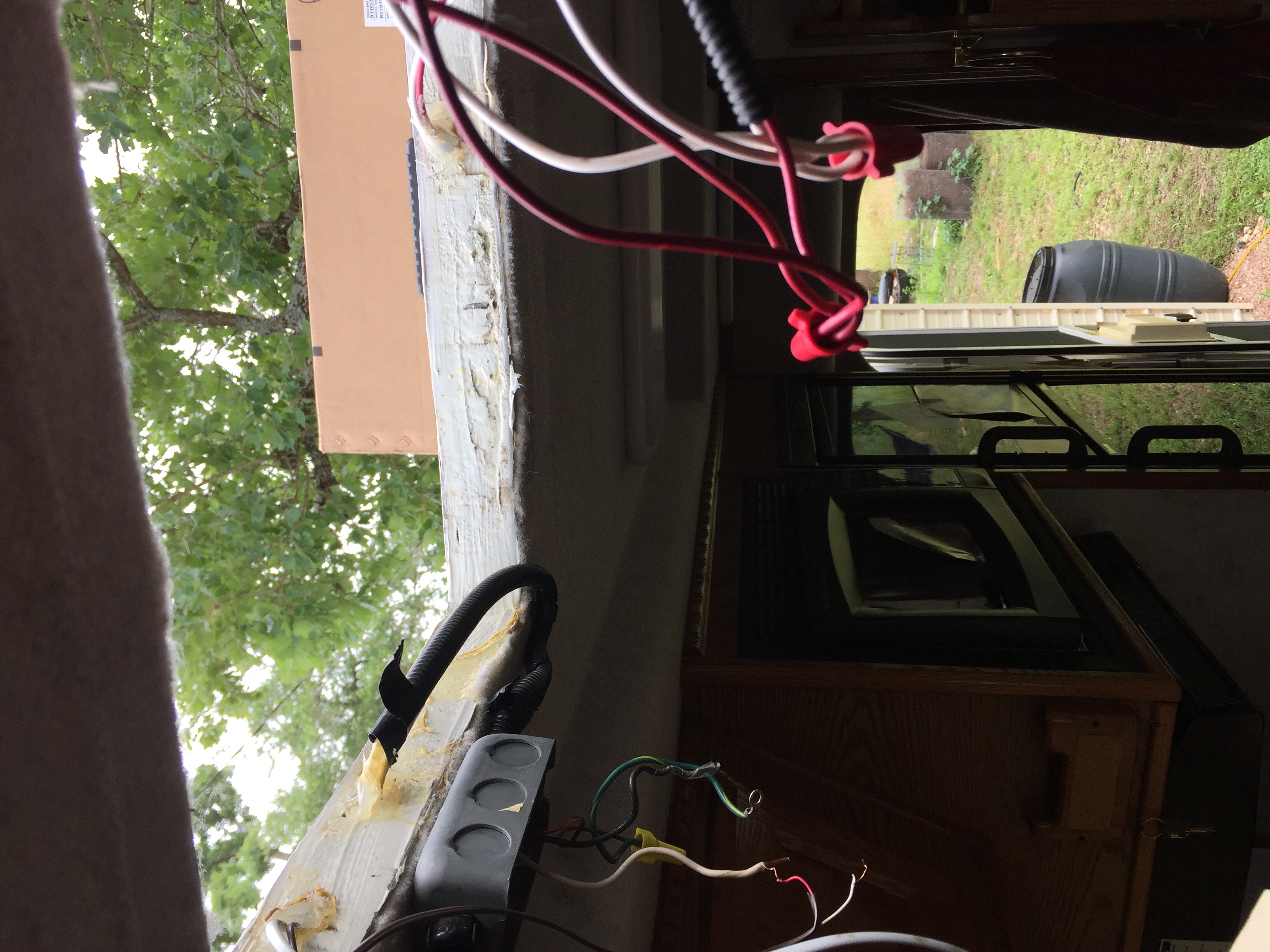

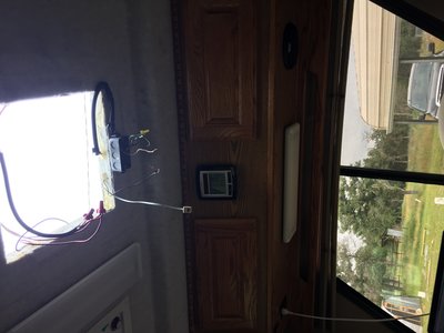

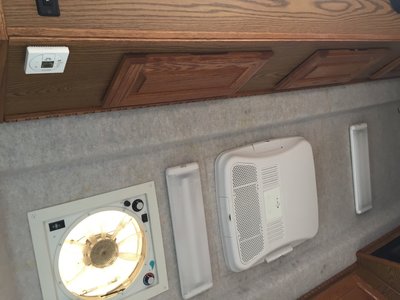

Was interesting to see your photos. The install/wiring looks just about the same as my '99. Guess they had no reason to change
