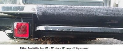

Wow, I actually feel "lucky" in some ways that my Concourse came with no extra step at all.
I ended up putting a less wide 20" single pull-out step to the right of the hitch ... with just enough room to insert the cotter pin for the hitch bolt.
Open, it gives a nice sturdy halfway up extra step. When closed, the step doesn't interfere at all.
