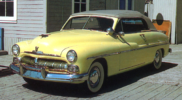

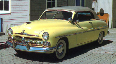

Santa Cruz hey. In the mid to late '60's I used to bomb over 17 from Fremont in my 1950 Mercury convertible, rent a board or two at O'Neills, stick them out the back, and cruise about trying to appear like a real surfer. Never really learned to surf. Fun times, long ago.

PS: Great surfer car throwback photo! I had it worse: Wannabe in the Midwest, without the car or the beaches :groan: :D

My cool Merc was sold by my parents back in 1970 when I was overseas "fighting Communism," for $400. It was registered in their name...

1950 Merc and late sixties Santa Cruz. I don't even know where to start. Sounds like paradise to me.
