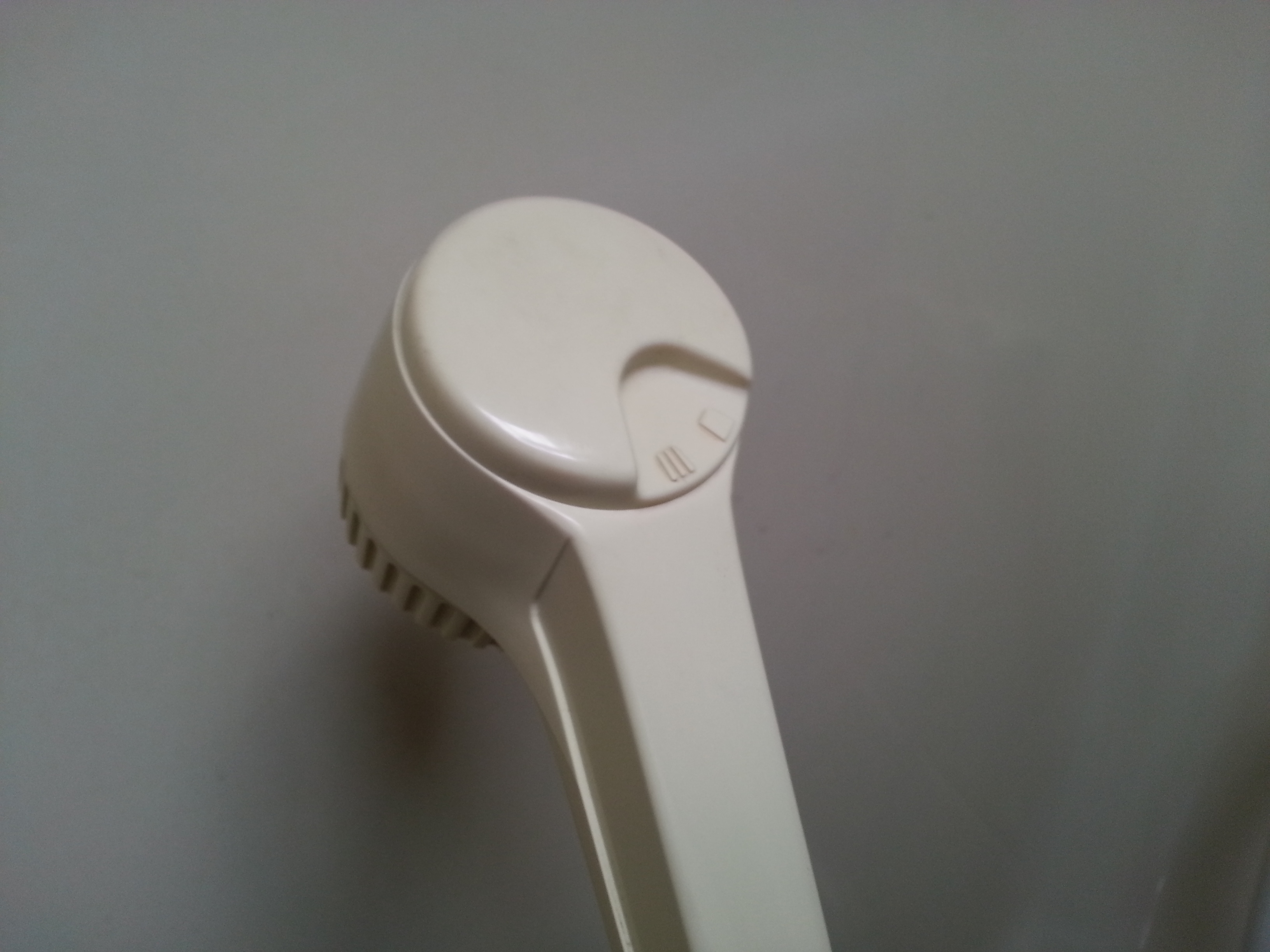

Blue~Go wrote: As an option, mount a thermometer such that you can run the water heater just up to the temp you like, then you can take a shower with "all hot" and not have to waste water re-adjusting when you turn it on and off to soap up etc.
My shower head has a rotary valve on the back just for this purpose. You set your desired temp at the faucet, then turn on/off with the rotary valve to conserve while soaping up. No re-adjustment needed.
Aren't they all like this?

Here's the valve:
Also there's these valves for same purpose:
