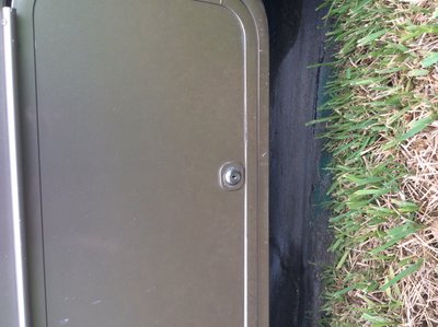

My locks are in less than perfect shape and besides.. There's too many keys. Anyone replaced them? I read on a blog/for sale chinook where the guy replaced them all with 1 barrel style key (like vending machines have). I don't have any details on what exactly to order/find though.

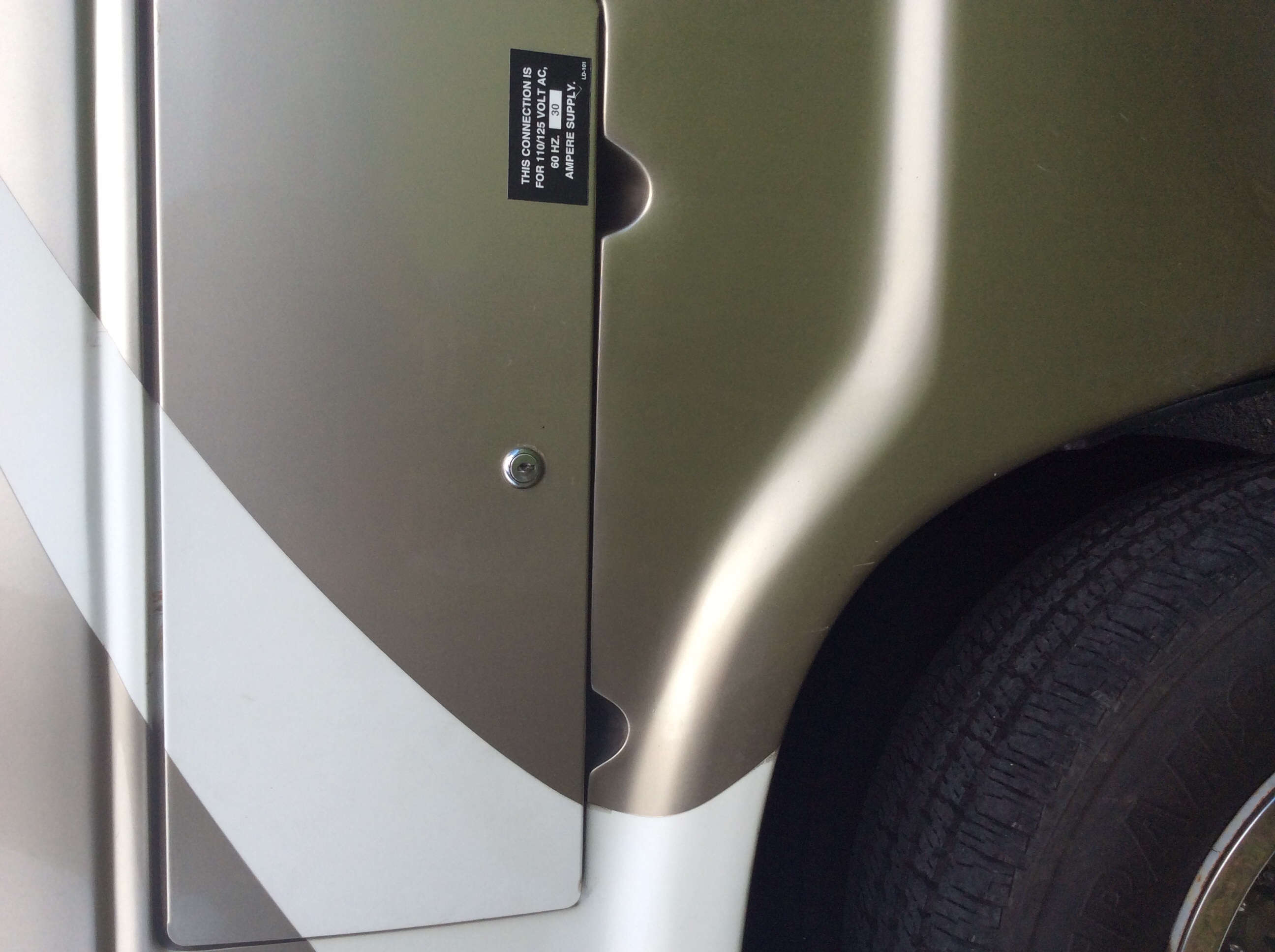

The drivers side and back hatch are the same, the passenger side, and the "safe" are different. It hasn't been as bad as it seemed when I was handed a ring of keys. Still on my nice to have list, but down on the priority level.

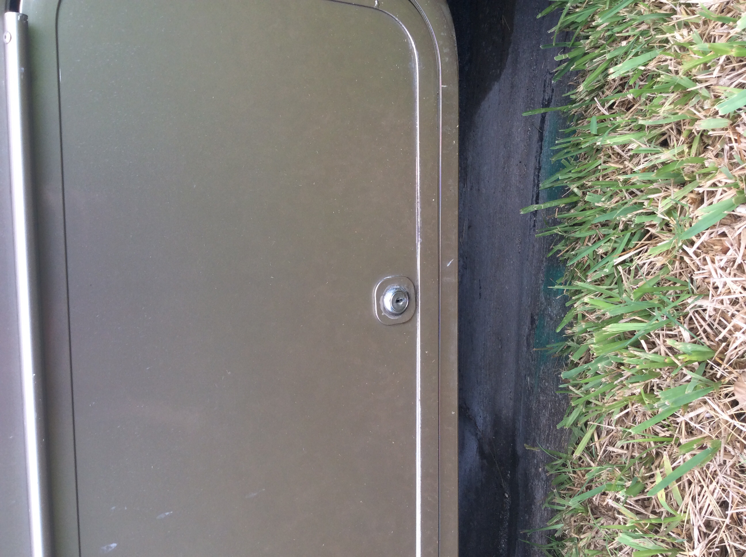

I've just started swapping all mine out with "combi-cams". They are a twist knob with combo instead of key. The outside ones are all 7/8" shaft. The safe is 5/8". I had to do some dremel one on the safe latch, but so far the outside ones have all been direct replacements. (Done 3..4 to go)
Skillet
Posts: 495
Re: Too many keys, want 1 for all outside locks
Post by Skillet »
Excellent. So pretty much as long as I make sure the shaft is 7/8", I should be good to go for any lock? Thanks for the info!
Posts: 795
yup. the ones i ordered came with 3 different latch types. seems pretty standard.
