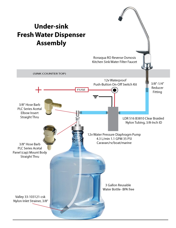

Preferring fresh drinking water from typical store bought plastic bottles, we wanted more convenience and less clutter from empty/partially empty bottles. There are some simple sink faucet and 12v water pump combo kits for the caravan market found in Australia/UK. However, they are pricey, the pumps are not self priming, usually of somewhat poor quality and loud when operated. The idea is to have potable drinking water from a tap at the sink. A 3 gallon water bottle which is a low profile (stubby) design is located under the sink counter. This size is easy to refill and carry (24 lbs. when full). A self priming 12v pump with remote waterproof on/off switch is activated by water demand when the faucet is turned on. To allow for easy removal and reinstall of the water bottle, a quick-connect barbed hose connector is installed in the bottle cap (we have an extra 48mm cap for transporting the bottle when refills are needed). Simple tubing and clamps are used to hook up the elements. A nylon strainer used for aquariums was added and weighted to stop the supply tube from sucking up against the bottle preventing flow. The faucet is similar to models used for reverse osmosis drinking water. No photos of the install yet, but a simple diagram with parts list is attached. All items were from Amazon, but for the quick-connect barbed hose connecter from eBay.

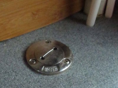

2) A 1-1/2" hose runs straight up to this marine deck fill, which is in a relatively unusable area behind the sink in a corner. You can just see the 1/2" Pex vent tube in the corner of the pic. Since the RV mfgr had already run a cluster of pipes and etc. up through the counter in this location, we chose not to "hide" the vent. Otherwise we might have.
