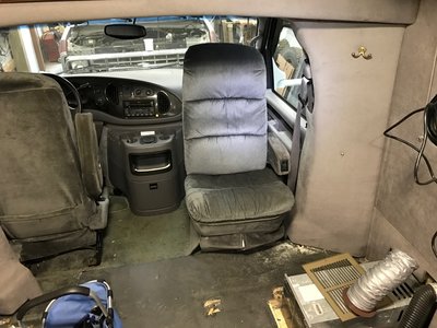

Today I installed the passenger seat swivel base. I really like the use of space. The chair is much more comfortable (to me) than the dinette seating or the jack knife sofa.
The swivel base didn't swivel at first. I had to remove the locking pin and loosen the nut that at the center of the mechanism. This turned out to be a 30 minute diversion. Nonetheless, the rest of the installation was pretty easy. Rotating the chair is not all that difficult — just moving the seat back and forth to clear the pillar and the doghouse.

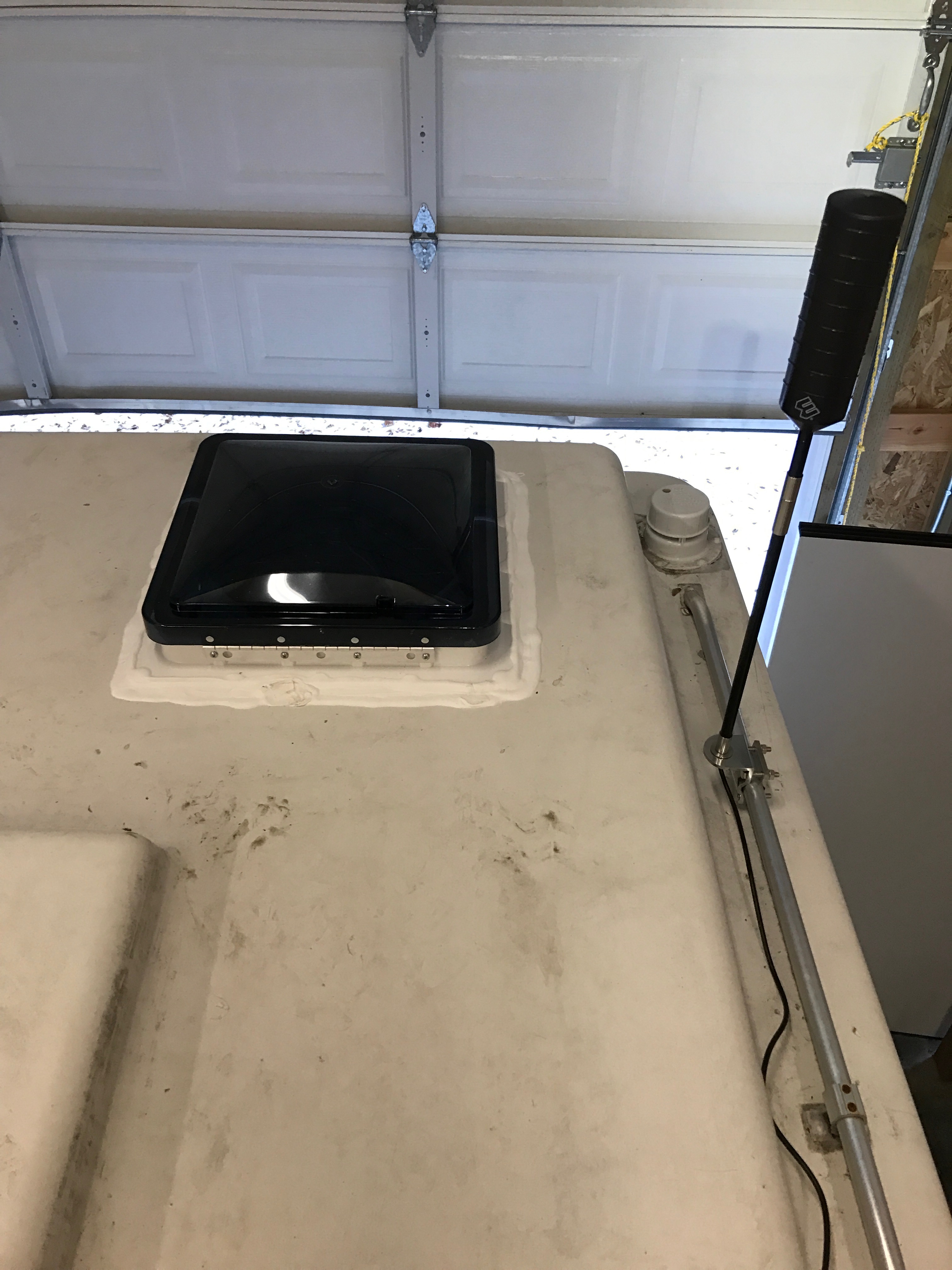

- I installed the new Fantastic Fan 803350 12V Vent ($220) in the bathroom. I'll have to figure out lighting in the bathroom since the previous fan including a light fixture. I might just use a battery operated LED light in the near term.

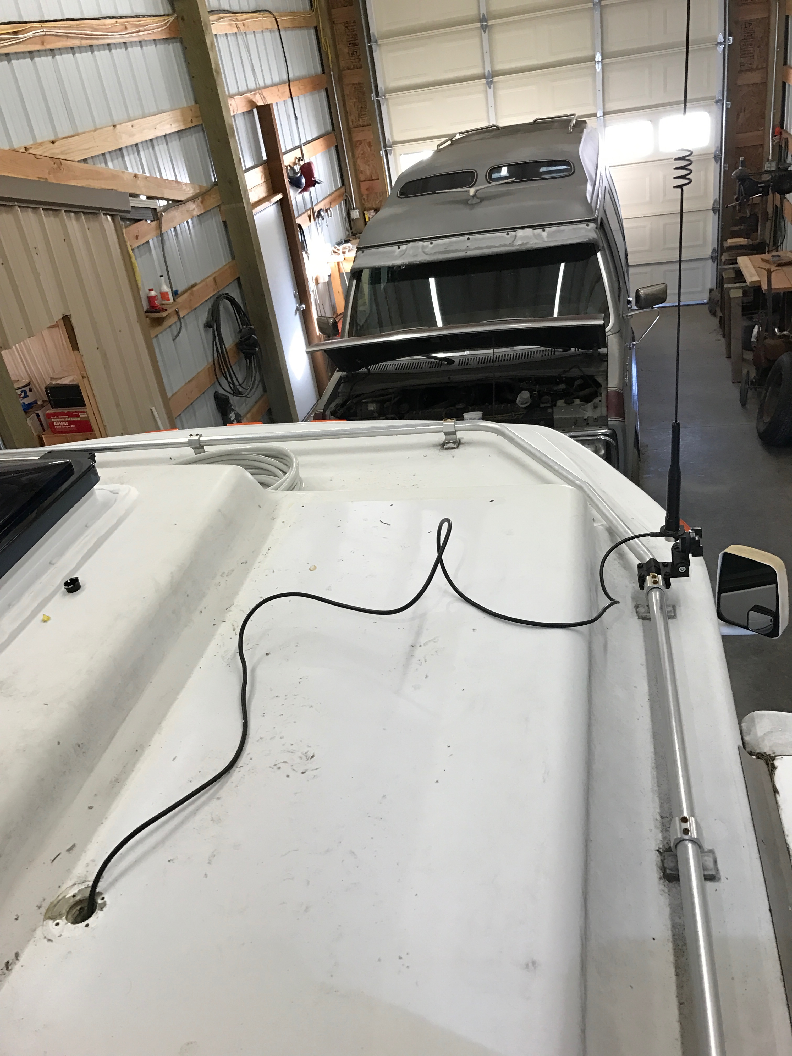

- Using the old solar wiring conduit, I ran the wiring (feed line) for the UHF/VHF antenna from the roof into the above-cabin cabinet. I installed the antenna (Comet-NCG SBB-5) on the Diamond K540KM mount to the passenger side rail. It has a swivel mechanism allowing me to manually rotate the antenna flat to the roof.

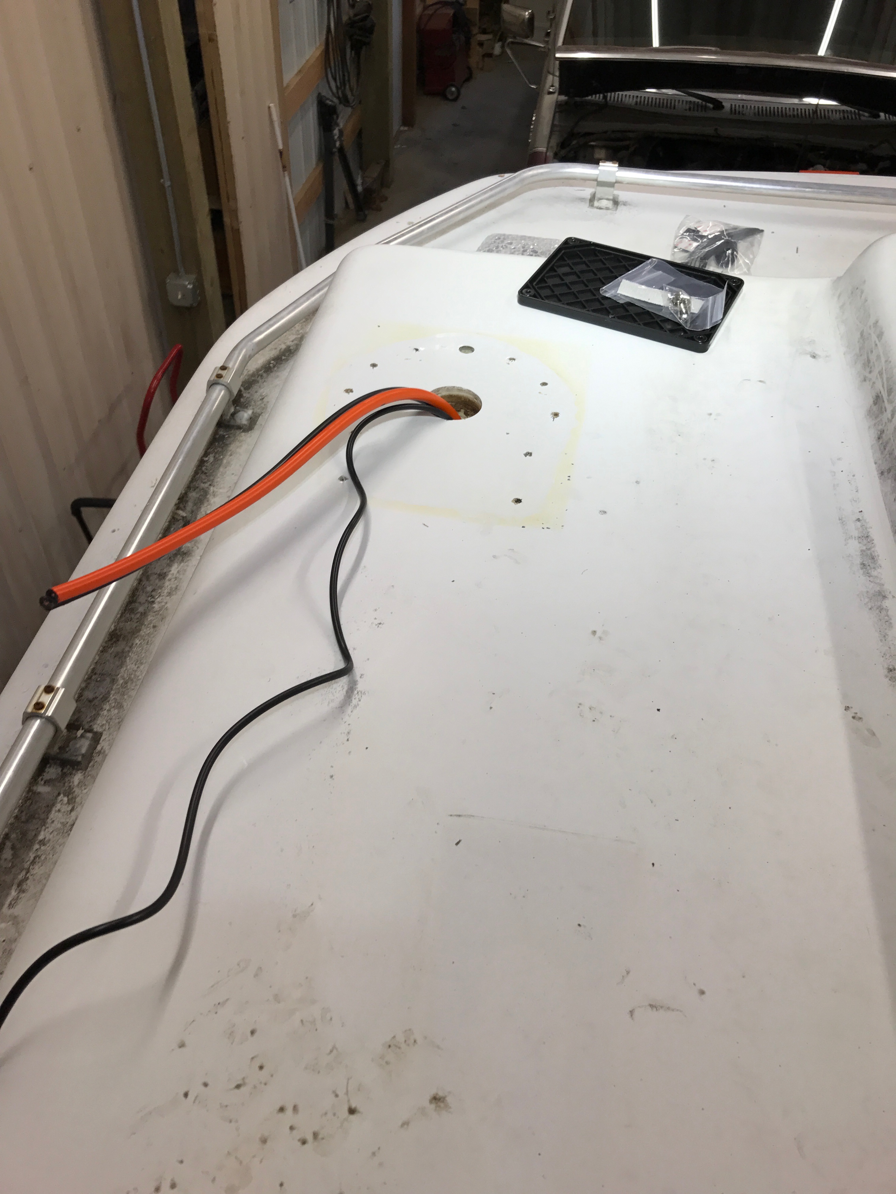

- Regarding the solar system installation, I ran the wiring from the roof through the old TV antenna hole to the driver side cabinet and forward to the above-cabin cabinet, and down the driver side pillar toward the battery compartment. It looks like I'll have to drill a new hole through the floor and then another into the side of the battery compartment. More on reconfiguring and updating the battery compartment later...

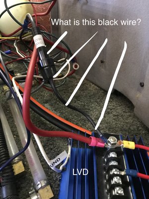

Help!
While removing the Low Voltage Disconnect I was able to account for all of the wiring except one — a black wire coming off the V IN terminal and heading up the driver side pillar. It has an inline 7.5 Amp fuse.
After checking the Sure Power manual and the Chinook manual's "Electrical System Diagram", I'm stumped. Any ideas where the termination of this wire might be?
Ross
2003 Chinook Concourse

Between the 2001 Premier,I have,and 2003..the chinook construction changed....that said I will relate what occurred when I installed my Solar....specifically the drilling of the floor by the lvd to accommodate the large gauge wire I ran.Though I did not document this,my recollection is that the floor was several layers of particle board,easily a couple inches thick perhaps a tad more.I used a paddle bit,not a forstner and even though I placed the hole to avoid hitting the loom of wires I did snag a single red wire outside the loom.The reason I address this is,to alert you to the thickness of the floor,(which may be entirely different in your year)but also what I discovered after repairing the break in the red wire I snagged.it ran independently to the positive battery terminal where it terminated with an inline fuse (case empty)it was in fact a wire for the solar panel my premier never came with.When I checked the wiring diagram in the manual for my year this was confirmed.Though I have no idea as to your black wire,it does strike me as a fairly out of the way place to access a fuse,should it fail.If you have the manual that came with your rig you might check the 12 volt electrical diagram provided,for a wire with an inline fuse. Rooney.
On my 2002 Concourse that is the "hot" wire from the solar panel. If you upgrade to an additional panel be sure to also upgrade the fuse from 7.5A. I now use a 20A for safety after blowing the original fuse and running my house batteries down, assuming incorrectly they were being maintained by the solar panels.

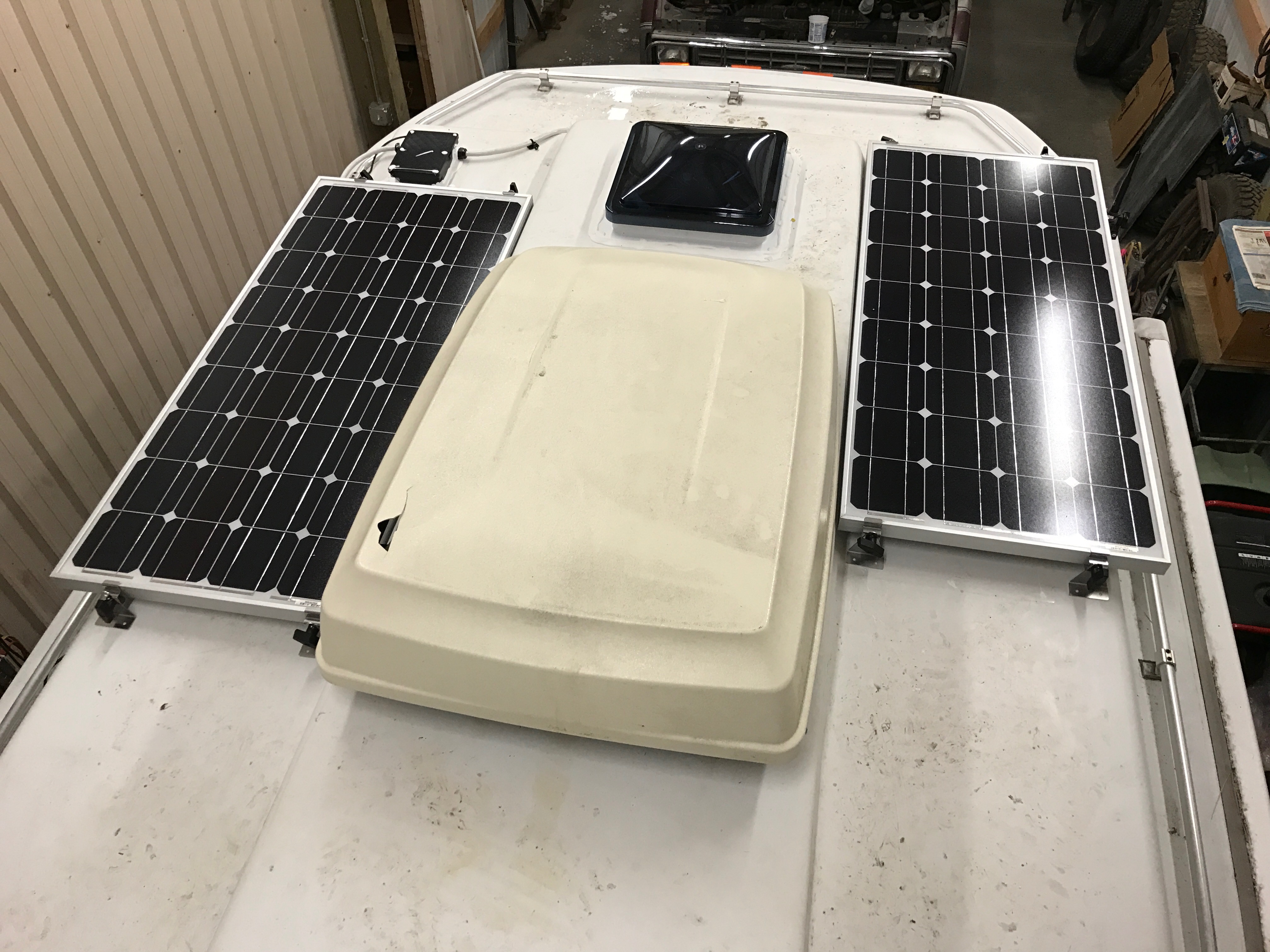

- Installed the two solar panels and wired each with 10 AWG to the combiner box, and attached the duplex 6/2 wire that goes down to the controller.

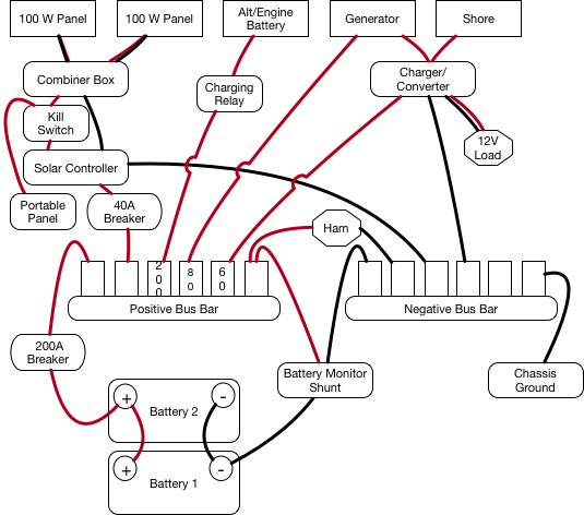

The attached schematic was developed to help me organize my thinking a bit. It's certainly not all inclusive.

I see you eliminated the lvd,and installed a shunt and legitimate battery monitor,which makes sense to me. I find myself regularly checking my battery state,and with 200watts plus (50 watts more than I)I would not expect you would ever get near 50% battery.Unless you are tempted to actually expand your off shore power electrical interests,and install a serious inverter to explore and exploit your expanded capacities.The override battery connection aspect of the Lvd,is not some critical feature,power jumping packs are fairly small and convienient to use.With my limited electrical understanding,I confess I have never completely understood the protection designs of the 50 amp automatic resetting breaker I gather you removed? Between the vehicle and coach.Perhaps you or another member could explain the possible events this breaker was designed to provide insurance against.Trailwagons surely installed it for some purpose,if no more than meeting the requirements of rv electrical association approval.Rooney
