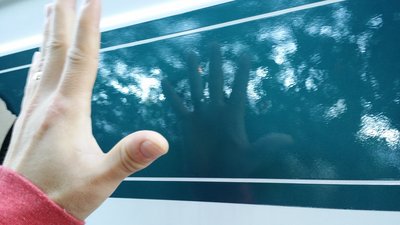

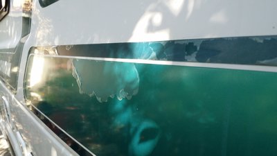

here's some more pics so you can get a better idea.
Some say I can so called "wetsand" to get it down to mirror finish but its plenty gloss for me compared to the original untouched sections so im gonna keep it as is.
I'm very satisfied with the results considering its cost, convenience and and results.
* pic 1 and 3 are before pics...2 is a close up after.
Enjoy!

and some more..
note that there are two different color tones.
pics 1 and 3 are lighter color section with windex bottle 5" from the surface...pic 2 is my hand also 5" from the surface. All pics in this post are of the surface completely dry and hardened. If you look carefully you can see the original delamination section and a bare able amount of orange peel effect.
