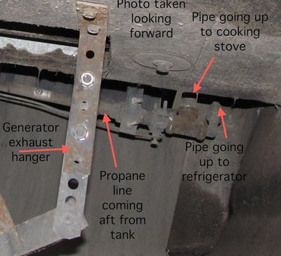

That's interesting (emboldening mine), because my Concourse has one feed that leads back to both the stove and the refrigerator. This feed has two lines coming off just beneath the floor (under the stove, near the outer wall); one goes to the stove, and the other goes (went) to the fridge. The lines that come off are the same copper lines that come up through the floor behind the "false" back to the stove compartment (mine was behind the propane oven). The refrigerator line then turns (inside) and goes aft into the refrigerator compartment. The joints where the one feed turns into the two lines are thus outside. But, coming from the tank it's just one line, until you get to right under the stove area.HoosierB wrote: During my remodel of the galley, the RV service center removed the fridge LPG feed ( I'll be using an AC/DC refer) at the tank and added a quick-release fitting there.
Here is a photo I took for something else (hence not that great) that shows it. I'm more-or-less under the generator, looking forward as I take the photo.
