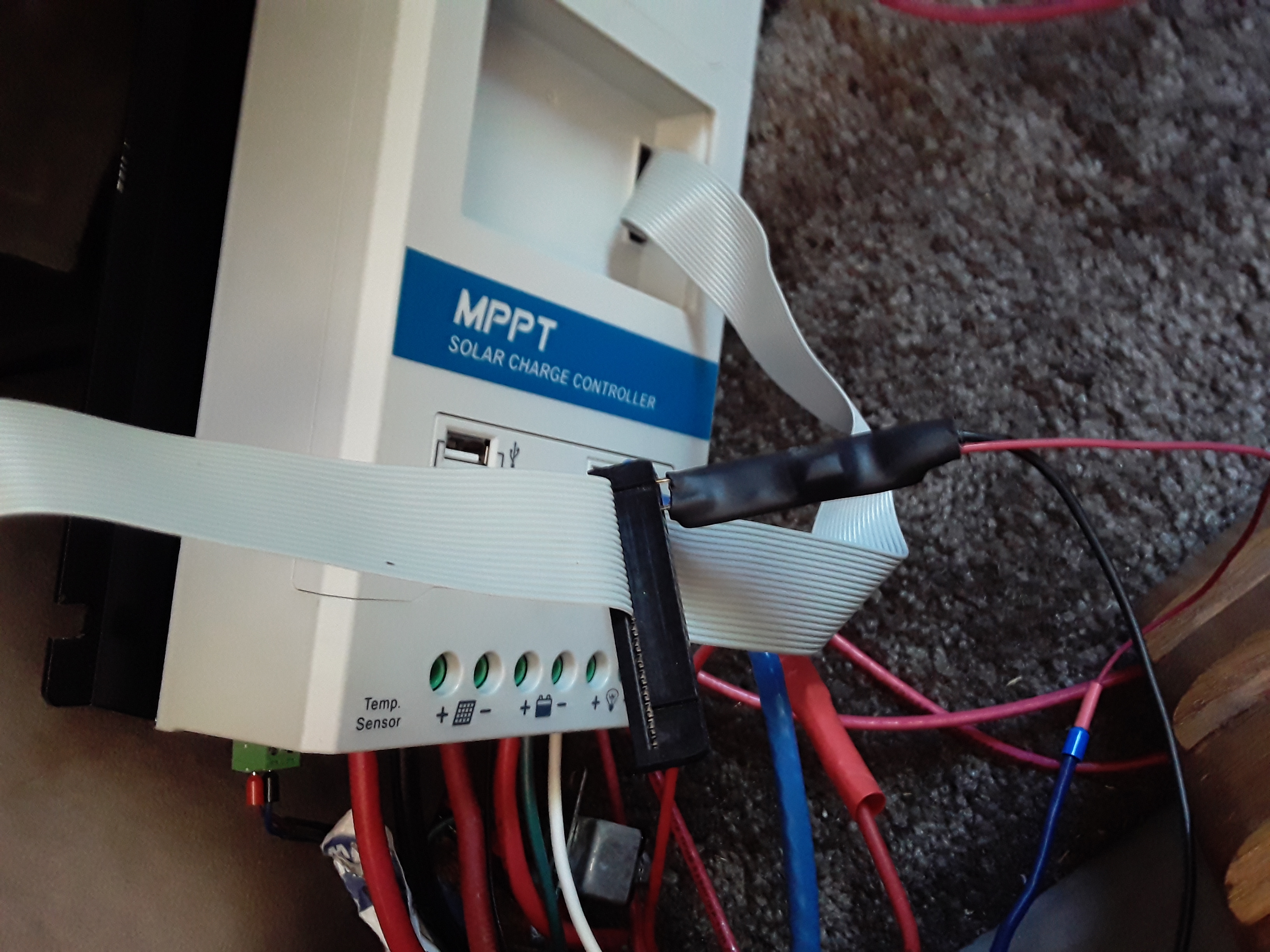

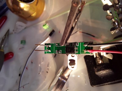

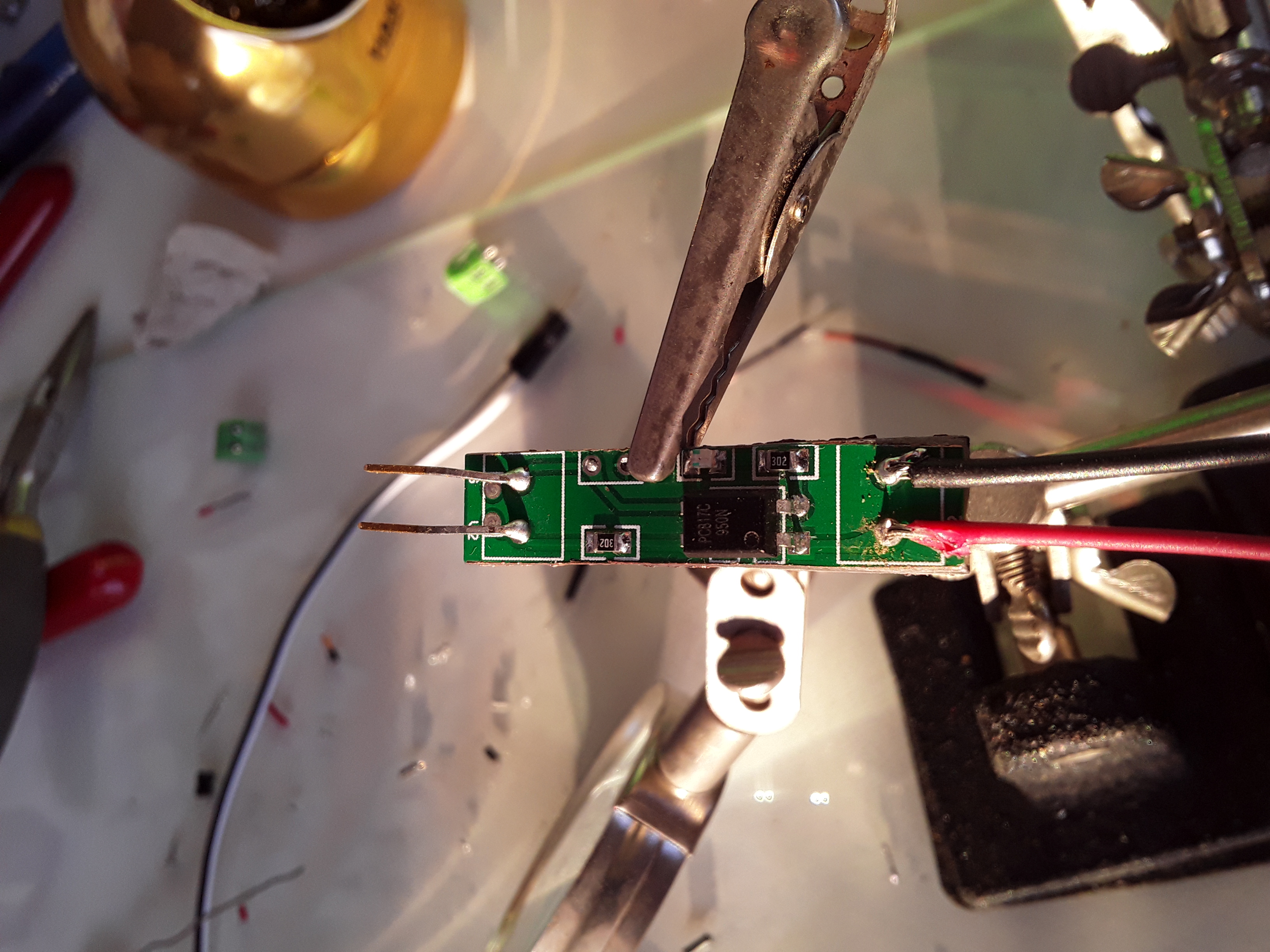

I want to preserve as much of the Chinook control as possible, so I connect the green wire from the LVD to the load output. When the load is active, the green "in-use" LED will light up. I also repurpose the blue wire to allow me to toggle the load on the controller on/off. This involved some reverse engineering, and I found out that I can ground the pin #3 on the controller to toggle the load. Since the voltage on the controller is 5V, I want to be more careful and decided to use a PC-817 optocoupler to isolate from the 12V DC from the rig. I think it can be done simpler with just one transistor, but I have the optocoupler around anyway. Since I need to tap into the controller, I used an old harddrive cable and adapter and mount the DS-2 display further up so it actually have two remote displays right now. In order for the blue wire to work, I connected the red wire from the battery (via the 15A breaker) to the red wire going to the vehicle battery switch above the driver seat.

817 optocoupler
817 optocoupler
installed optocoupler that taps into pins #1 and #3 of the controller.  The ribbon connects the DS-2 to the controller.
