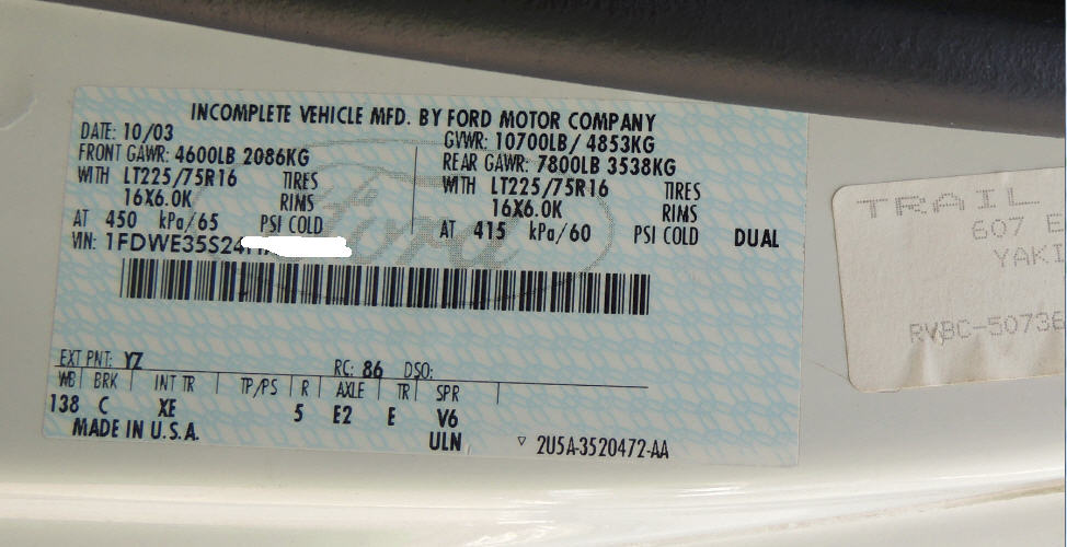

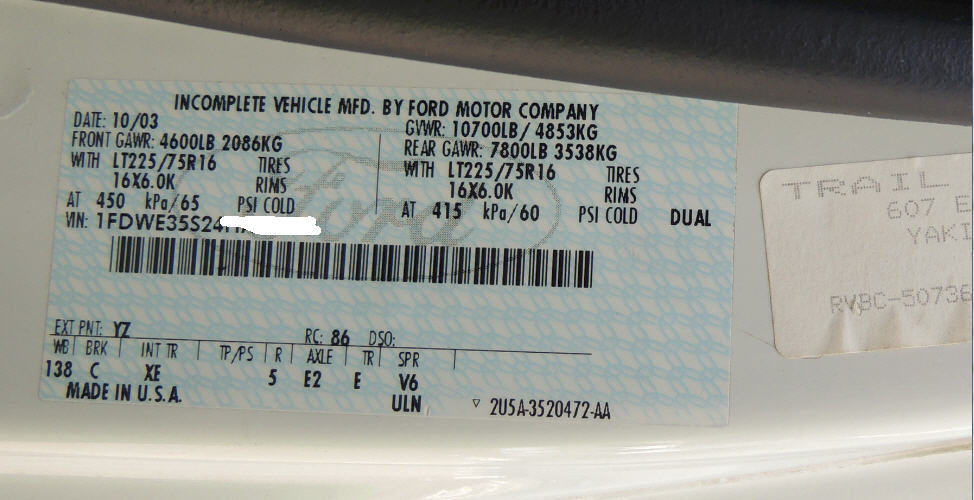

I'll add that there is some drivetrain information of the drivers door jamb sticker.
Date: 10/03
GVWR = 10,700lb
Front GAWR = 4600lb
Rear GAWR = 7800lb Dana 70, 10.5”, 4-pinion Power-Lok
EXT PNT = YZ Oxford White Clearcoat
RC = 86
Wheelbase = 138 inches 11.5’, this WB was for both Reg & Extd vans
BRK = C
Int TR = XE
R = 5
AXLE = E2 Power-Lok limited slip differential, 4.10 gear ratio
TR = E transmission, Automatic E40D (this is a 4R100)
SPR = V6 Front = V — 5310 spring (Econoline), Rear = 6 — 5560 spring (Econoline)

Re: E-350 Transmissions (specifically, E4OD and 4R100)
Yes, and the transmission code is included in that sticker. BUT the problem (in this case) is that the E4OD and the 4R100 transmissions have the same letter code (which is "E"). So you can't tell from that which one you have. Evidently Ford considered these two to be the "same" transmission, letter-code-wise, because the 4R100 was an evolution of the E4OD. Hence the need to identify some other way (tag on side of transmission) if you want to know which one you have (I needed to know for my beefing-up work, plus just wanted to know). Especially if you are anywhere near the transition years ('98 or so).
