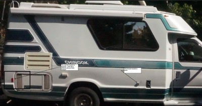

My wife and I are about to travel to Napa Valley here in California and are staying at an RV Park there. We have been informed that there is no shade available, so I went out to inspect and try to deploy our awning and to my surprise - the leg-to-body bracket on the rear side is missing! It appears that a reflector was placed there instead of the bracket when the RV was built, or possibly the original owner put the reflector there to cover up the holes. I have located a similar bracket that Blue~Go bought to replace his, but the bracket won't arrive in time for our trip. So, it means deploy the awning with the legs straight up at the end of the awning onto the concrete.
Any one know what issues I might have trying to deploy it? I have a feeling that it hasn't been deployed by previous owners, and I am afraid that if I deploy it before we go on the trip, I won't get it back in place...

Flip a coin i guess. I would rather deploy it at home to see what shape its in than wait until im far away from home and find out i cant get it retracted again or some other issue.
Re: Awning inspected
My thoughts as well. If I have a problem and cannot retract it back - off it goes. I will try it out tomorrow. I am also thinking of removing the strange placement of the reflector. I bet there are two holes on the body underneath...

Pretty smart/sneaky thing to do by the reflector there!
I would definitely deploy it and see if you can retract it and look to make sure it is sound mechanically. You maybe able to mount the leg onto the reflector, or put a metal clamp there in place of the reflector temporary, or you can try to extend the legs to the ground instead of onto the bracket. It is more work to put it on the ground, but I am sure you can figure some DIY holder with a chair/rock and tie it to the rear leg. Just make sure it is not too windy, and you should be fine.

I removed the reflector and scrapped a little of the adhesive away and viola, there's two holes there. I now suspect the RV Dealer did it. And it was certainly cheeky of them. I never noticed it out of place until I tried to locate the bracket.
I was able to deploy the awning and set it up with the legs extended to the ground. I went ahead and ordered the replacement Viamma parts and it turns out they will get here in time. The awning looks ok and I was able to retract it. I lubed the joints with a little WD40 and will try out deploying and retracting a couple of more times before we head to Napa Valley.

Glad to know that you were able to deploy it on the ground as well as getting the part you needed before you heading out.
However, I would avoid the WD40, and would go for more appropriate lub. I would call the Viamma folks and see what they recommend. WD40 tends to gum up and attract dirt, and not my first choice for things that going to be used outside.
