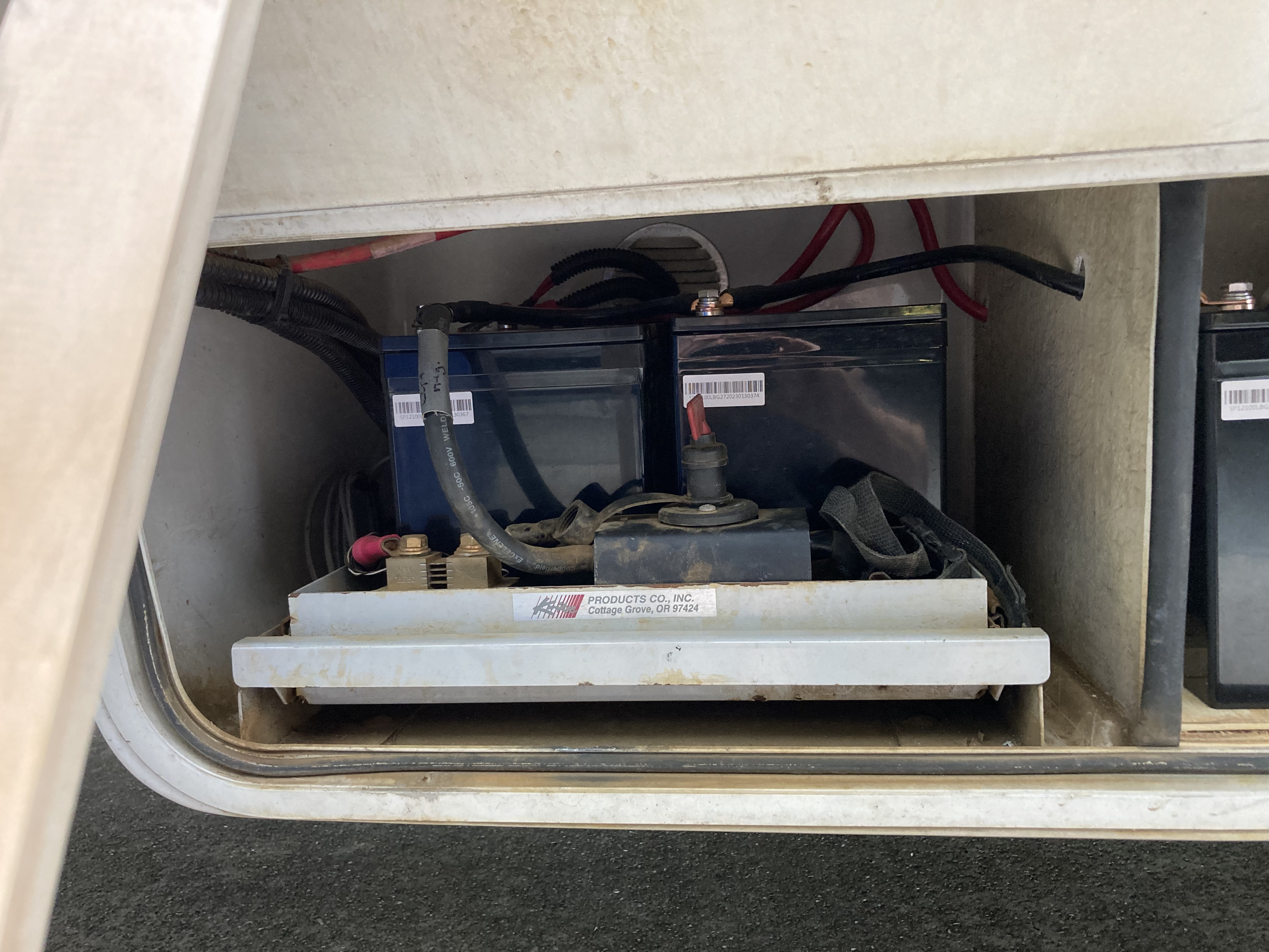

Scott, thanks for advice, and yes I spend nights in RV and days fishing. Rarely spend much time relaxing in Chinook except at night but I really love the lounge layout. I have wondered about making my own cables and heard a hydraulic crimper makes light work of bigger cables. For wire do I just used thin strand welder wire?
Battery switch over went well except since I was going to parallel from series my positive battery terminal bolt was not long enough for the extra cable. Local HW store was out of my size so I split the positive connections between the first and second positive battery connections. Not sure if this is best practice but I'll put all on one terminal when I get bigger bolt.
I had to drill holes in the compartment divider to get the wires to the 3rd battery. I definitely have room for a 4th battery but as you mention I probably don't need it since I am weekend warrior but they are on sale for $251 off so very tempting.
Also, these batteries are only 27 lbs compared to my 6volt at 72. My two old batteries were 144 lbs for 100ah, my 3 lithium are total 81 lbs (300ah) , and even if I add a forth (400ah) my weight is only 108 lbs which is still 36 lbs less than 6V. Working on the batteries at only 27lbs is much easier.
The other issue I have is trying to increase volts on my converter, I think I did it right but I never get a reading beyond what batteries SOC is.
Also my DC/DC charger will be here tomorrow so I will install then and definitely need to find or make cables.
Sorry no pics but for some reason I cannot add them to post????

Here are pics of new battery bank.

Anyway, you may want to describe or take picture of your cable setup, since the connection you said above sounds not quite right... We want you to get a good night sleep instead of worry about if the battery going to melt the wire and made you stranded at your camp.

The thing in Camaro's second picture is a shunt (in front of the left battery). It's a precision resistor that diverts a tiny percentage of current. That diverted current is measured for voltage delta against system voltage to estimate how much current is going though the main circuit. In a bidirectional application, the amount of power going into - or out of - the battery can be quantified, thereby providing a SOC based upon the bank's capacity. This value can then be displayed passively as a percentage.
Re: AGM to Lithium, do I need to change Isolator or upgrade alternator?
I think the shunt in Camaro rig is for his current meter (ammeter, which is actually a voltmeter that measure the voltage drop across the shunt). Some sophisticated digital meter does count the electrons via the ammeter, and use that to calculate the SOC, but all analog (and most digital) SOC meter is just use the voltage as an indicator of the SOC.
