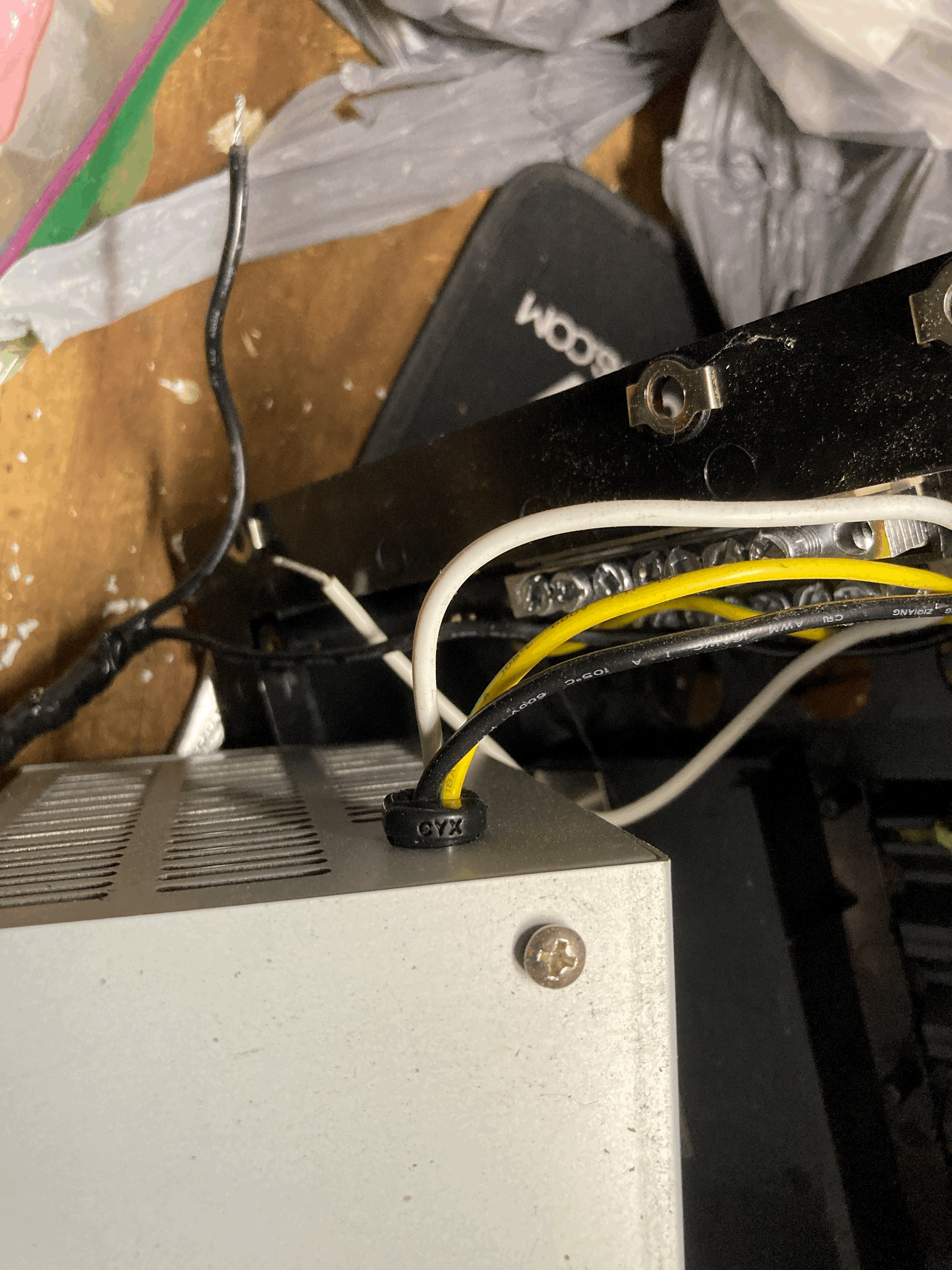

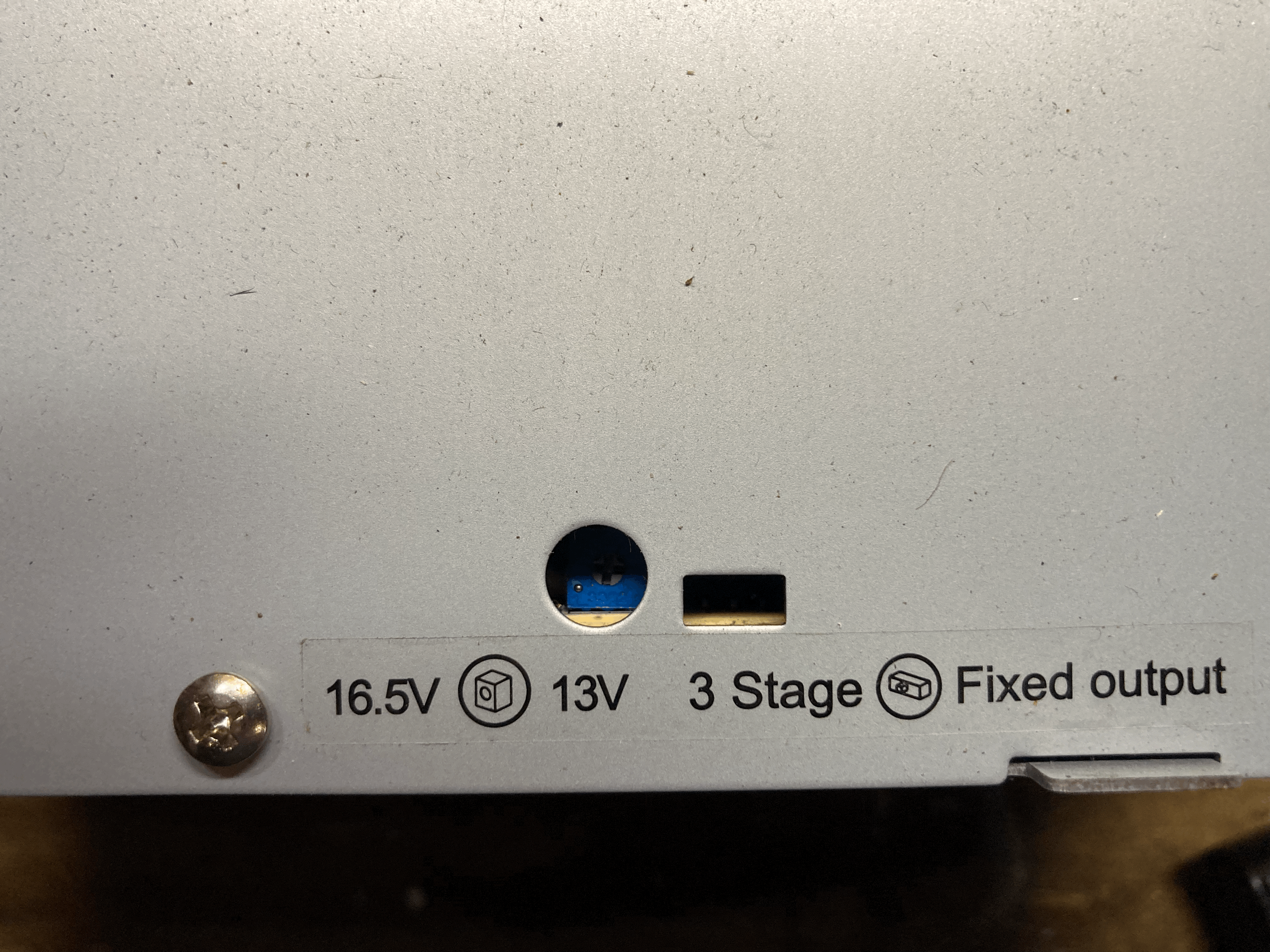

I am switching my batteries from AGM to Lithium and they will arrive tomorrow. My power center is set up for 12v AGM, voltage is set up to 12.7 or 13v. For lithium I need to increase voltage to 14.6v or the 16v listed on power center.
Using picture below, I do this in 2 to stages:
1. Move switch on the box from "3 stage" to "Fixed Output"; and
2. Turn the screw from 13v to 16.5v, while reading voltage to make sure I increase to correct voltage.
So my question is how do I read the voltage on the power center? Do I simply put the meter prongs where the white and black wires connect from silver box to fuse box? I assume I need batteries installed to get the power flowing, and do I raise to the 16.5v as printed on box or to 14.6 which is usually the 100% charge for lithium?

How to take voltage reading at Power Center under sink area

Can you provide the make and model of the charger? It is not the usual one that I see around here.
With the fact that I am completely foreign to your hardware, here is what I going to say: Yes, you can put the voltmeter on the output of the charger to check the voltage. I don't think you want to connect the battery, since it will drop the voltage to whatever the battery is at when it is charging up. I strongly suggest that you look at the manual of the charger to see if there is any instruction on the voltage adjustment for the output.

Thanks chin_k, I have the Boonedocker 3-Stage 45 amp power center (BD1245PC), it is direct replacement to original. The directions are sparse and do not tell you where or how to take voltage reading.
If I take out and do test on workbench, I get no reading from +/- wires. I wonder if I need to reinstall to get reading?

The 16.5V is the max, with 13 being the minumum. Set at the voltage specified by the batteries - for lithium that is usually 14.4 or 14.6.
Do NOT go to 16v, that is too high for any lithium pack that is nominally rated as 12V. My batteries specify the internal BMS will shut down if you tried to go past 14.8V.
The batteries will need to be connected in order to measure the voltage setting, and yes just put the leads on the plus and minus for either the charger, or on the batteries themselves. Make sure to start with the voltage dialed down to 13, then increase by turning the screw driver clockwise (looks like you’ll need a real small one for that). You’ll want to do this when you know the batteries are less than full.

Some charger will not output power unless it is detecting reasonable voltage and polarity (that is, from the battery) on the output. Maybe you measured zero is because of this safety mechanism?

Thanks, I am using Lifeline and and the recommend charge voltage is just as you say.BobW9 wrote: August 5th, 2023, 9:21 pm The 16.5V is the max, with 13 being the minumum. Set at the voltage specified by the batteries - for lithium that is usually 14.4 or 14.6.
Lifeline say their BMS shuts down at 15.4v.BobW9 wrote: August 5th, 2023, 9:21 pm Do NOT go to 16v, that is too high for any lithium pack that is nominally rated as 12V. My batteries specify the internal BMS will shut down if you tried to go past 14.8V.
Big thanks. I guess my worry is I need to take out power center mainboard leaving wires intact while its connect to battery to turn the screw since it is on side of main power box in my first pic.BobW9 wrote: August 5th, 2023, 9:21 pm The batteries will need to be connected in order to measure the voltage setting, and yes just put the leads on the plus and minus for either the charger, or on the batteries themselves. Make sure to start with the voltage dialed down to 13, then increase by turning the screw driver clockwise (looks like you’ll need a real small one for that). You’ll want to do this when you know the batteries are less than full.

Thanks, the manual you attached was almost word for word identical to mine. The video I posted in previous post here said you do need to attach power source to get reading, I could not get reading myself on bench without power but I will try again later this week.chin_k wrote: August 6th, 2023, 4:33 pm According to this, here is the re-branded version for the charger: https://powermaxconverters.com/wp-conte ... l-2018.pdf

Also, note that setting dial should be linear, so if you see exactly how far around it goes from left to right, you should be able to guess about where it should be for 14.4/14.6. I.e. 13 - 16.5 is 3.5. 14.6 is 1.6 from 13 and 1.9 from 16.5. So the dial should be just under half way around to its max.
