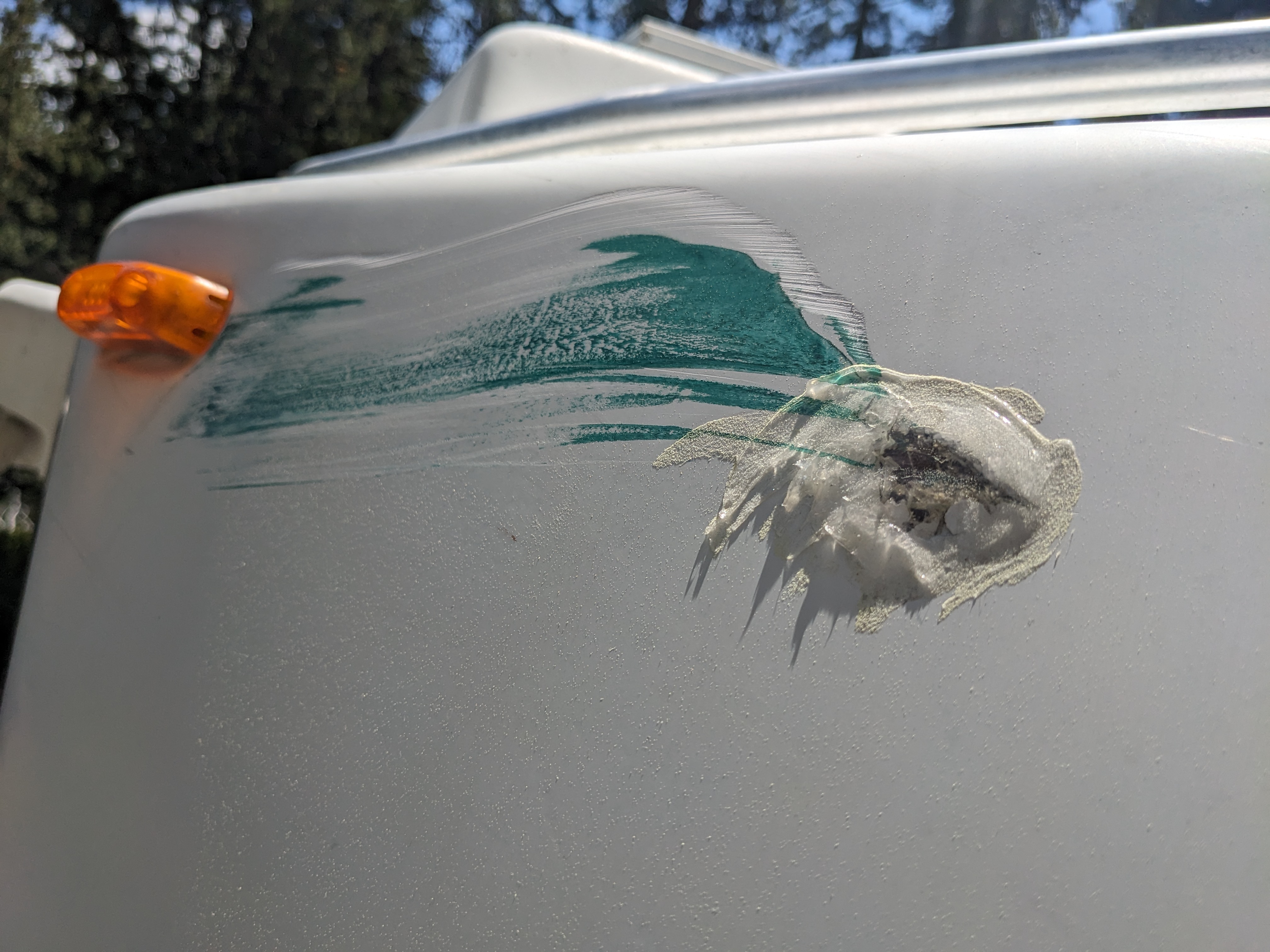

Gouge in fiberglass shell
There's pretty substantial gouge in the shell. He clearly hit something. I'm not sure how wide spread the delamination goes in the composite shell but assuming I'll have to have someone cut that out and patch it up.

I'll attached pictures of the fiberglass damage here as well as some leaking from the oil pan.

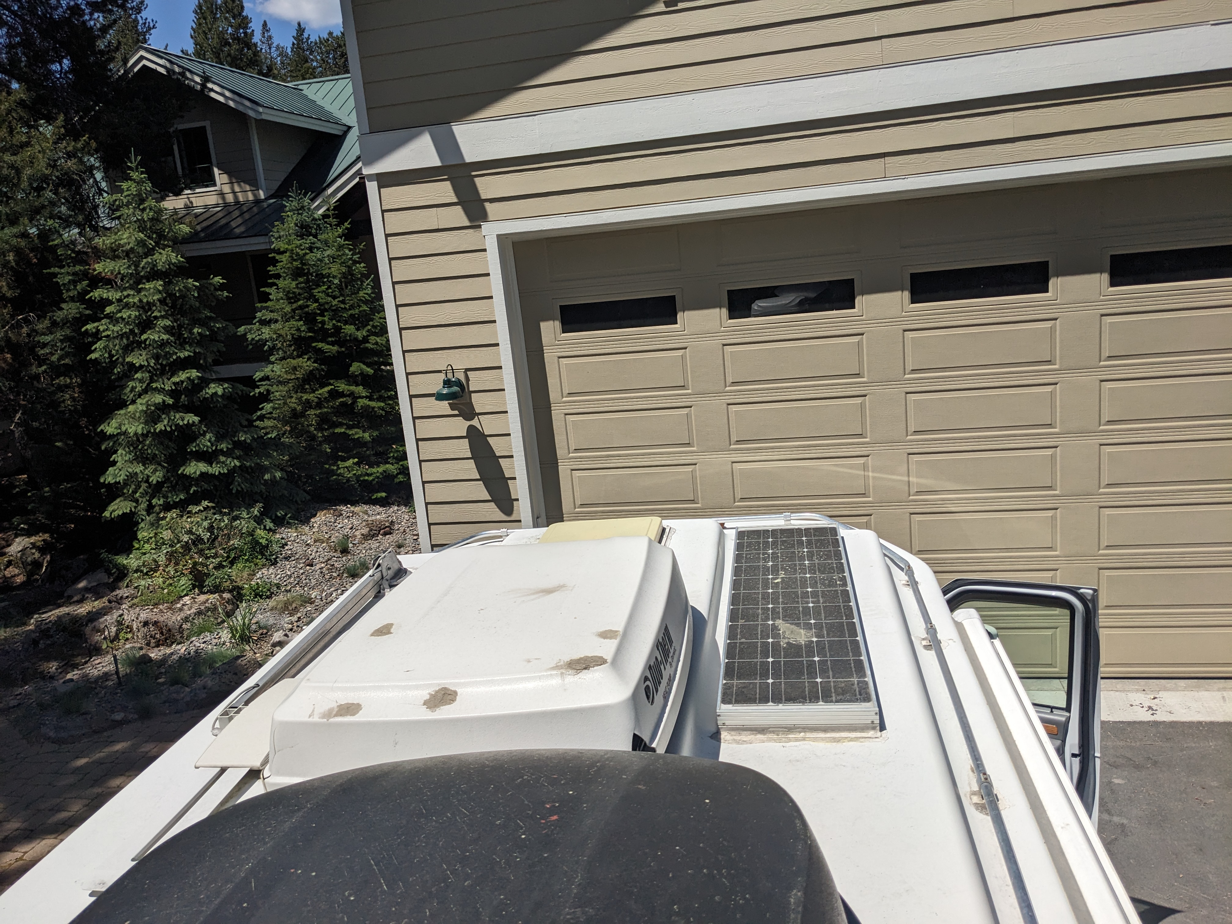

I've called around a bit and got very loose estimates for engine work and fiberglass repairs. I'm thinking this should be selling for closer to $25k... I don't know tho... Any chance you have an opinion on the price reduction? Also noted that the AC unit is cracked, look slike he hit something up top as well. This scares me because I'm hoping he didn't cause delamination up there as well.

roof pic

Fiberglass can be repaired to look a lot nicer than what is shown. I wouldn't be too concerned as long as it's water tight. That particular spot faces a lot of wind and wind-driven water while driving, so it's important to have it especially robust. At least it's not hiding.
