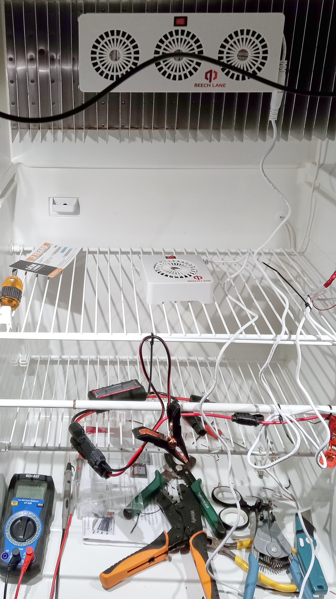

I recently embarked on another mission to enhance the performance of my Dometic RM3663 3-Way refrigerator by installing internal fans. After conducting thorough research I stumbling upon recommendations from fellow RVers, I decided to give it a shot and purchased a couple of internal fans to see if they would improve the cooling efficiency of my fridge. Today, I completed the installation and eagerly await tomorrow's test to gauge the impact.
The installation process itself was fairly straightforward, thanks to the accompanying images and instructions provided by the manufacturer. The fans were designed specifically for absorption refrigerators, and their compact size fit perfectly within the unit. The materials used felt durable, ensuring they would withstand the demands of the RV lifestyle.
The true test, however, lies in the performance. The internal fans are intended to circulate air within the refrigerator, aiding in temperature regulation and ensuring a more even distribution of cold air. If my initial observations are any indication, these fans should make a noticeable difference. In terms of potential future modifications, I am contemplating installing an external fan at the back of the refrigerator. This addition could potentially provide an extra boost to the cooling process and further enhance the overall performance.

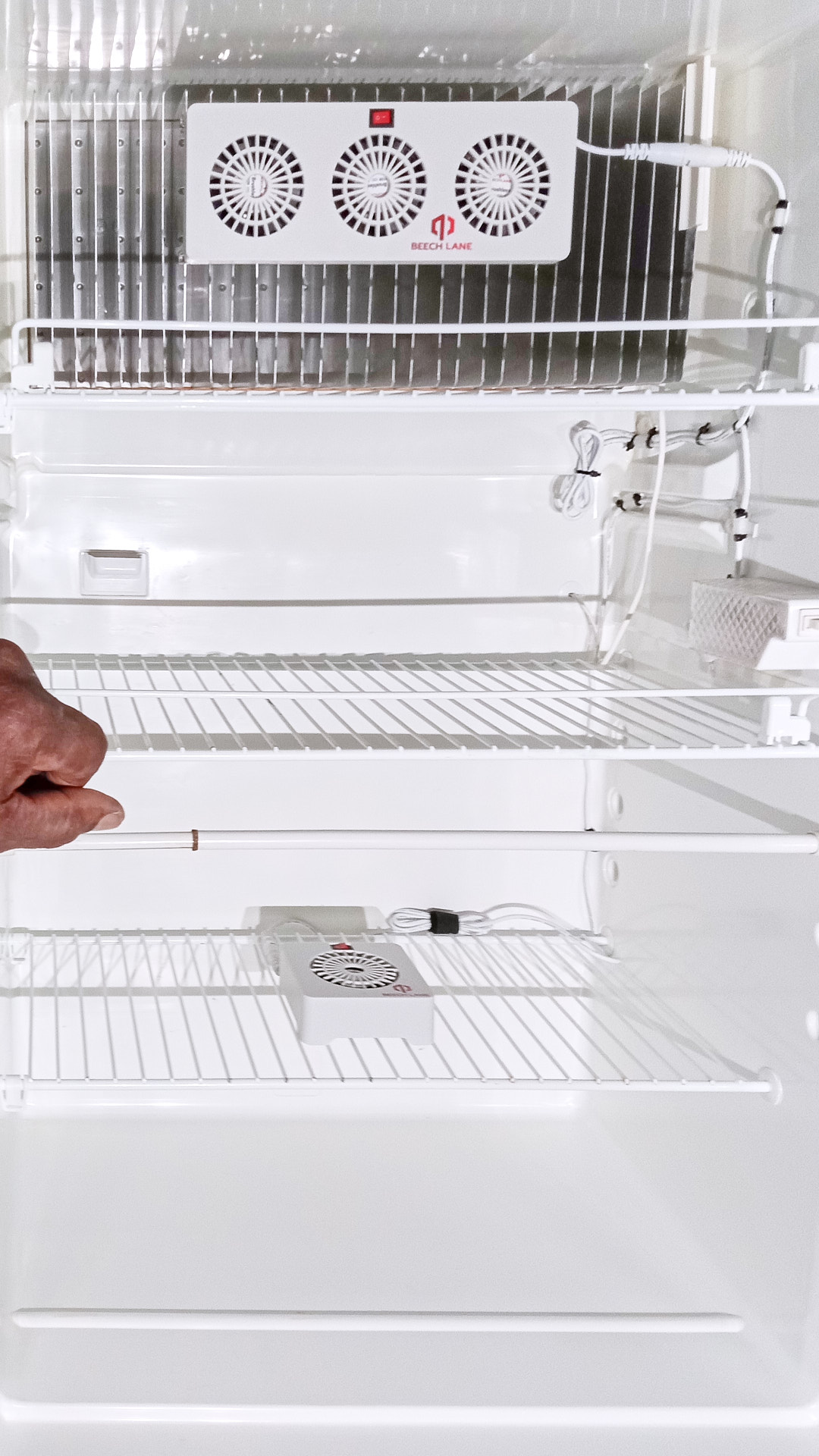

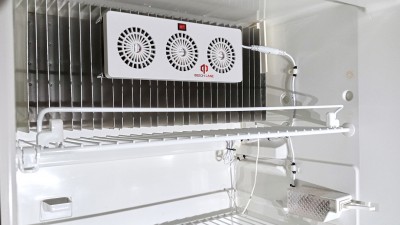

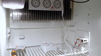

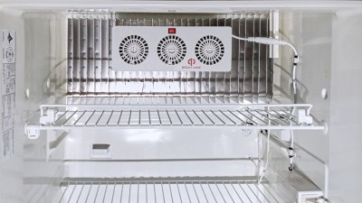

Here are some additional images of the installation that was completed.
Regards!
