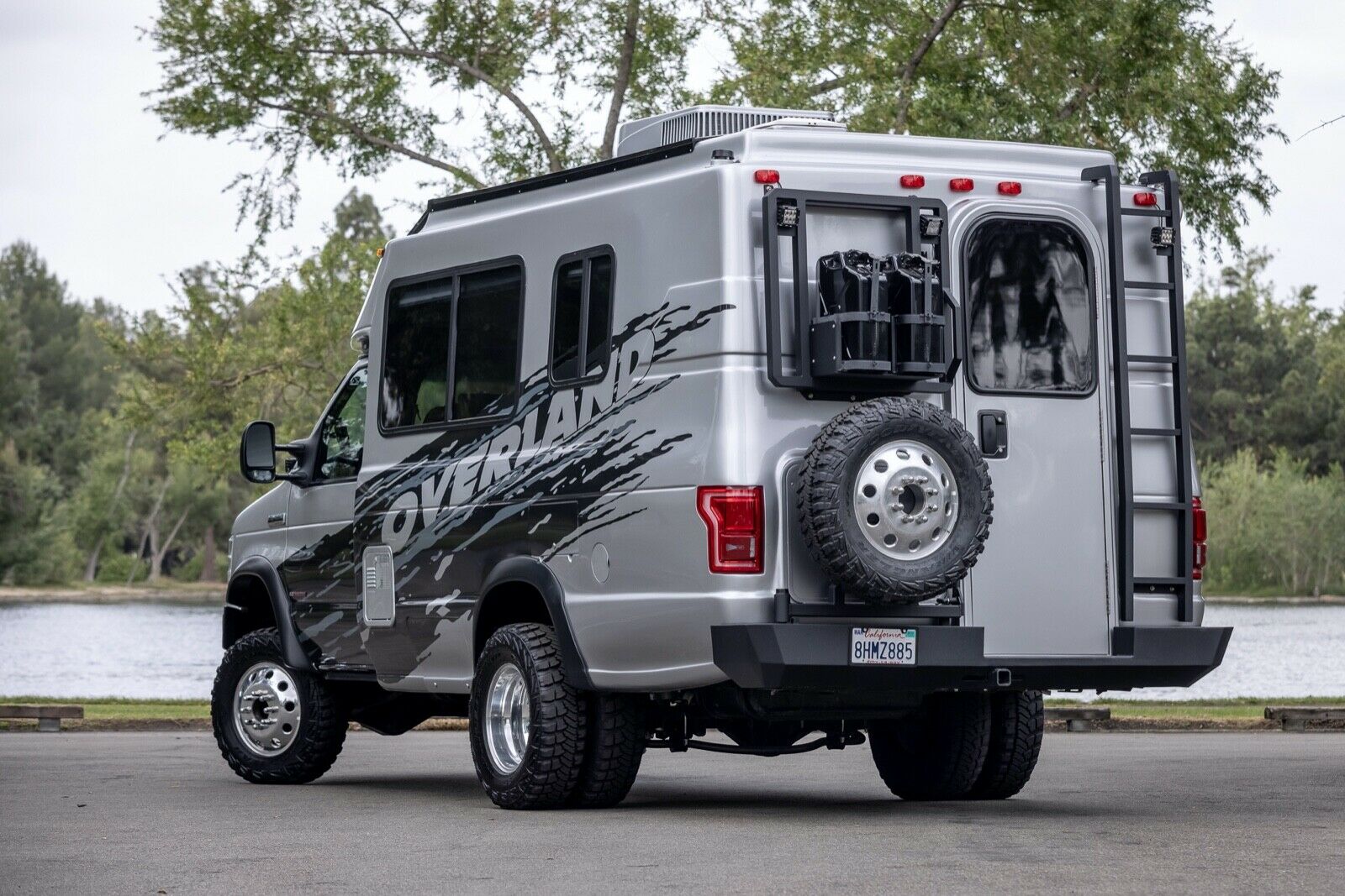

Just some random examples of what i am talking about. This is not the look i am after in regards to where my back tires should be located in relation to the fenders.....However everyone has different likes and dislikes.

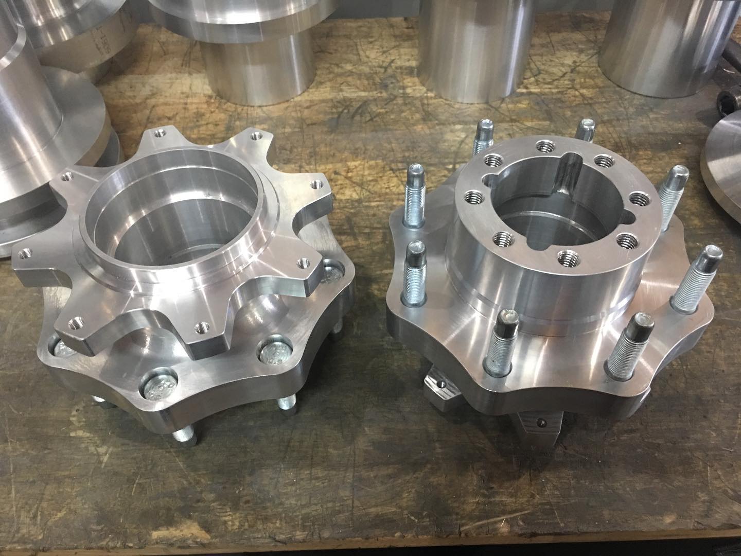

To answer your question about the hubs... I only ordered one pair so they are $1500 for the pair. Primarily because a CNC file has to be created and programmed into the machine so that the CNC machine knows what its supposed to do. If i order another pair they will be cheaper because the CNC file already exists. No doubt i will eventually order a second pair as spares down the line but initially i have no need for more than one pair at this point.

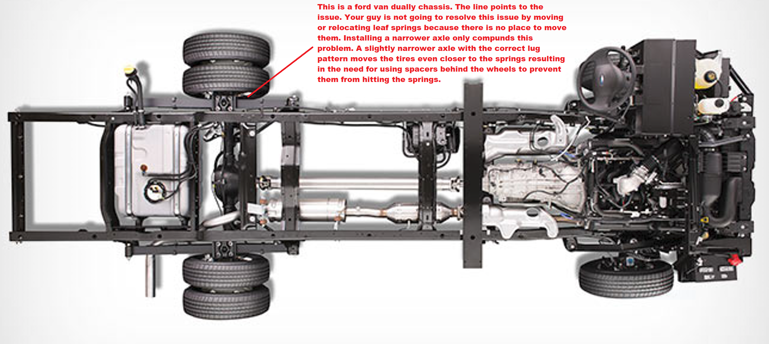

Have you looked at this AJ's instagram page? Almost every single dually truck that he has done are using standard offset front wheels which can not be used on the rear dually axle even if they were the same lug pattern on all four corners. That means the customer has to have two spare tires.
Installing the F350 rear axle will solve the lug pattern issue however it compounds the leaf spring clearance issue simply because the F350 dually axle is slightly narrower than the van axle. Moving and rewelding spring perches and shock mounts does not solve this issue. So even though you can put the F350 axle under the chinook it is equivalent to robbing peter to pay paul. I say that because the point of installing the F350 rear axle is to eliminate the need for using wheel adapters on the rear, which swapping the axle would do. However what it causes is a need to run spacers behind the wheels to push them outwards away form the leaf springs because the F350 dually rear axle is slightly narrower than the van dually axle.
The reason your guy is doing things this way is because he is fully aware that there is NO off the shelf dually wheel solution to the rear axle clearance dilema other than to leave it in stock form and run two spare tires/wheels or use adapters and or swap the rear axle and use spacers behind the wheels. You will also notice that there is a video of a chinook that he did for a customer... his work around... build a custom rear bumper with a spare tire swingarm and then hang two heavy spare tires on one swingarm..... People dont do rediculous things like this if there is a simple solution available to a problem.
Based on what i see on his instagram, his preference is to leave the rear axle alone and run two spare tires. Theres nothing wrong with that, it just isnt an optimal solution to the problem. There are several dually trucks on his instagram 99% of which are running a non-dually wheel on the front axle. There is a reason for that and i have shared that reason with you previously.... If he installs an F350 axle in the rear you will end up with spacers behind your dual wheels to move them out away from the leaf springs. If he doesnt install an F350 axle in the rear you will end up with two spares or you use adapters behind the wheels. None of which is an optimal solution to the existing problem. This is the optimal, no nonsense, simpleist solution to this problem..... In the end none of this matters, the ONLY thing that matters is that you are happy with your truck when its finished regardless how the wheel issue is handled.
