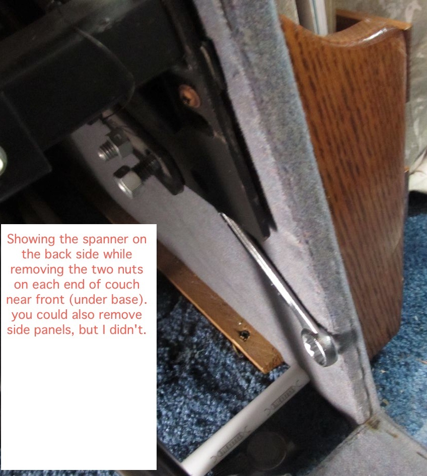

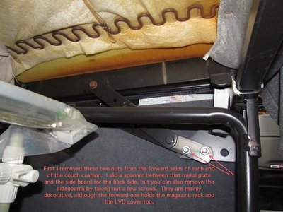

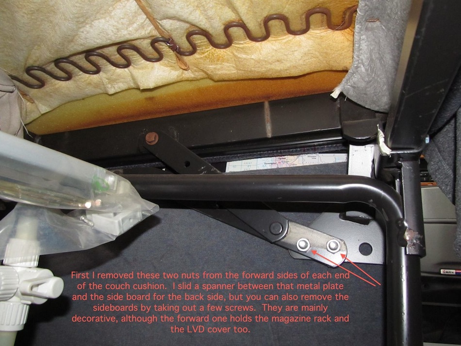

I started by detaching the seat cushion frame from the "floor frame" (which is what I'm calling the part that is an unmoving square steel "box" that is attached to the floor of the Chinook). I did this by removing two fasteners on each end of the couch. You can see them attached to triangular black steel "wings" on each end of the couch if you look in under the pull down door.

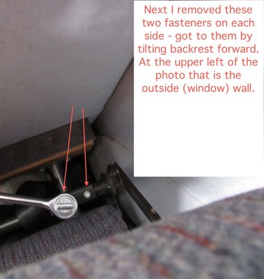

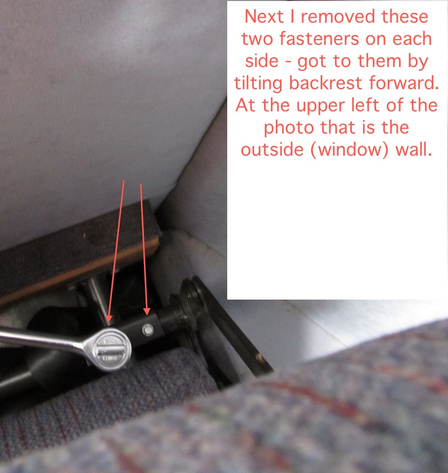

Next (going from memory/photos here - this was a year ago), I removed two pairs of fasteners that are near the outside wall, one set on each end. These are behind the back cushion and near the back (outside wall) of the seat cushion, and hold the moving frame to the fixed frame.

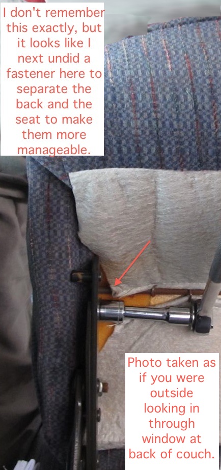

Re: Removing Sofa
Then, I detached the backrest cushion (and its internal frame) from the exposed moving part of the frame. This photo is taken as if you were outside the window looking in at the back of the backrest (the white area).

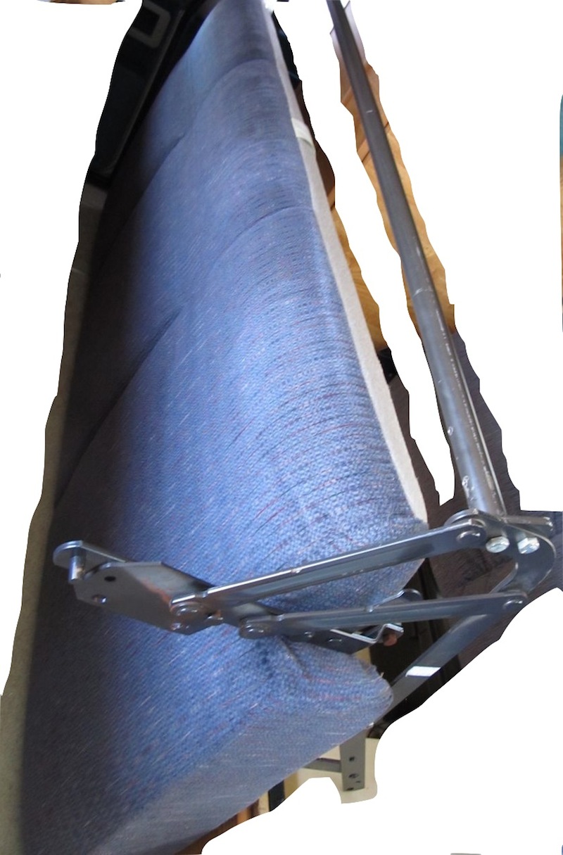

This (as I remember it) separates the back cushion and the seat cushion. So now you have the seat cushion with a bunch of movable framing attached to it. If you pull up the round rod to the top, you have a sort of giant suitcase that you can carry (seat cushion plus "handle" of framing at top). Sorry about my lack of photoediting skills - hopefully you can look past that and see the "suitcase" of the couch seat cushion after I removed it.
The backrest is another separate piece you can carry out.
What is left is the fixed "box" of couch framing that is attached to the Chinook, along with the side and front panels (the front panel "door," that is). Any of this can also be removed, but I chose to use it as the base for my new couch/bed.
