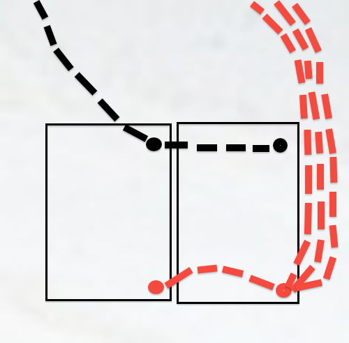

Okay, so.... I think I see a couple of misconnections on your batteries. I may be seeing things wrongly, as I'm not there, but I'll try to describe what I think I'm seeing, and then you can look in reality and let me know if it's different (and then we can go from there).
So first of all, I'm assuming (but correct if I'm wrong) that those are two 12-volt batteries, connected in parallel. (This was the original Chinook setup, unless you have gone to two 6-volt batteries in series, but I'm doubting that.)
If that's the case, you want them to be as "even" as possible. You don't want more of the draw coming from one battery, and less from the other. That would be like the person at the front of the class always being called on, while the fellow in back just doodles in his notebook. So, there is a "best" way to hook things up. What you want to do is have the negative wire going one way, and the positive going the other. Here is a drawing of good vs. not so good that shows it. There are four batteries in this drawing, but you can just picture the same thing with your two. This is for batteries in parallel (in other words, this presumes you have two 12 volt batteries supplying a 12-volt system and you are "adding them together" to make a larger 12-volt battery bank - unless you have changed Chinook's original premise, that should be what you are doing now).
Here is the correct way: Here is the not-so-good way: What I think I see on your bank is a kind of modified not-so-good way. At least, here is what I think I am seeing. Orange is positive and blue is negative.
So that doesn't look like any of the diagrams, and you have positive wires going off in two directions. I don't see how that can be good! What I think is that you should first choose which of two positive posts it would be most convenient to have all the positive wires (the ones that lead away from the batteries) come off of. Likely the right one, but it doesn't matter, so whichever one would make them "fold in" better when you move the tray in and out. Then put all the incoming/outgoing positive wires on that post. (A bus bar or power post would be tidier, but you are allowed to have up to four conductors on a post even by ABYC guidelines, so you can do it.)
Next the incoming/outgoing negative wire goes on the negative post on the OPPOSITE battery to the one you just put the positive wires on. That gives you the "better way" flow shown above.
Next you just put the jumpers between the batteries. The negative jumper goes from the negative post that has the incoming negative wires on it to the other negative post. And the positive jumper wire goes from the positive post that has all the incoming wires on it to the other positive post. Okay on to next post so I can put a fourth photo in....

Re: Coach Batteries and Storage
So then it would look something like this. If I've drawn it reasonably, it should be clear how it looks like the "better" hookup, but is using the wires you have already.
Does this make sense the way I've shown it. I know, side issue from your original question, but it's important to have them hooked up correctly.

I think I get it. Like your last diagram, it would appear that my left battery should have the neg lead attached to it (its now on the right battery). Keeping both short jumpers in place, the extra pos lead should be ganged with the other two leads on the right battery, which would give that post a total of 3 connections plus the short jumper.
Yes that's it. Although the whole kit and caboodle could also go the opposite way. To me the decision point is which side is most convenient to have that big group of positive wires coming off in. So it meshes with the tray sliding in and out. The negative being a single cable is not as much to manage. But presuming the positives are happy coming off the right side (as photographed) then yep.HoosierB wrote:I think I get it. Like your last diagram, it would appear that my left battery should have the neg lead attached to it (its now on the right battery). Keeping both short jumpers in place, the extra pos lead should be ganged with the other two leads on the right battery, which would give that post a total of 3 connections plus the short jumper.
Right now your positive wires are having an identity crisis! They don't know whether they are coming or going.
