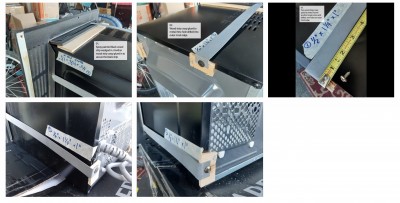

I finally installed the new Faberware microwave after almost two years. I actually learned fairly quickly that I didn’t need it and enjoyed the new storage space where it was supposed to be. I can heat up any microwaveable item using my skillet on my gas stove and it’s just as good if not better. Definitely simpler.
It didn’t quite fit the faceplate so I used wood stripping to fill in the gaps.
I’ve only tested it once. But it works and looks good.
