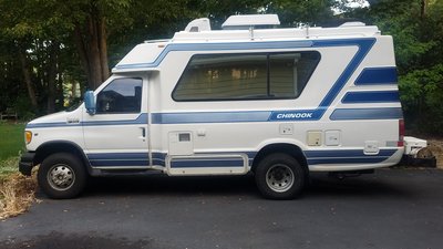

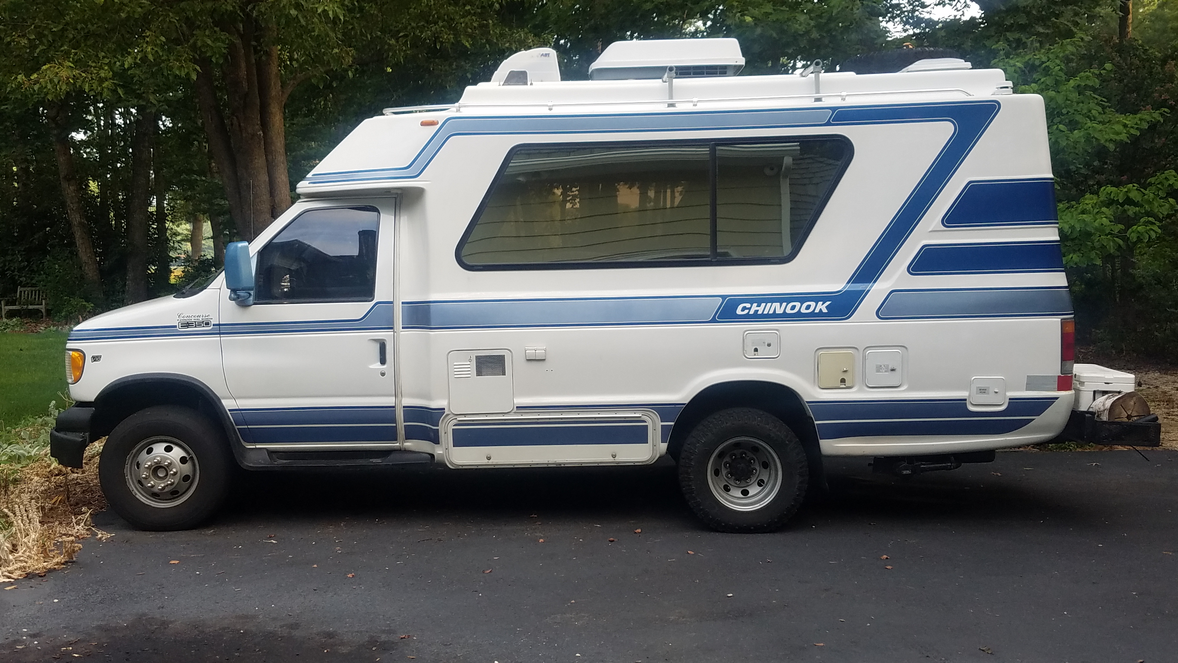

I believe I ended up just around 2" with the benefit of all new springs/shocks/hardware for under $2000.
Here is a picture of my rig with the MOOG Front and General Spring Rear leafs installed. Tires in picture are 235/85R16 front and 215/85R16 Rear. Plenty of room for 235's in rear.

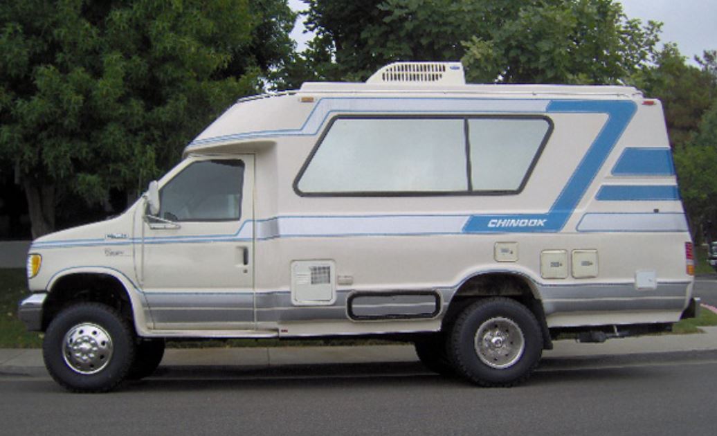

Here is a picture I found of a Chinook with the ActiveVan 4" LIft.
