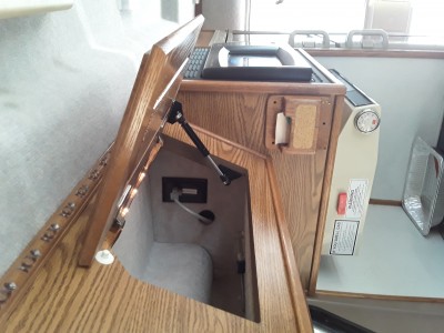

I am going to replace all mine in my 2000 as well. I have 5 smaller doors with the SPD-20's on them. But I also have 2 larger doors with SPD-30's on them AND an additional no name metallic one that I don't recognize. Perhaps they are after market ones that the PO installed on his own?
The second larger door is above the stove top, since the convection/microwave is at the bottom where the propane oven used to be in previous models.

I'm on Ebay right now and those metallic looking ones are actually "spring" loaded ones that are even shorter than the gas ones. No wonder the larger doors didn't open quite all the way! I'm taking those off and leaving them off. Hopefully the new gas ones in 20 and 30 lbs will do the trick!

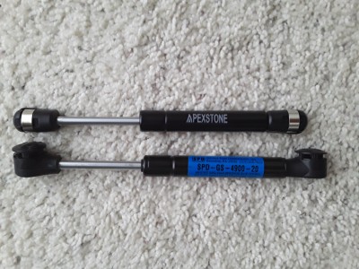

I ordered the Apexstone 80N/18lb and it seems to be working well. It is not a perfect match compare to the original, with 2 lb less force, and I think 1/2 inch shorter. However, I do not think that length is a big issue, since the doors are almost horizontal when the strut is extended. The main reason for me to consider using the 18 lb ones is for the price. You can get them off eBay or Amazon for less than $10 for a pair. I paid $8.38 (free shipping) in one of these transactions, so it is as low as $4.19 each. Installation took 10 seconds, just snap the sockets at the ends onto the original ball.

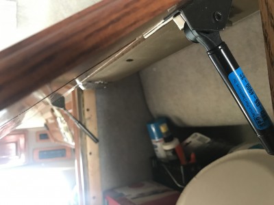

The new struts are 1/2 shorter, but with the same stoke length. I am thinking about put a standoff bolt on them to make the barrel long to match the original, but it is working alright the way it is.
The original and the shorter one I unstalled

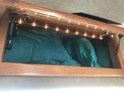

Here is what it looks like installed
