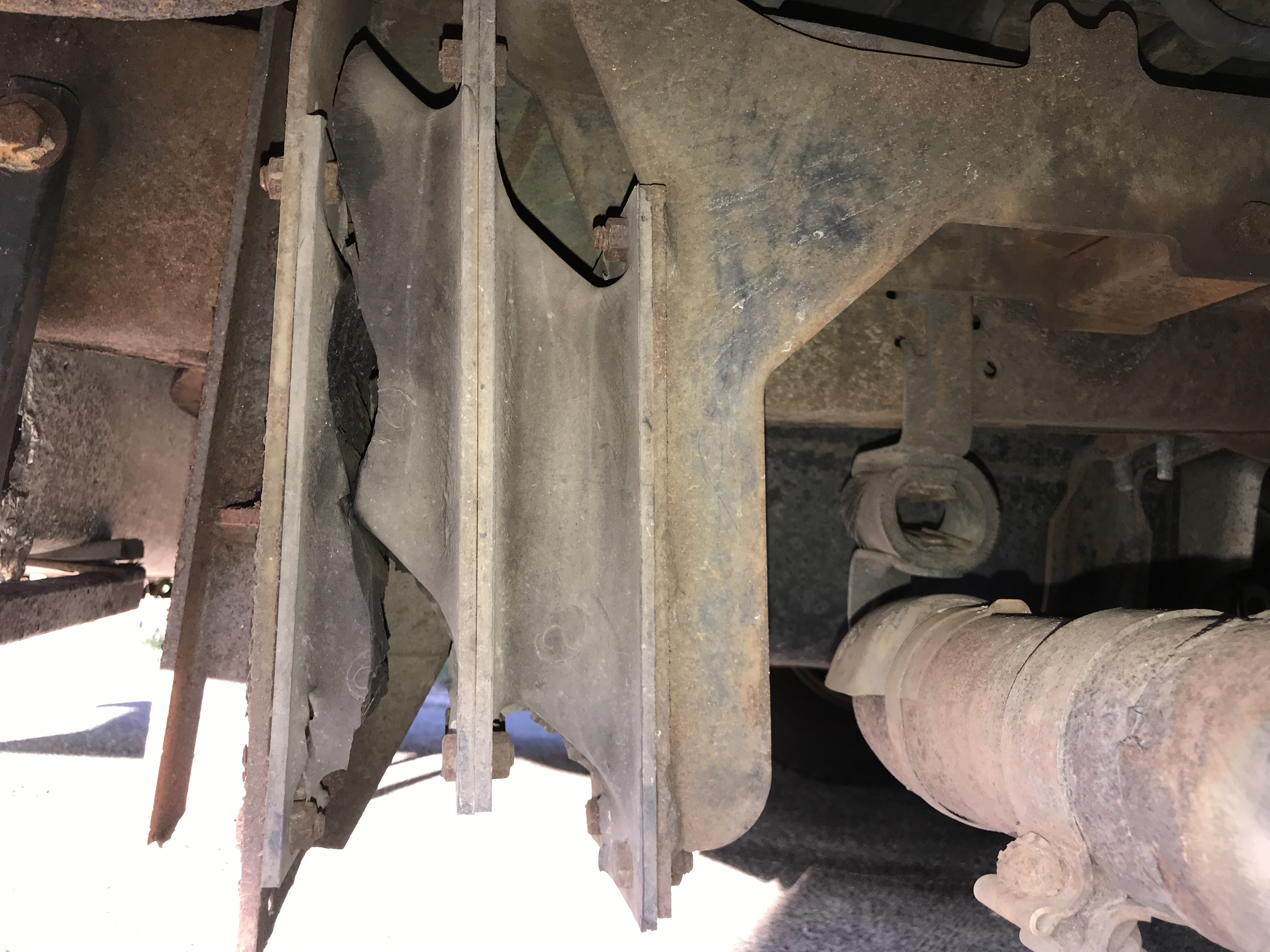

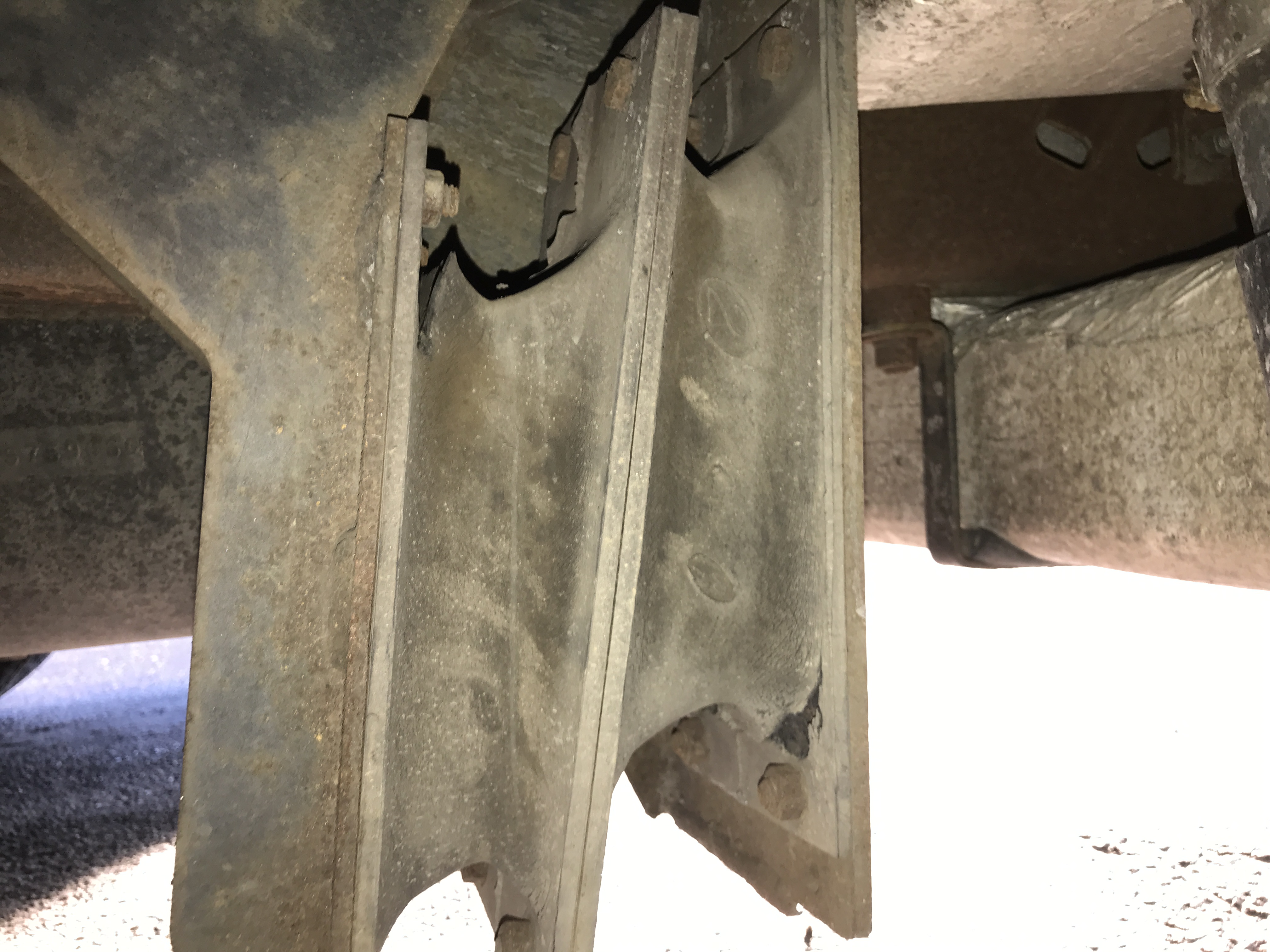

I was curious about mine so I checked and sure enough I have the MORryde system, but the right side one is completely sheared. I always noticed a slight lean to the right from the rear and now I know why. They look just like the ones in the pic Blue posted.
I see old, rusted rear shocks too. I didn't see a typical sway bar though. There's a straight bar that goes left to right between the frame in the rear but I don't think that's it.
The front has coils and a steering damper (looks like a shock absorber). But I don't see any shocks. Do you guys install them in front?
I'm a little miffed because I have asked all the people who have done work on this rig to please inspect it thoroughly for any issues. I always got a clean bill of health for the rig. I'm especially turned off by the Ford dealer who I went to twice. Les Schwab should have caught that too.
I guess to do it right, you have to do it yourself. There's an RV service center in Everett (Ryan's) who's a dealer for MORryde, and I'll be calling them next week. Any idea how much it should cost for the pair?

This is how they look.
Re: What is MorRide and how do I know if I have it?
Yeah, it is pretty specialized, so many people don't know that it is a broken rubber sheer spring. I am sure there is a shock in the front on each side. It is standard Ford E350 item that if missing, means that one of the previous owner removed it but never replaced it. Check again and make sure.... it am sure it is there.
Flame and other people had replaced t by shop, so maybe they can give you a price range. I think 69camero have a long story about his experience to tell you. I did mine, and it was a bit of work (passenger side is more difficult due to the exhaust). Do a search on the forum and you should be able to see them all.

Astrodokk wrote: April 1st, 2019, 4:45 pm There's an RV service center in Everett (Ryan's) who's a dealer for MORryde, and I'll be calling them next week. Any idea how much it should cost for the pair?
If you have a local MorRyde dealer, you are lucky. They should charge a reasonable rate for installation. It's not hard for shops that know what they are doing but it's very difficult for ones that don't, and they charge according to their struggles, as I experienced at a local tire shop. That bar connecting the hangers is an anti sway bar, that allows the rubber springs to dampen the roll by pulling on the opposite side. With new shocks and new MorRyde springs, you should have a pleasant ride, definitely better than running with a sheared spring.
Here's a sample price for the springs, at $230 each: https://www.ultrarvproducts.com/DSR108- ... ear-Spring
I paid more than that I believe from the factory. I've seen shops charge up to $500 for installation (mine, unfortunately), but the authorized dealer price is probably under $200.
