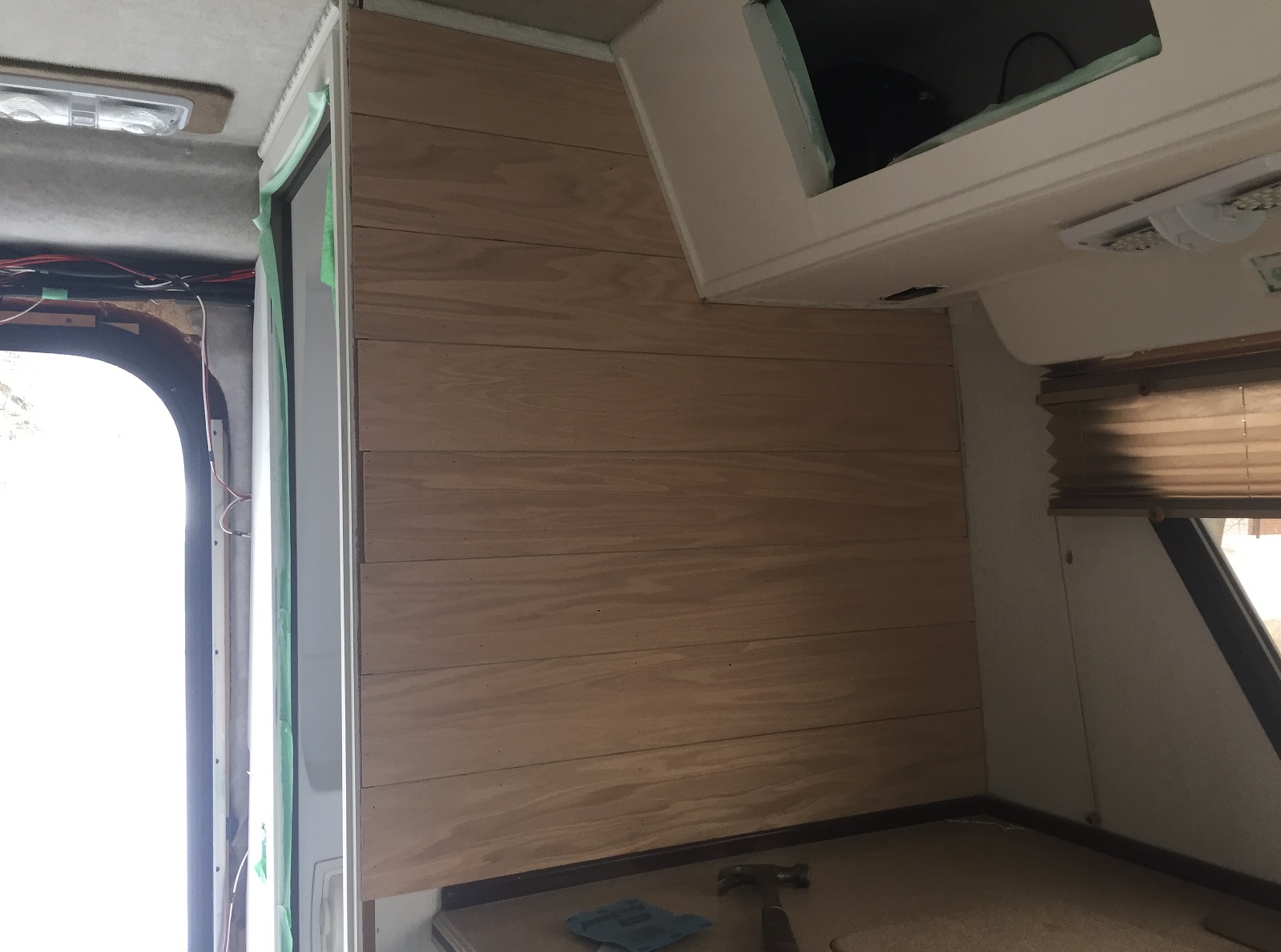

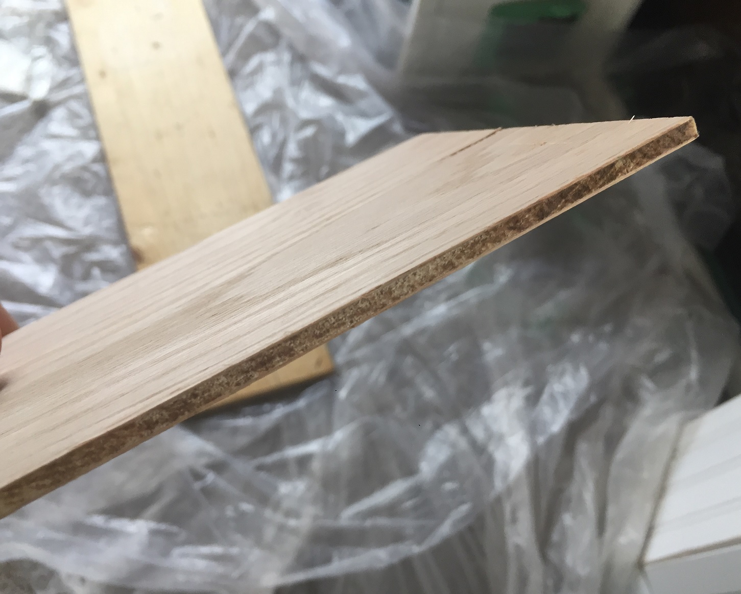

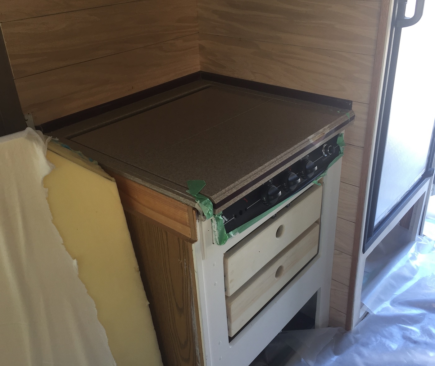

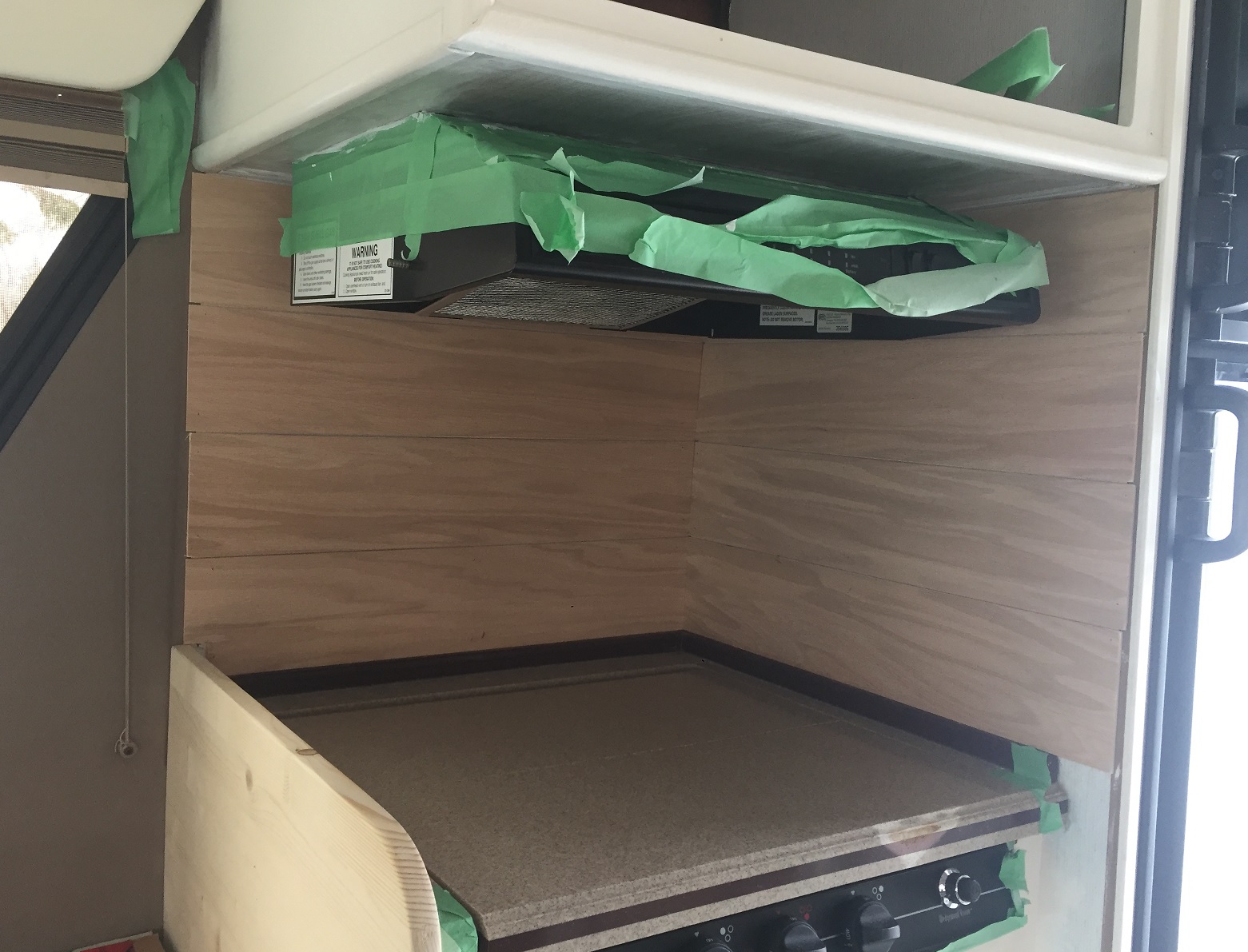

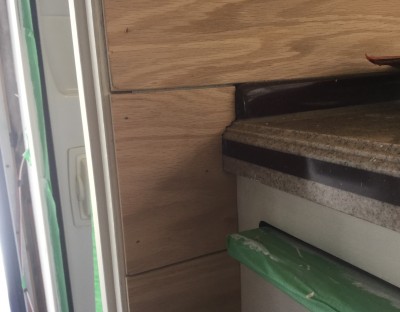

Got started on my backsplashes today...wanted something cheap and light but that also had to work with everything in place such as the Corian side pieces that sit on top of the counters and my existing bed trim. The clear oak plywood I got is only 1/8" thick so sits on top of the Corian and creates a nice transition downwards and doesn't stick out too much. It's pretty light and the G1S (good one side) face will take paint perfectly which is important as Shiplap is usually painted white like mine will be. Finally, my fridge panel was broken so it's also the perfect thickness to do matching panels in the bottom and top panels for that. As many of you know, getting a new panel into the bottom almost means taking the fridge out to do it. These horizontal panels will load up from the bottom easily. I ripped each piece down to 5" width plus 1/8" gap and they fill the walls just about perfectly in terms of height.

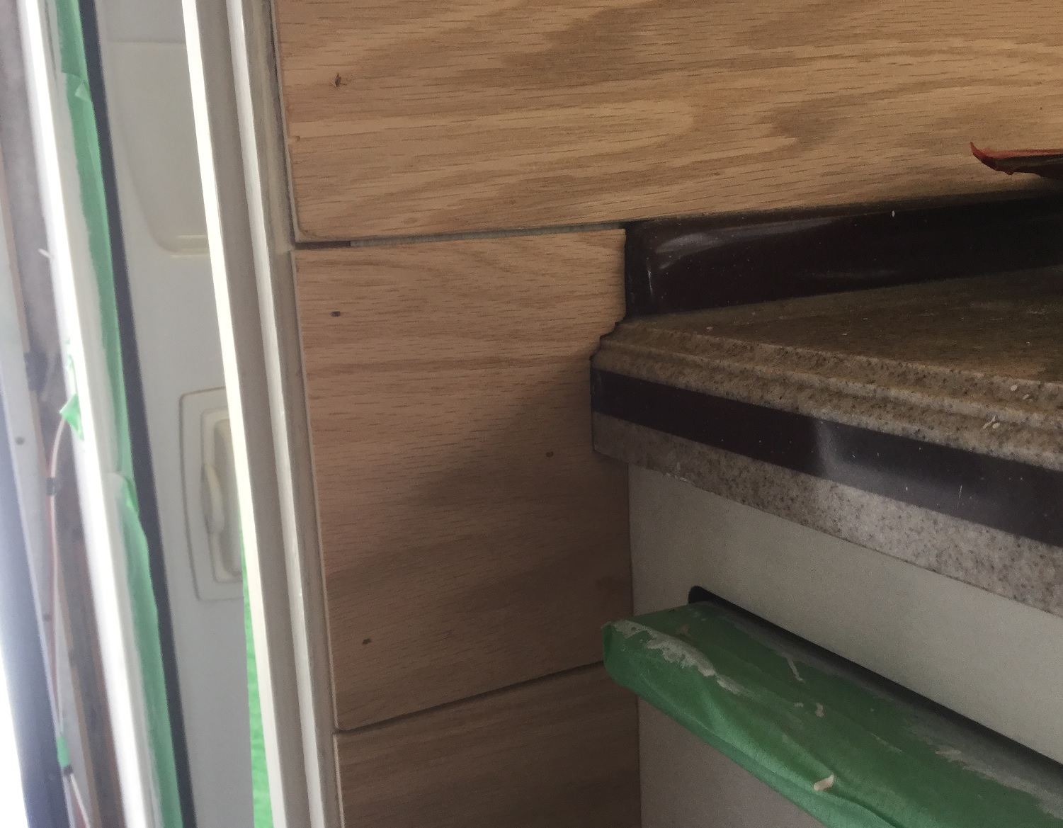

Plenty to do like outside corner moulding, small infill pieces on the cabinet sides, etc., but I am very happy with how it's all going together. 5/8" brad nails and PL Premium glue have everything holding tightly. As a side note, each piece needs it's inside corner ends scribe fit because the outer walls are curved. Beveling them a few degrees worked perfectly.

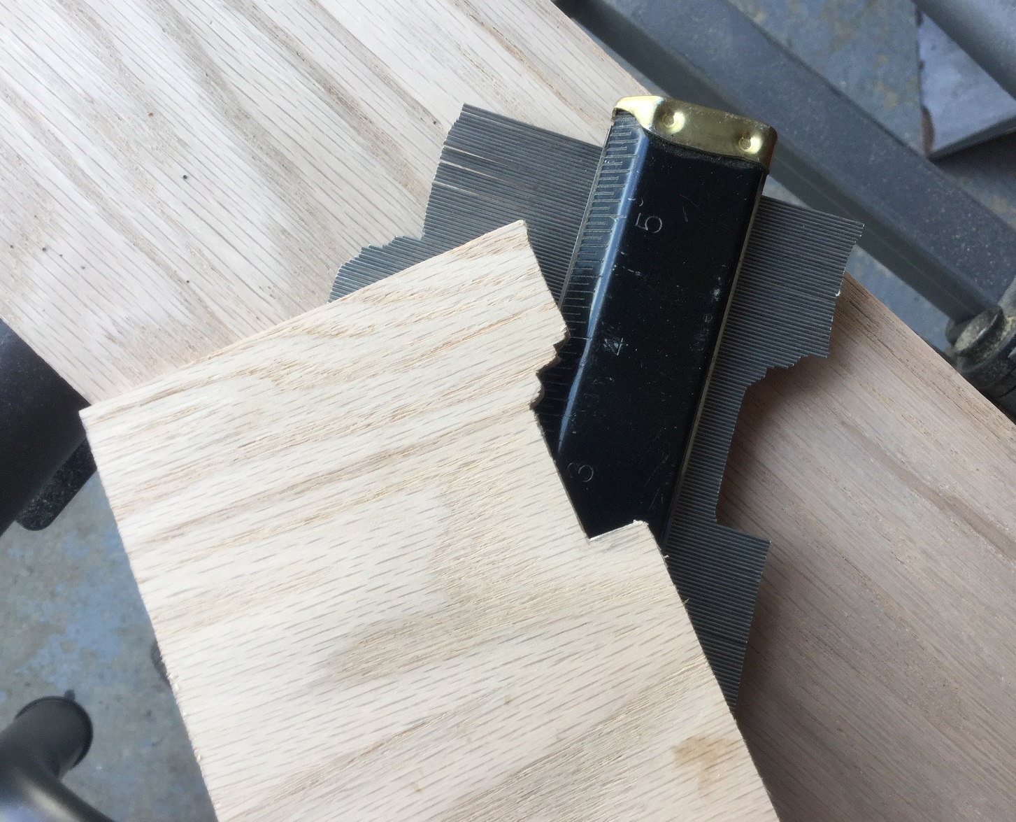

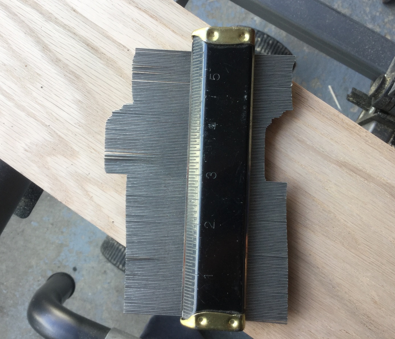

This tool is also excellent for setting compound shapes, just push the pins into your object and it creates the outline for you. It's never exact but gets you close so you can finish it with a chisel and some sandpaper. These cuts have to be made with a jewelers/coping saw and they create a lot of tear out, especially trying to get angles so tiny but it looks pretty good. A small bead of caulk around the entire edge will finish everything nicely.

Nice work Dano. Enjoying your projects. I have one of those templating tools. They are invaluable in woodworking.

Thanks Steve! After looking at the final photo, I just noticed I cut one of the tiny ogee curves backwards! It will still completely cover but still! I blame the tool! (...and I'll leave that up to you to decide which one is the tool
