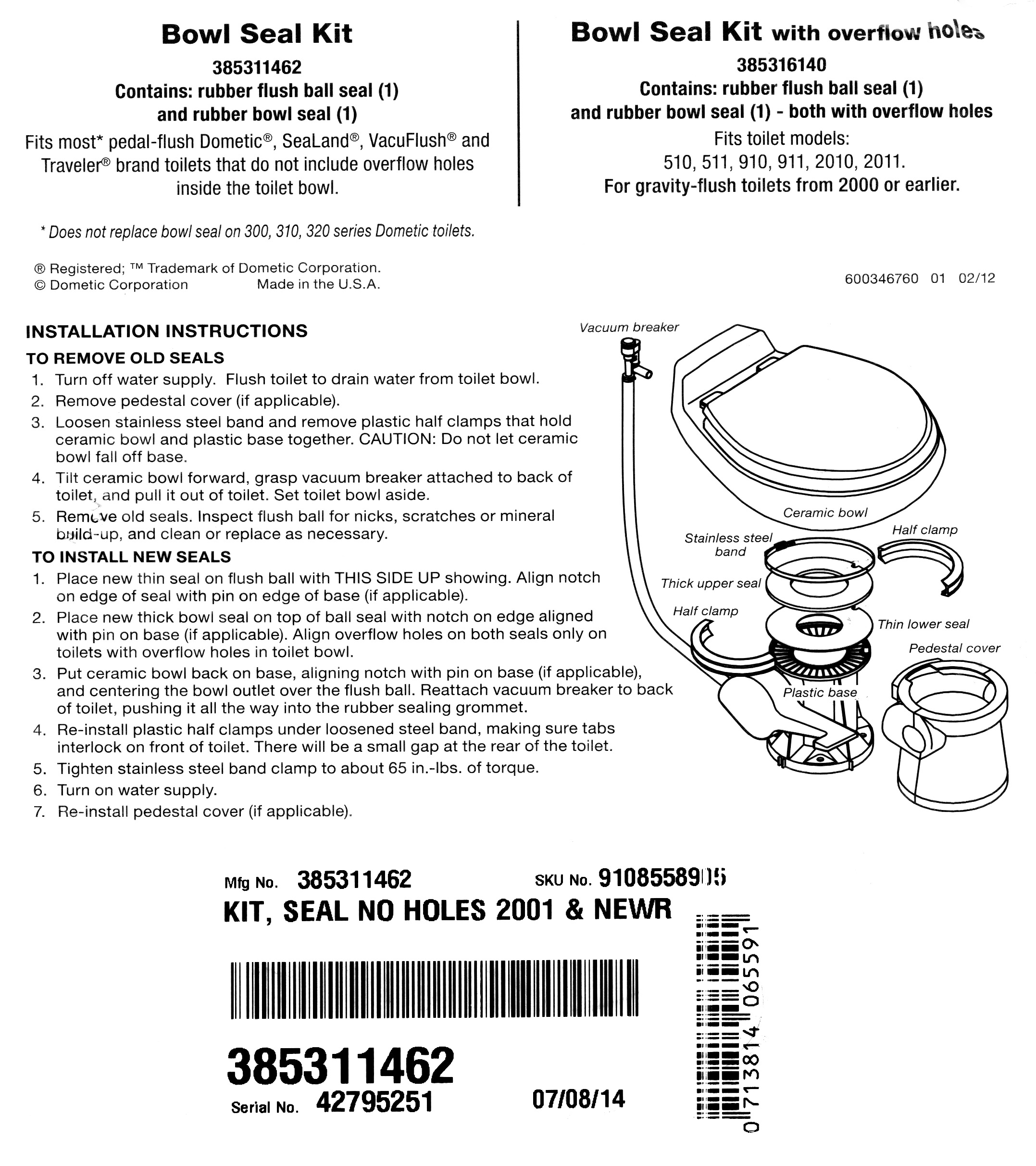

How does one get the old seal out? Anyone know the specific part for a new one? (Mine leaks down instead of keeping water up top)

Okay, sorry to say this, but apparently you have to pretty much disassemble the whole toilet. Buddy had to do this many times over the years (he rolls eyes while saying this). What you need is called a "bowl seal kit" and is part number is 385311462. The seal kit does include instructions on how to make the repair. Buddy says "it's not going to be fun, but the instructions do tell you just what to do."
Just to confirm, my Chinook (and buddy's rig) have the Sealand Traveler model 511 (the 510 is the tall version of the same toilet - we have the short version since our toilets sit on a pedestal of sorts). Just so we're for sure talking about the same toilet.
Here are the instructions in .jpeg form, just so you can get an idea.
BTW, said buddy did just buy a new/different toilet which does not require disassembly to replace a seal. ;)

ahh crap! (almost literally). I wonder how much camping world charge to change it. Doesn't sound easy or pleasant.
