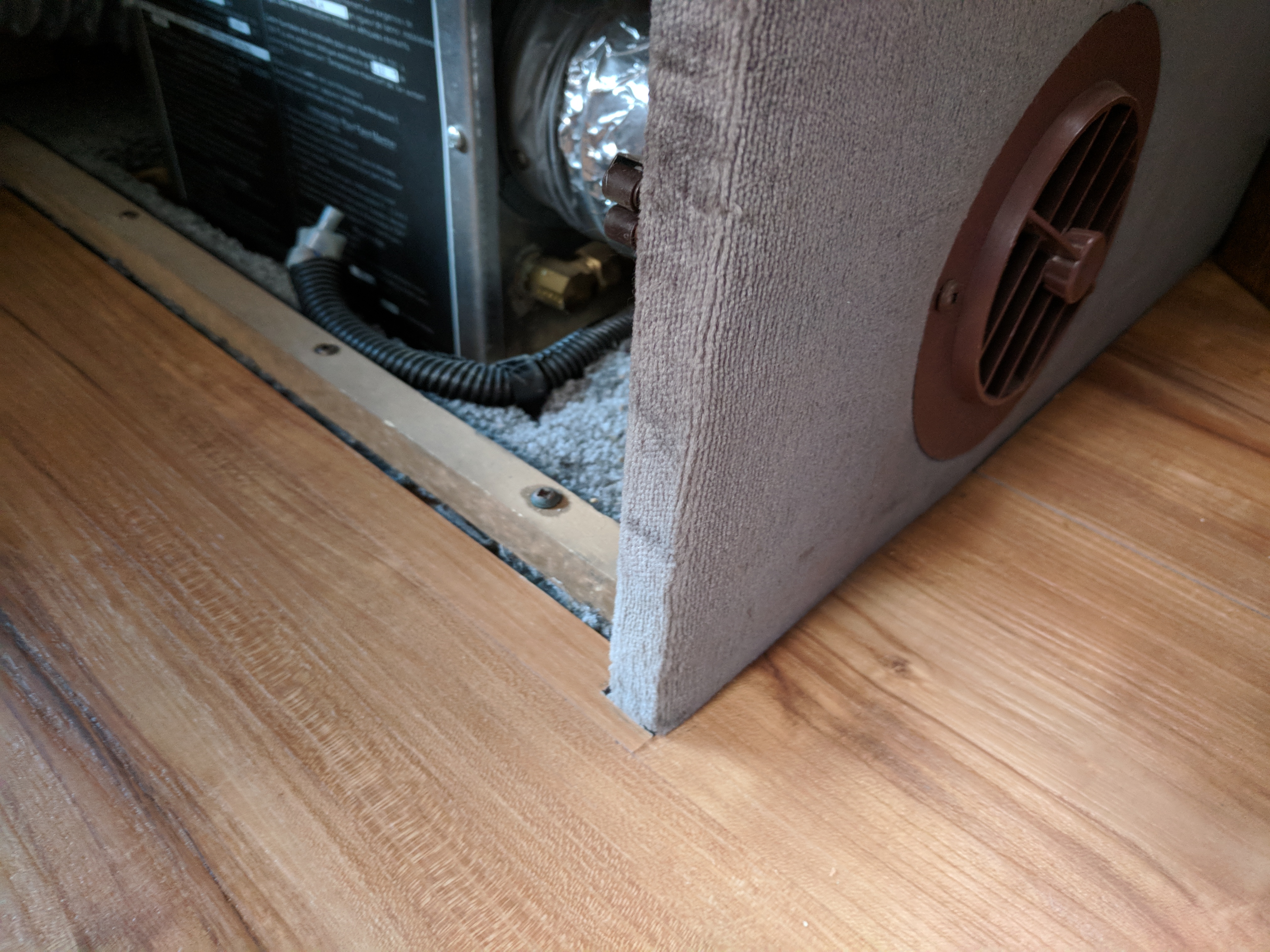

First off, vinyl plank flooring is not "too heavy" in the grand scheme of things. There is not that much floor area to cover. That is what I installed recently. It won't work in the cab however. When I pulled the carpet, there was a high quality rubber underlayment, which I left in place as an underlayment for the vinyl planks. It was about 1/4" rubber and covered all the exposed bolt heads etc. to leave a flat surface for the new floor. It also provides a cushiony feel for the new floor which is quite pleasant.
I trimmed the flooring around the chair boxes, and no trim was necessary. Same with the pull down doors. I removed the fold down door and sides from the front of the sofa, and re-installed it over the new floor, so the floor covers the storage area below the sofa in front of the water tank. This is where we store our double sleeping bag.
I saved the lighted trim in front of the top step and re-used it with the new flooring, so the lighted step still works. I removed the brown paint, so it has an aluminum finish.

The vinyl planks are about 1/4" thick and can only be installed on a flat surface. The planks "click" together and are not glued down. It is a "floating" floor to allow for expansion and contraction, which is not very significant over the small area of the Chinook. This floor probably weighs about 80 pounds, which would not be much more than a wood underlayment and linoleum. We did a "transition" between the cab and the rear creating about a one inch vertical step down to the cab. We just left the carpet in the cab.TheBluebird wrote: December 20th, 2018, 6:05 pm Wow, I didn't think about just removing the doors, that is very helpful. Caconcourse, why won't your floor work for the cab area? What did you do for that area then? I am very close to weight limit when fully loaded, so I do want to keep the weight factor in mind. Have no idea how much this floor weighs.
I would heartily recommend you reuse the carpet underlayment, as it is a very good surface, already in place and covers all the irregularities (bolts) in the subfloor. Assuming you have the same rubber underlayment we have of course. It will also save a lot of time and trouble in the installation of the new surface.
Here are some more pics showing the transition to the cab and the area under the jackknife sofa, where I cut around the sofa brackets.
