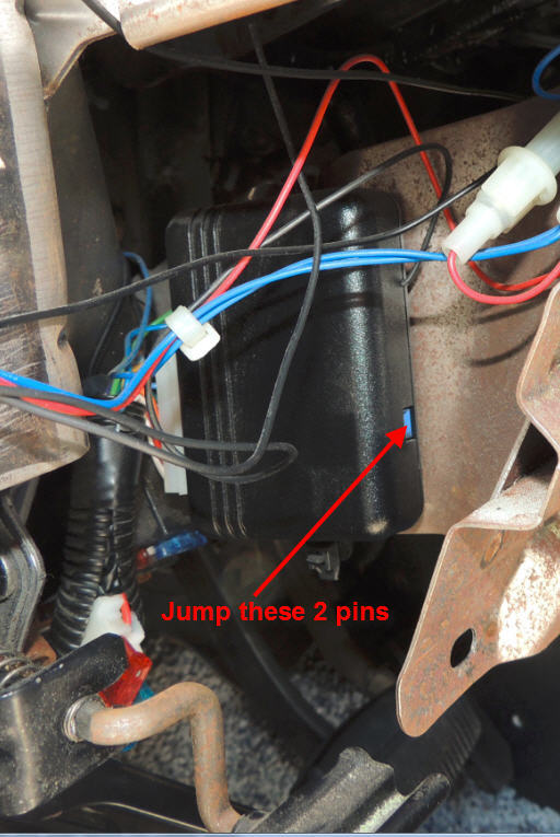

Is this the Marksmen remote key entry system that came with the Chinook? You can try resetting the receiver in the van and reprogramming it to your remote(s). Pop the drivers side knee panel off and the receiver is the black box. If you need the reprogramming instructions I can post them.

These are my notes when I programmed a second remote:
Remove the driver’s side knee panel which just pops of with spring push pins across the top and the bottom. Locate the Marksman keyless entry module (see picture). There is no Valet switch installed just the pins for the harness. Jump these two pins to put the module in programming mode. Did this using the tip of a pair of needlenose pliers. Jump the pins 6 times with the ignition on and it will put the module in Auto Channel mode which is the two-button config (one for On and another button for Off). Then push any button on one remote fob, there will be a relay click (the horn relay which isn’t hooked up) signifying the key fob was programmed, then push any button on the second remote fob (if you have one), and turn off the ignition for ten seconds.
Also see the attached PDF file official Marksman instruction sheet.

Interesting. I followed this:
1) ignition on
2) needle nose to the thingie under the steering column 6 times
3) hit lock button on remote 1
4) then 2
5) then 1
6) then 2
7) ignition off for 10 seconds
Now only the lock button does anything on the 4 button remotes. The lock button acts like a toggle. Locked then unlock. Which is fine.. Just not sure why my unlock button on the remote(s) became useless.
