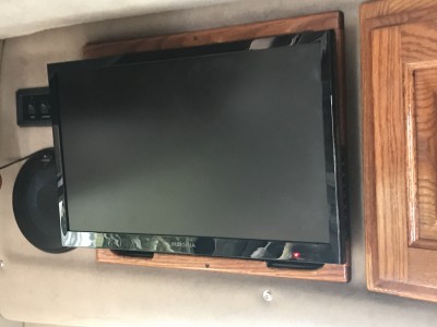

This weekend I finally got around to installing the flat screen and removing the old. I utilized my brother who is good at working with electricity and he converted my 19" Insignia tv to run off 12v. I'm sure everyone here knows but look for a tv that will do both regular as well as 12v. I found it listed on the box. We turned off the main breaker and I pulled the fuse that powers the tv in that area of the Chinook for good measure. He cut the wall wart off of the line that normally plugs in the tv to the wall. Then he cut the end that plugs into the back of the old tv. Interesting rectangle connection there I haven't seen before. Soldered the lines together and also checked the polarity on the plug that goes into the tv. Get that wrong and fry the tv. After making sure the tv works, unplugged and set about creating the mount at the old spot.
2 things: I didn't feel like going out to match the stain of the current wood. Everything I used I had at home, including the tv mount that I had gotten years ago for a tv that I didn't end up using it for. So it literally sat around collecting dust. I forgot to check the clearance for the center cabinet door that raises up. It hits the side of the tv if I have the tv facing the aisle. I didn't feel like removing the tv from the mount (lots of turns with the allen wrench in a confined area) so if I want to get into that center cabinet, I just turn the tv towards the window.

The 1st picture shows the hole after the old tv was taken out. Picture 2 is how that hole is going to be covered. Picture 3 is a cross-member I put in because I'm afraid the sides won't support the tv as it bounces around when I'm driving. My fear is that it would pull out, even though 3 of the 4 sides have wood behind it.

Picture 4 is how the mount goes onto the wood and you can see the other screws I put in to hold it to the cross-member. Picture 5 is the hole I drilled for any cables. I'm considering a grommet or something but I'm not sure any wires will really move around that much. Pic 6 is a close-up after it's all together and getting signal over the air. Univision!

And lastly pic 7, a little further back. I'm pleased with my placement and how the mount articulates on all axis. Between laying on the couch or sitting at the dinette, I have perfect views. I'll have to see how it'll bug me when I need access to the center cabinet. I don't really want to re-drill and I really don't go into that cabinet that often so I might keep things as is.
