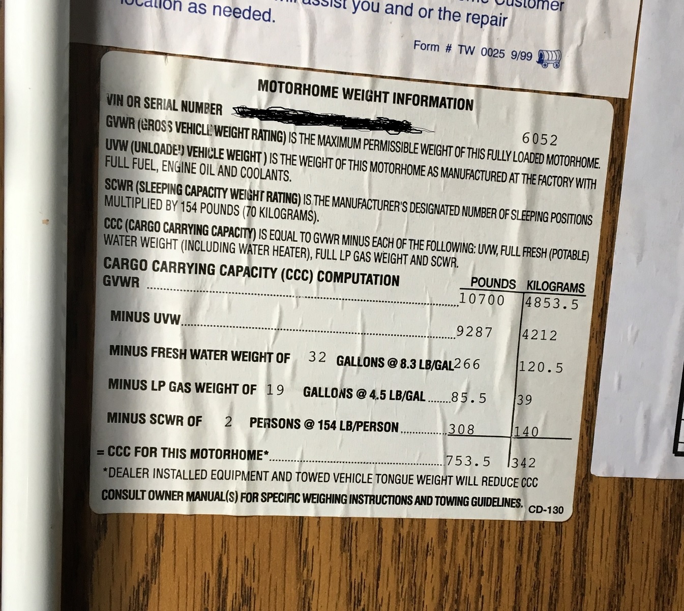

This is my weigh sticker inside the closet on my 2002, maybe it will help you get to where you need to be...dano

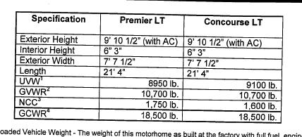

Attached is a shot of the manual referencing weights for the year 2000 models. Not knowing which generator you have, check the manufacturers specs and subtract.
