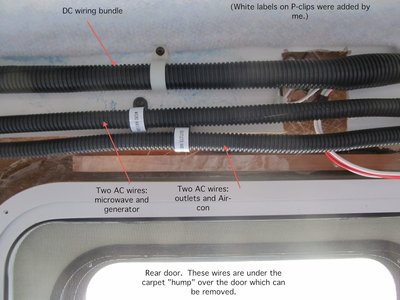

First of all, all of the outlets (except the microwave) are on the same, single, "outlets" circuit, which is fed with 14AWG wire. Since your issue seems related to the "outlets" circuit, we'll concentrate on that. It starts at the brown box, then goes to the "master outlet," which is the GFCI outlet by the rear door/bathroom side. From there it turns into two main runs, one that goes up the driver's side (which we'll ignore for now), and one that goes behind the shower, then up over the door to the passenger side. The 14AWG wire that feeds the ones on the passenger side, runs over the rear door in the same loom as the Air-con 12AWG wire. These AC wires are all solid copper "Romex" type three-conductor wire. Here is how things look as they cross to "the other" (passenger) side over the door (a click should enlarge if necessary).
