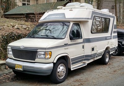

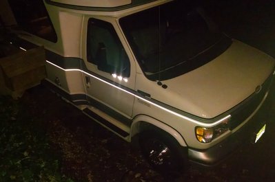

So I was looking at Ford Chinook photos, when it suddenly hit me that they all have a mid belt indentation down the entire vehicle.

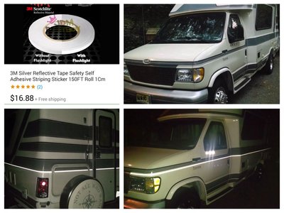

Perfect place to put a reflective stripe! I thought. So I ordered a thin roll of silver-white 3M reflective tape, and put it in the groove. As you can see from the photos, it's nearly invisible in the daytime, but very visible when lit at night:
reflective applied
reflective applied
high reflection
high reflection
The cool thing is that the angle it's placed at doesn't matter. It always reflects straight back to the light source. Here, that means the camera seeing the reflected light from its flash.
The downside is that most approaching cars' headlights are lower than the Ford belt line, and thus don't reflect back as much to a driver's eyes. So I think I'm going to add another reflective line lower down.
I might use this other cool 3M tape I got, which appears to be black striping in the daylight, but reflects white at night. It's amazing stuff. I'll put it over my current lower black stripe.
black reflective
black reflective
Btw, I had originally thought about embedding a fishing line thin 12v powered glow wire in that belt line instead. But my glow wire is more blue than white, and police departments tend to frown on anyone else using blue lights.

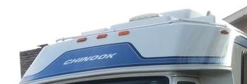

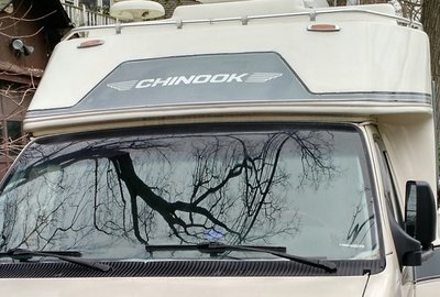

Man it's been a long winter. Haven't gotten hardly anything done on the Chinook in months.
So when it warned up to 50F today (just before we get another 3-5" of snow tonight) I cut out more reflective vinyl lettering and installed it.
Yes, I went a little art deco with the wings :D
wings top
wings top
wings front
wings front

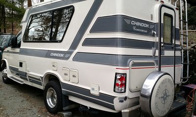

Also added "Concourse" to the back. It's from an enlarged scan of the ones on the front fenders:
wings rear
wings rear
Can't wait to see them all shine at night!
