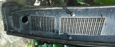

In my continuing quest to clean everything on this 25 year old chassis, my attention turned to my windshield cowl.
- cowl
I had already repainted it and the wiper arms with flat black, which makes them look like new.
But I got curious as to what crud might've collected over decades under the cowl, and probably also helped make the AC smell a bit musty.
So, I removed the wiper arms (lift a lock tab and pry up at the outermost rim) and the twelve #8 x 1-1/4 black automotive trim screws. Then the driver side cowl half lifts first. Watch for sprayer hoses.

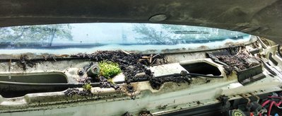

O. M. G. It was like a mini terrarium under there
Took lots of scooping to clean that and all the collected muck out from down in the openings.
- dirt
Note the rubber sheet and plastic shield at the right which protects the wiper motor underneath. At least they were still in good shape.

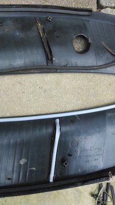

Also noticed that the rubber cowl seals (top of pic) that sit along the bottom of the windshield had turned hard and curved, so I'll be replacing those as well:
- seal

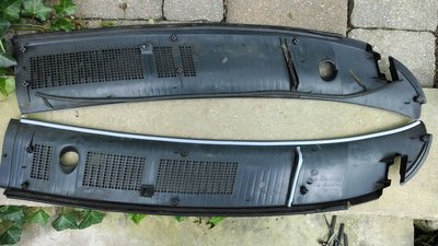

And here's pics comparing original and new::
- new2
- new3

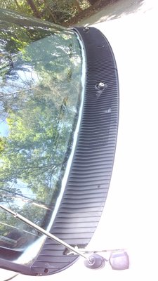

I'm not ready to remove the cowling to investigate under, but the top fins of mine look dull and dry. What is a good treatment to protect whatever it is made of? I have spray Armor All which would be much easier to put on than something wipe-on. Or should it be waxed along with the rest of the RV?

Jeanie, is your cowl unscratched and still all black?
If so, use the spray.
If not, I'd mask off a couple feet in each direction and repaint it with flat black spray, so it'll look like new.
