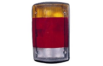

Yeah the early ones were supposed to be stock Econoline. Lots of those lights available on eBay and Amazon. For instance,
https://www.amazon.com/1992-1993-1994-E ... B004DS1L30
1992-1994 Econoline light

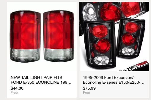

While we need confirmation, I'm pretty certain that owners with the smooth version like above should also be able to use the 1995-2006 Econoline lights that are red & white. Plus a choice of custom lights if you want a different look. E.g. on eBay:
1995-2006 E350 lights

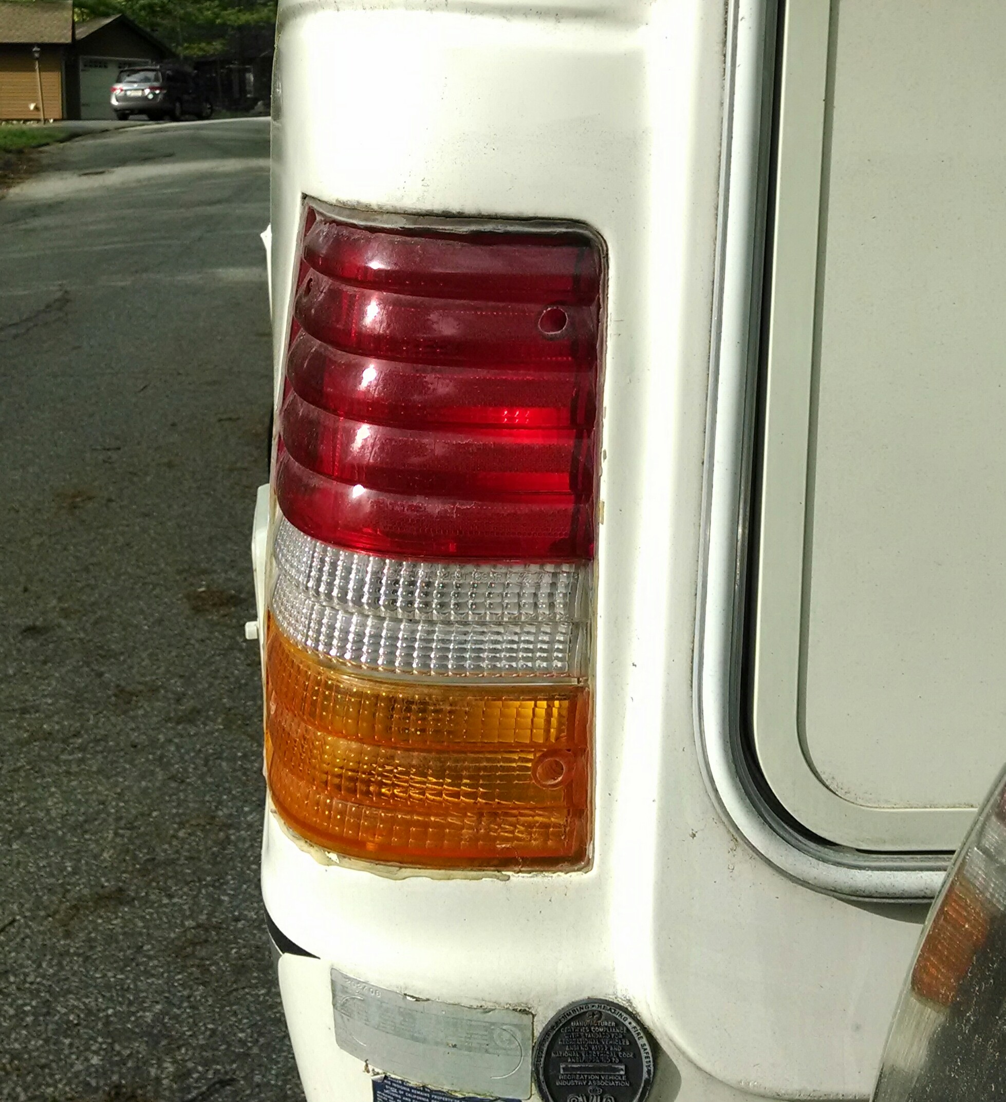

Edit: well, I finally looked at their part number (duh) and figured out what tail lights Chinook put on my Concourse... they used 1989 Aerostar tail lights !!! No wonder Econoline lights didn't fit. Well, at least I finally know. Mischief managed!
1989 Aerostar used in my 1994 Concourse
Checking my picture collection, I now see that Chinook used the Aerostar lights up through mid 1995. I even found what is likely a late 1991 flat hood Ford Concourse with them, probably a result of the mold starting to be updated for 1992.

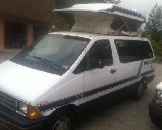

Interestingly, Chinook sold an all wheel drive Aerostar popup roof camper in at least 1991. That must be where they got the idea for using that particular lens.
1991 Chinook Aerostar

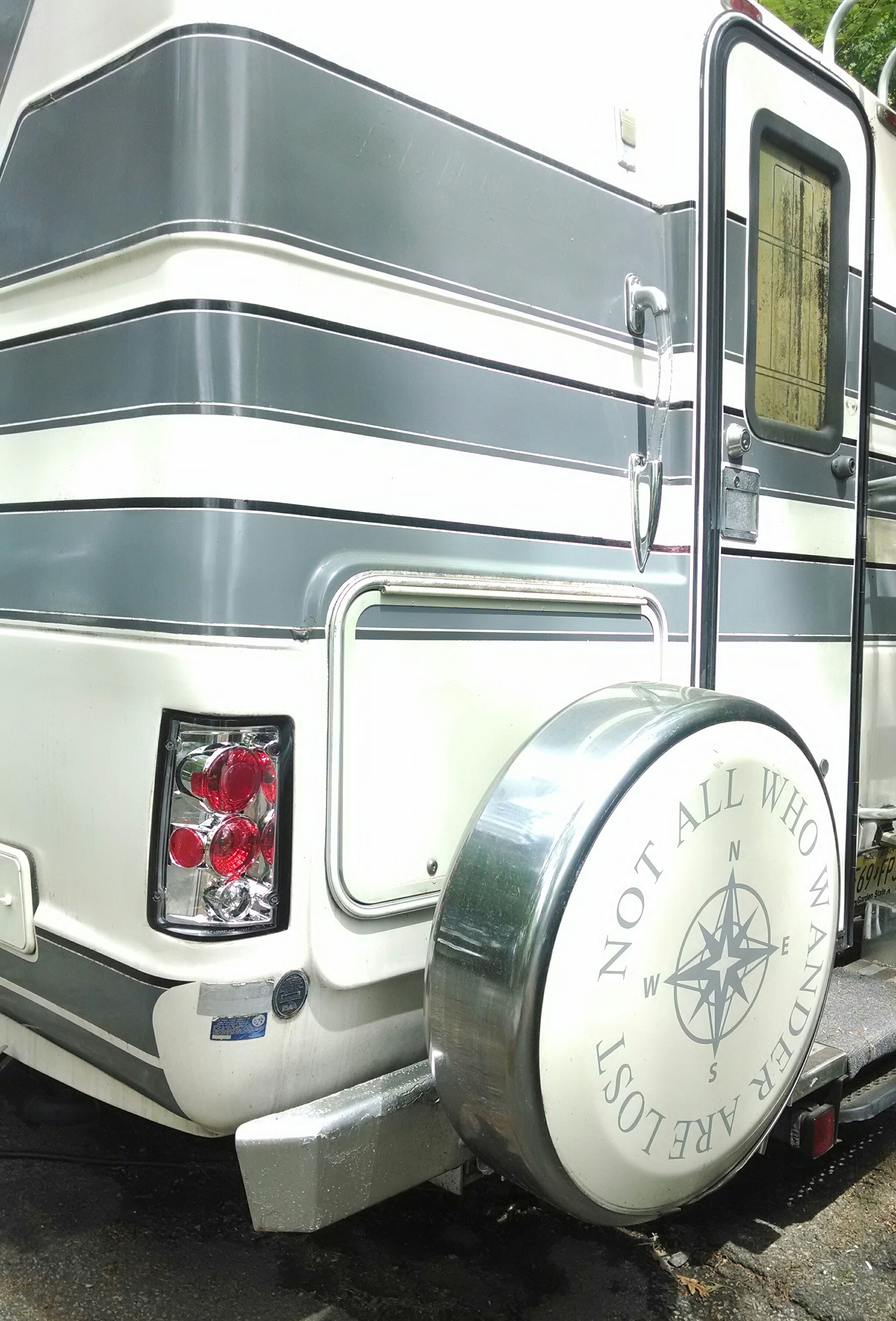

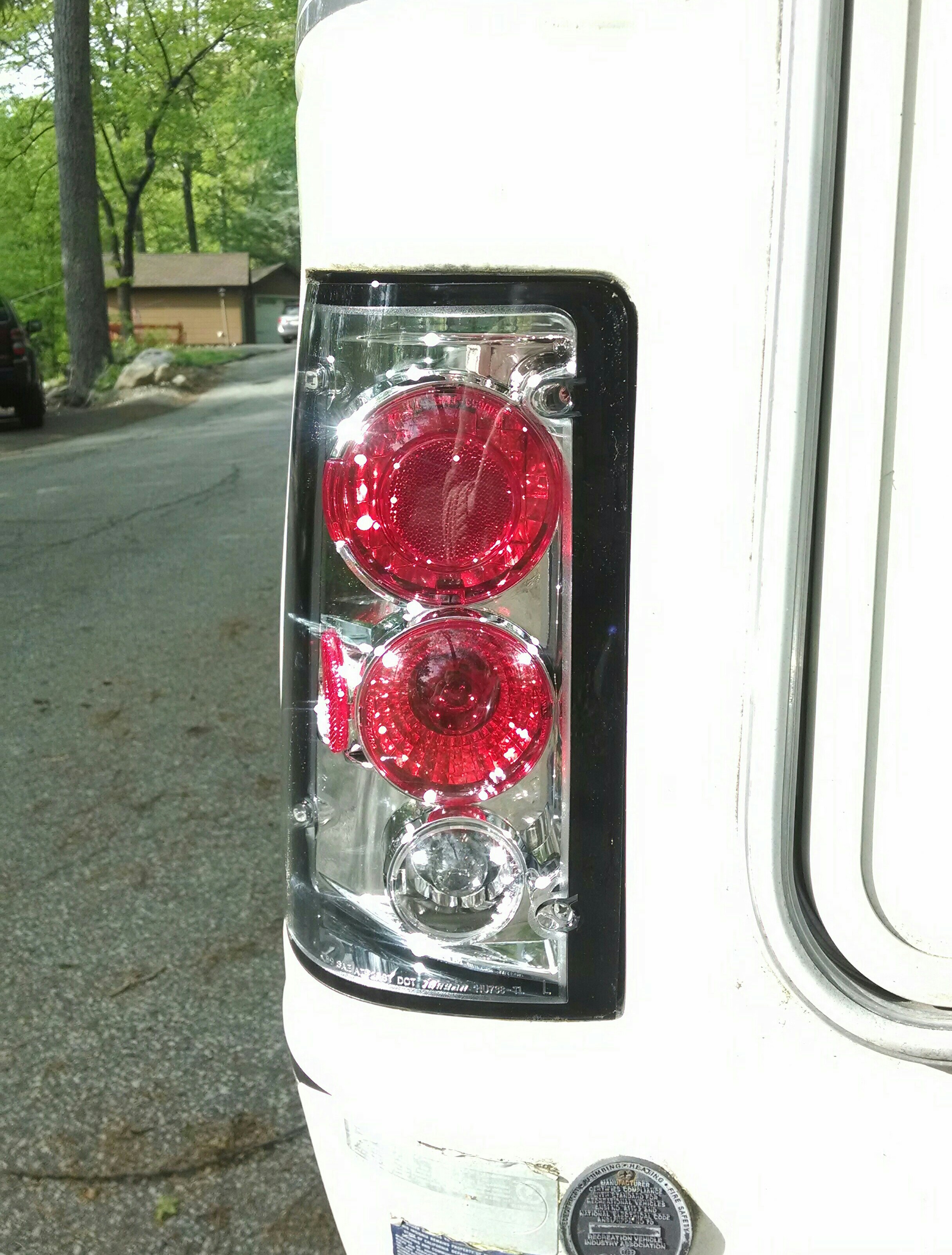

Okay, now that I knew the earlier units used Aerostar tail lights, I simply had to try to modernize mine to match my front LED daytime lights and billet grille :D
While there are lots of cool aftermarket taillights for the Econoline and Expedition versions, I only found one Aerostar aftermarket set. So..
From this crusty old lens:
Aerostar lens
Aerostar lens
To this Euro style:
Aftermarket Euro lens
(Still cleaning up old caulking someone had put around old lens.)
new rear
new rear
Still not sure I love them yet, as I miss the yellow a bit, but I do like the modernized feel of them... and of course, having a unique Chinook with them :). --- edit six months later: I love them!
