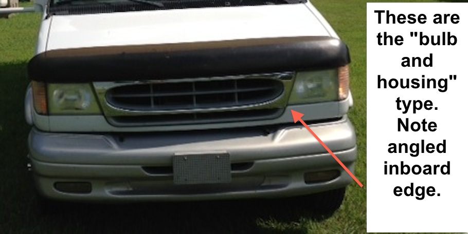

One note though: I'm surprised you have the sealed beam headlights. I thought those were more often on work type vans. Both my '99 Chinook and my buddy's other-brand 2003 E-450 cutaway have the regular, non-sealed beam headlights (i.e. there is a "permanent" body and lens and you only replace the bulb). I've never seen the sealed beams on a Chinook. Not that you don't know your own rig (maybe someone converted them).

Just to be sure you have sealed beam, here are the "housing and bulb" type that I have (and I think most Chinooks and non-commercial vans have). In contrast, the sealed beam headlights are symmetrically rectangular and then there is a larger non-clear plastic surround to fill in the angled inboard section. It'll get larger if you click.

Blu - I think you may be right. My headlights look exactly like the ones in your photo - I think I just assumed they were sealed beams. Going out right now to check...
Okay. I vow to never again order parts after midnight. You're right - they are a bulb replacement style rather than sealed beams. The plastic lenses are yellowed somewhat so that's not helping night vision.
