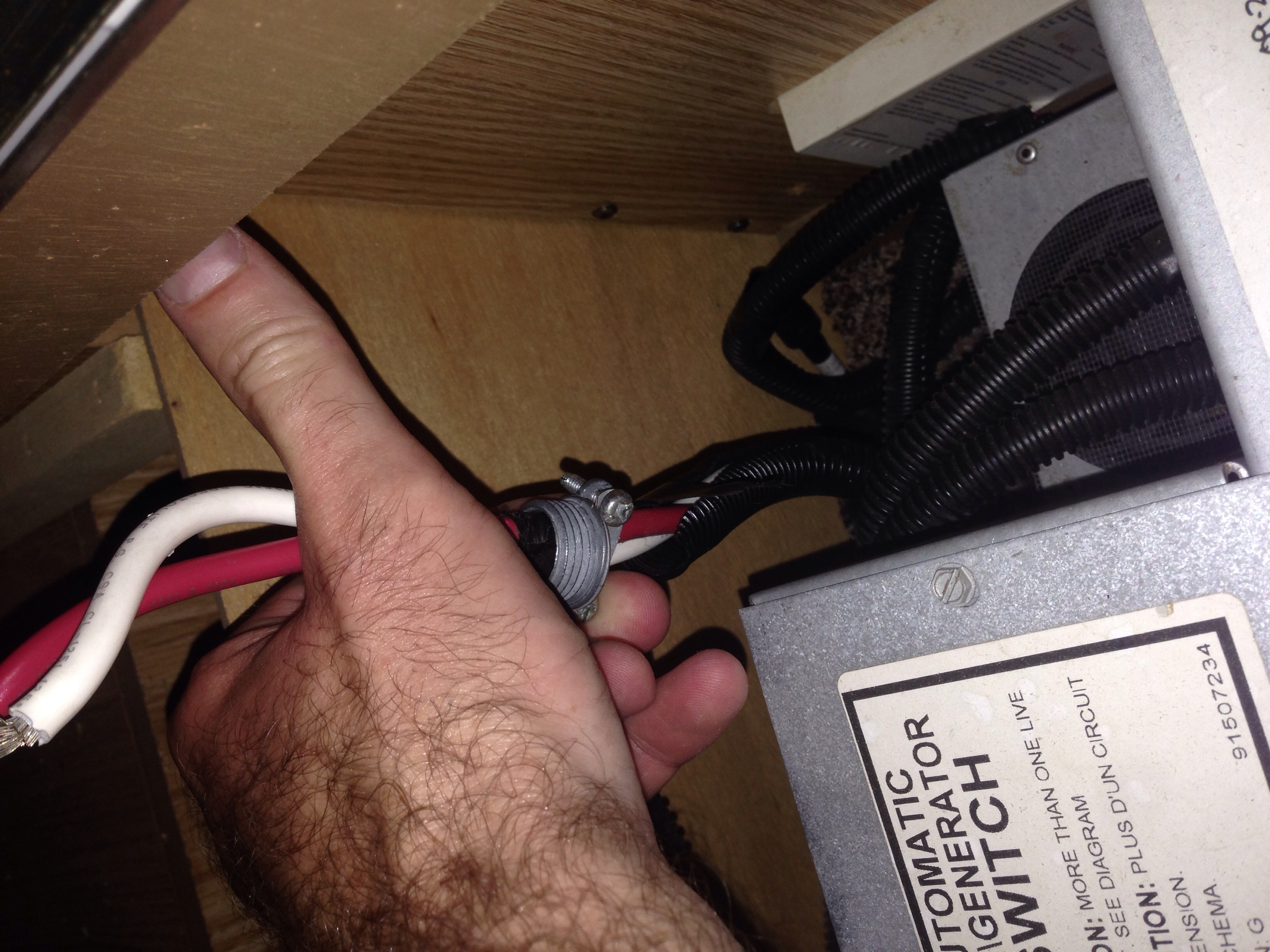

I had read (and slightly experienced) about over charging issues with the stock charger. I wanted to replace it with a whole house inverter like the magnum hybrid 3k, but $200 vs $1500. I found I can run the ac on an extension cord (heavy gauge..12? Maybe it's 14). I'm just talking about a regular 15amp outlet. I'm sure to run the fridge on propane and flip off the charger's breaker when I do run the A/C though. This is all I really wanted to be able to do with the hybrid inverter and since I can without spending $1500.. I opted for this upgrade instead. I didn't like the constant slow charge though. The new unit was pretty straight forward to install and has multiple charging setting that it does automagically. The big 2 being a "bulk" charge rather than having to wait 4-5 hrs.. And a trickle charge rather than boiling your batteries when they are already full.

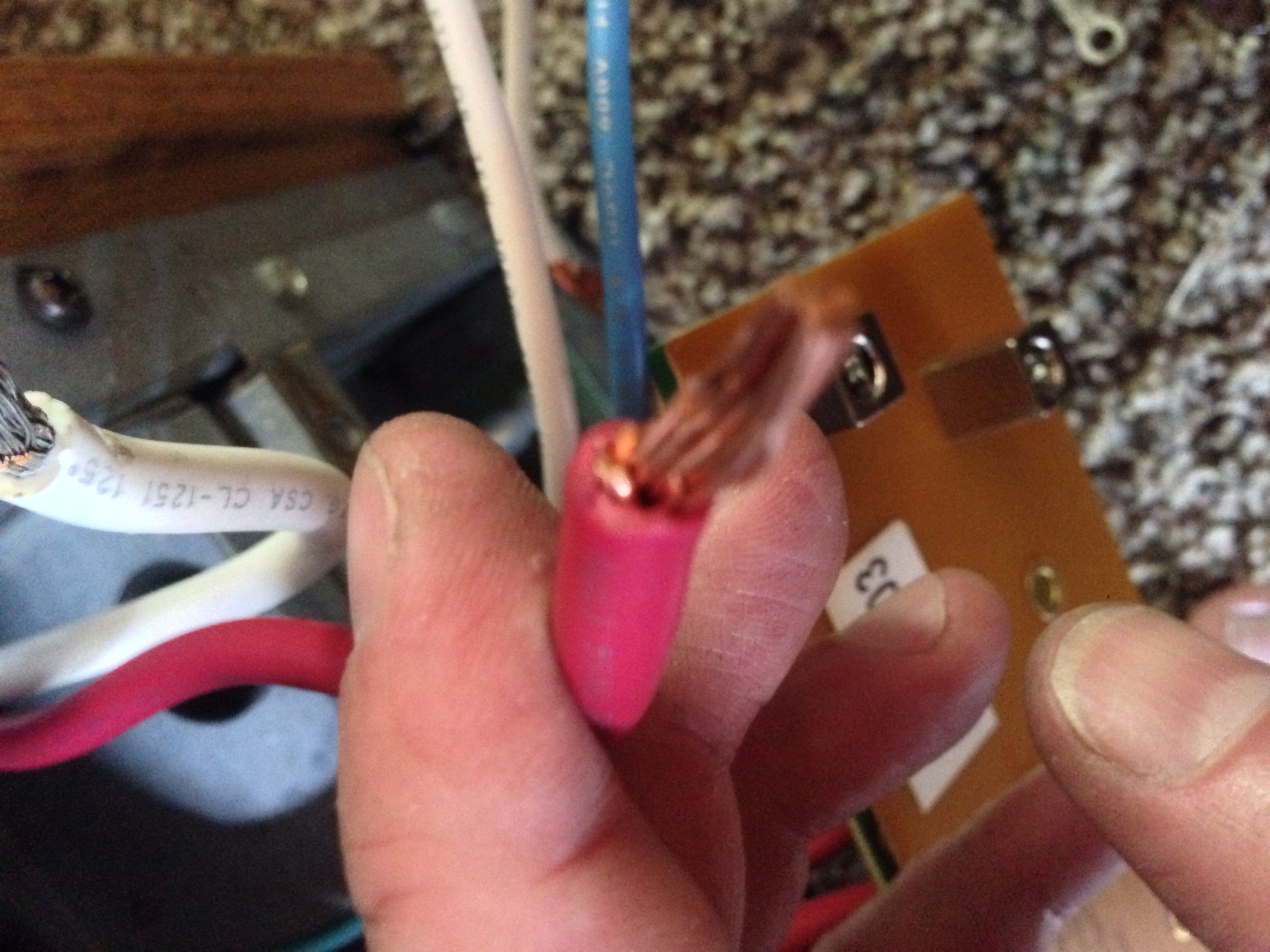

One disturbing thing I found was that the DC wires were only partially installed on the old DC block (see pic for "snipped" wires). Since I upgraded to 55 amp's vs 45amps against the recommendations (they are concerned with wire sizes), I wanted the best connections possible. I had to get more slack by removing the drawer above the power center and adjusting some of the cable management. Then strip a little fresh wire and use that. Not a huge deal, but all in all this replacement took me about 3hrs. This includes finding all the right tools and putting everything away. Actual work time is probably only an hour.
