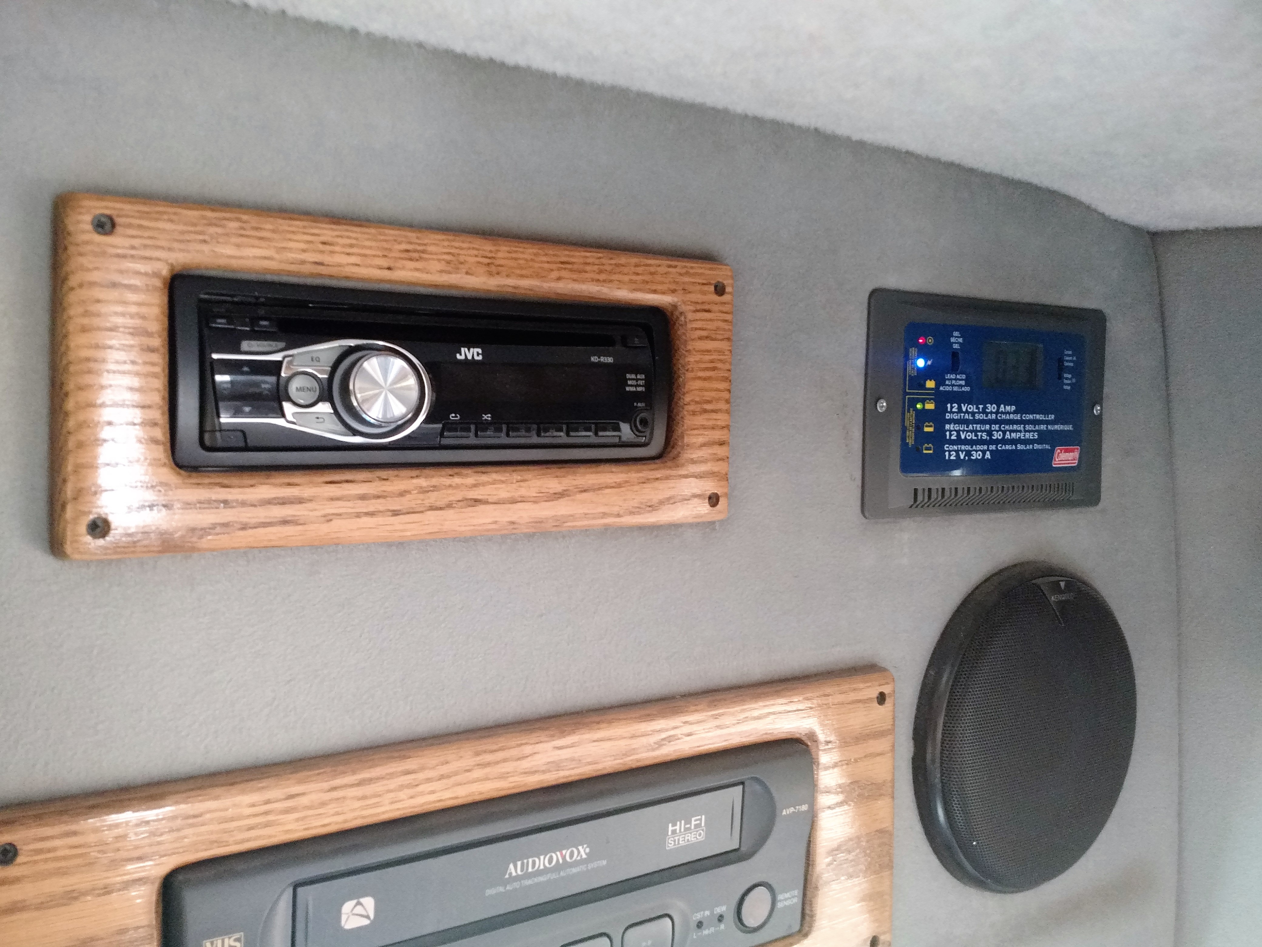

I installed a small 12 volt flat screen TV/DVD combo in place of the tv. I then installed a Double Din AM/FM/DVD player in place of the old VCR. Instead of using the DVD in the TV I use The one from the AM/FM/DVD as I wired it through the house speakers which provides good sound. I'm very happy with the set up. Pretty simple and basic.
EDIT: I just wanted to add that the rocker switch in the third picture was installed to act kinda like an ignition switch where the unit can be turned on and off without losing constant power.

Thanks Scott. Not a lot of choices out there for 12V TV's! Thanks for the heads up on the wires I'll check mine. I installed a J Box w/ 12V cigarette lighter type outlet in the overhead and plug it in only when it is used. When I removed the old TV I filled the hole with some birch plywood and installed an old mount I had on hand. The DVD player required a larger opening but was easily made to look original with a router and some varathane.

I also bought the Axess TV/DVD. The viewing angle is not very good, but we have a tilt mount so we tip the TV forward to get a good angle from below. For the sound I used a stereo cable connected from the headphone jack on the TV to the AUX input of our coach stereo. (The cord has 3.5mm stereo jacks on both ends). I found a JVC stereo with AUX inputs on the front and the rear, so the speaker cord is permanently plugged into the rear AUX connector. This way we get great sound through the stereo and the four built-in coach speakers with no external wires. We still use the VHS player, so there is a stereo AV cable from the VHS to the TV as well. I cut off the 12v power plug and spliced the wires into the original TV power cable in the cabinet.
