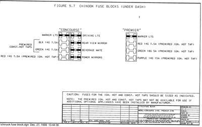

4) And the really tricky (and somewhat stupid IMO) part is that Chinook, apparently in an effort to be tidy and logical (that part is good), not only used the Ford trailer towing wiring that Ford ran to the rear of the frame (by the trailer hookup), but they THEN ran a (long, skinny) wire from right back there ALL THE WAY up to the added Chinook fuse block that's by the driver's left shin (Labeled "Marker Lights" and having a pretty small fuse of 7.5 amps (upper left slot of the added fuse block). They then ran another long, skinny wire ALL THE WAY BACK to the trailer lights connector and the taillights, and then more long, skinny wires forward to the marker lights. Do we have enough long, skinny wires running the length of the rig yet? And of course powering a bunch of non-LED bulbs (Chinook marker and taillights) PLUS whatever lights one's trailer may have.

Just raising the fuse size may be a risky proposition as there is a lot of (did I mention) LONG SKINNY wire on that circuit. And some of it is bundled (reduces ampacity). Every wire size has its rated ampacity, and that tells you how high you can fuse it. I don't know the size of all of the wires in that circuit, so I didn't want to just put in a larger fuse. There is a lot of wire (to potentially cause a problem). So, as I wrote above, my solution was to be sure any trailers I tow have low demands (LED lights). IF I were going to upgrade it, I'd probably re-wire so as to NOT have that super long wire going back/forward/back/forward, etc. (to the tune of 20+ feet each way). (Rather if it needed to be re-fused that could happen aft. Maybe slightly less "satisfying" to not have it all at the fuse block, but electrical function has to be considered as well. There are other electrical choices too, but I've probably gone on long enough for now.

Drawing from 2000 Chinook manual depicting their added fuse block by driver's left shin. This drawing is for the Concourse. Premier has only one row but marker lights fuse is also the top one, also 7.5 amps (according to adjacent drawing in manual).
Photo of actual fuse block in 1999 Concourse. "Missing" fuse previously powered the black/grey tank "auto drains" (shudder!).
