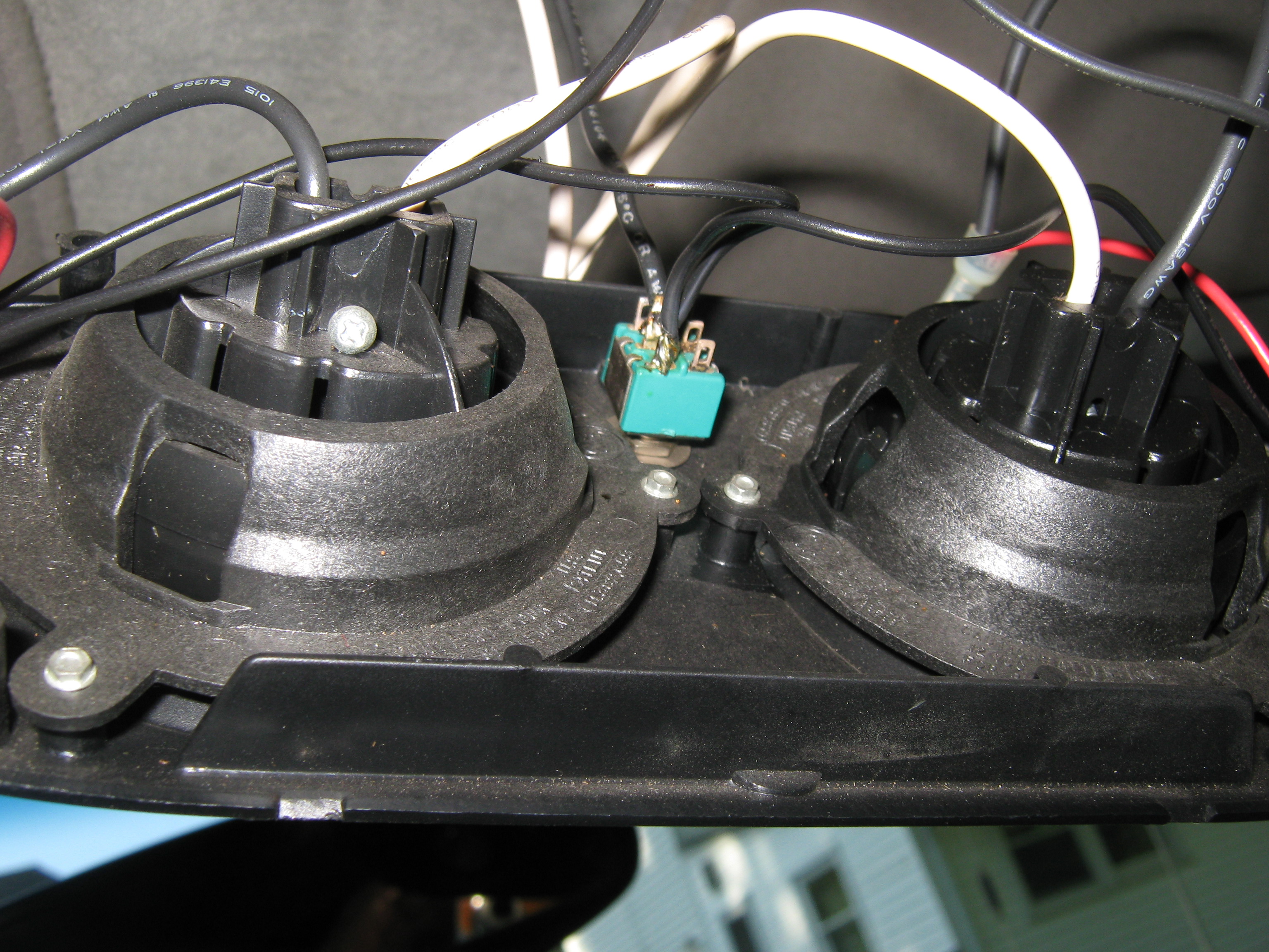

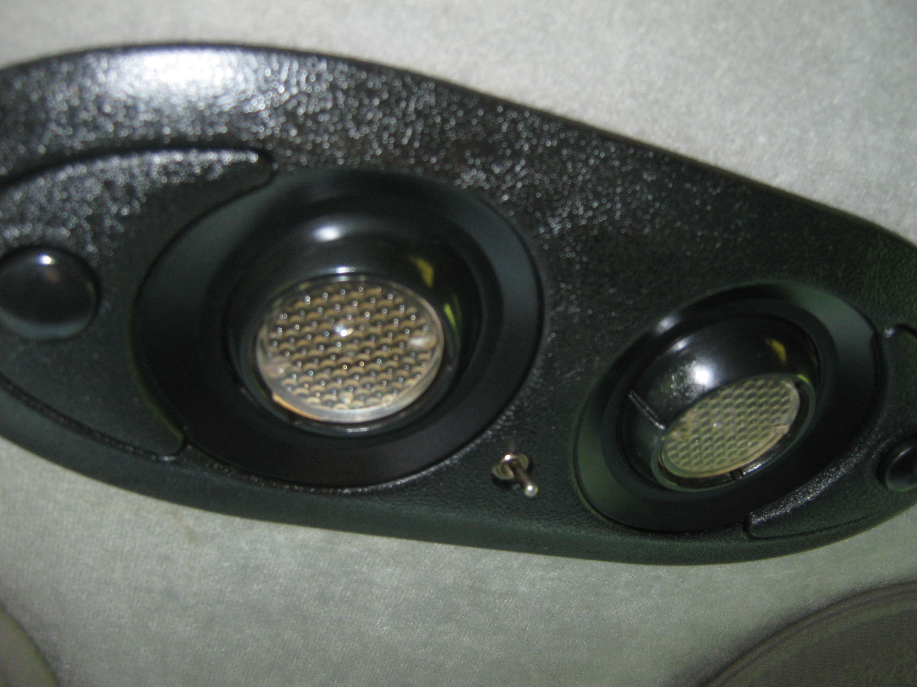

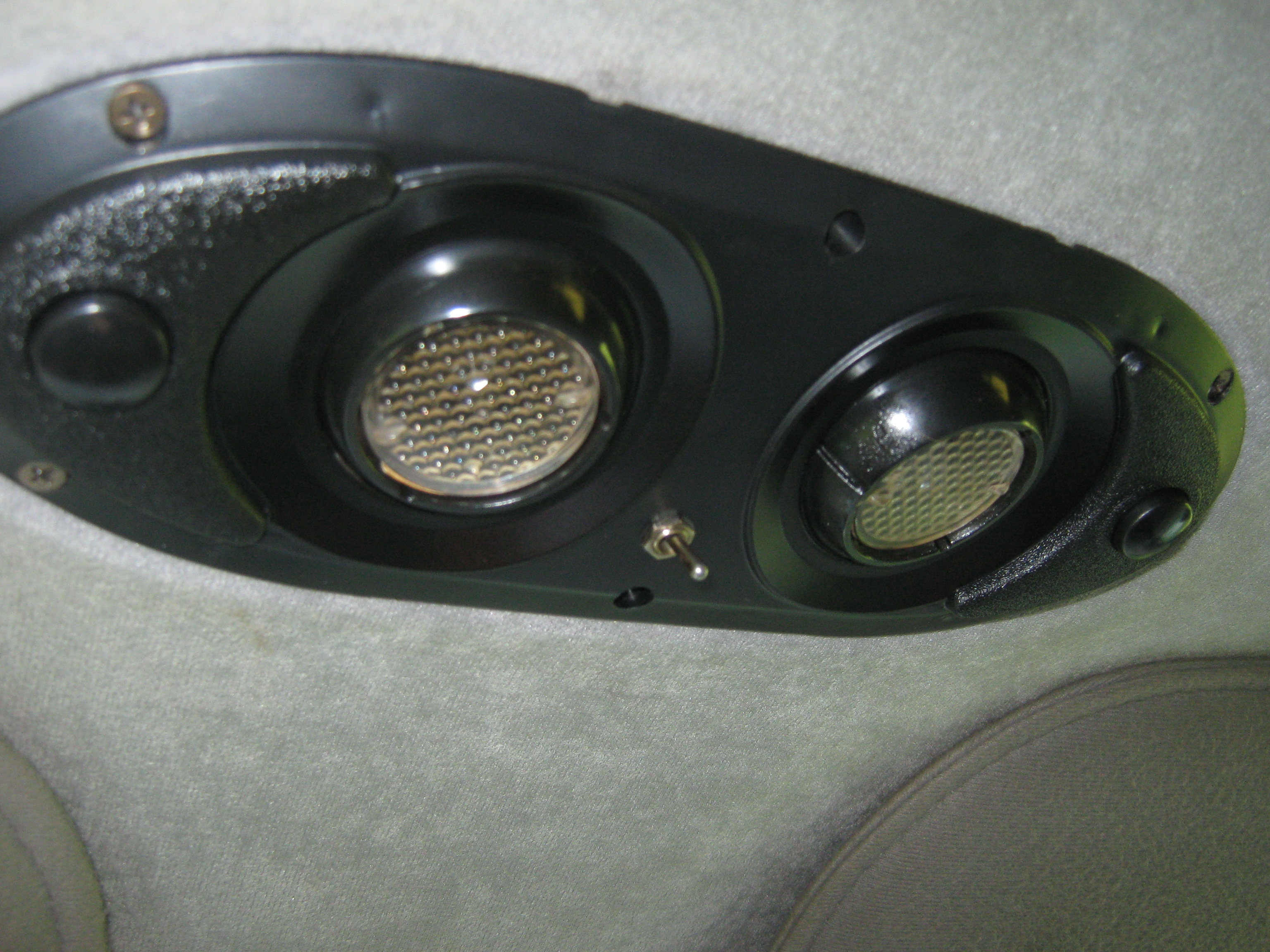

My chime was also irritating. Find the chime module (mine was under the dash to the right of the steering column) and simply put a piece of tape over the ports for the chime. It may be necessary to remove the knee kick panel to access the module. While this doesn't disable the chime, but it will quiet it down to an acceptable level.
As for the dome lights, I installed a switch on the light plate to interrupt the circuit from the 2 switches (see photos). The switch can either be a push on-push off or a toggle type. Any auto parts store will have one. The cover plate is held in place on the ends. Use care in removing this plate as there are only small protrusions that hold it in place. Drill holes in the base plate and the cover at the same time (for alignment) to accommodate the switch, then drill a larger hole in the cover plate to accommodate the switch nut diameter.
Disconnect the three black wires going to the existing switches, and connect the two wires from the existing switches to one of the new switch connections. Connect the other black wire to the other connection of the new switch. Mount the switch and close up the panels. Now if you want the dome light on, flip the switch and it will operate normally.
