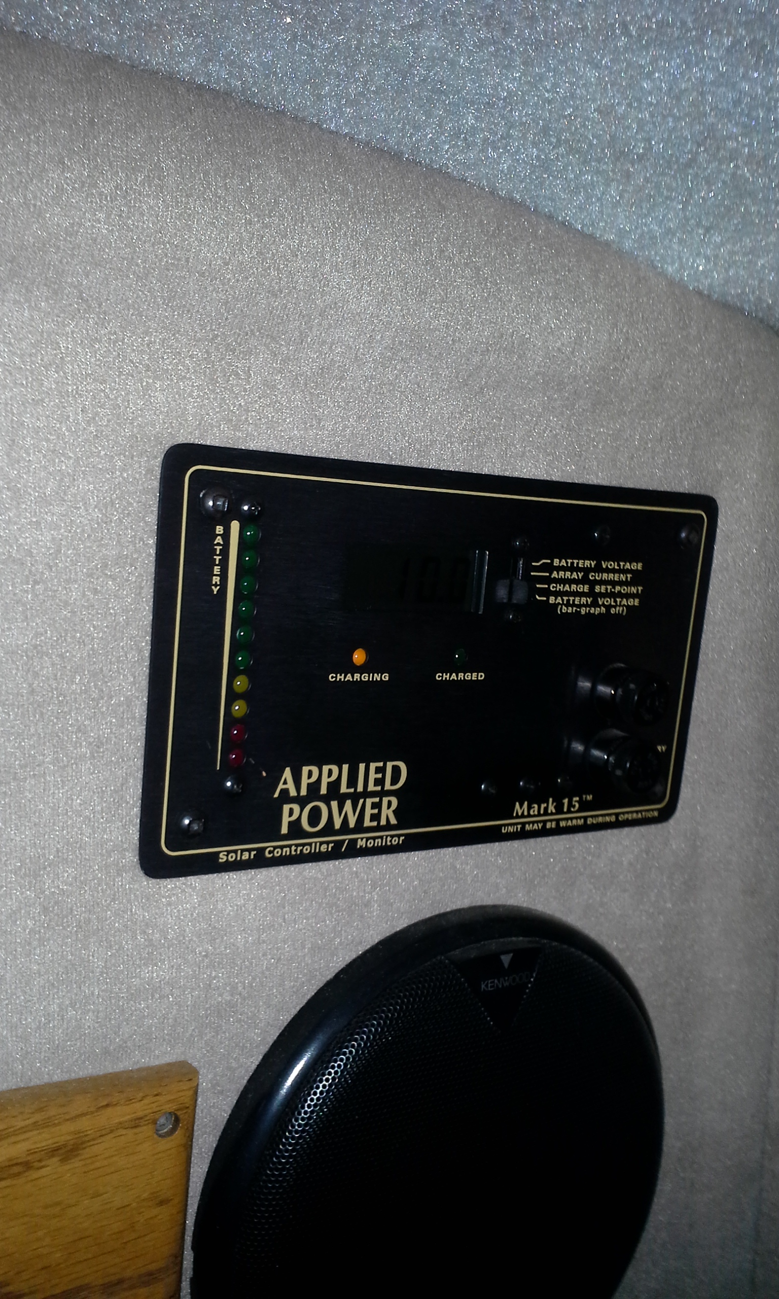

I have mounted a couple of these (one in my Chinook, and one in a friend's van). While they do/can generate heat, it's not like they are burning hot, in my experience. Each time I mounted them on a hard surface. I also placed some washers behind them so that they stand slightly proud of the surface. Why not let a little bit of air flow behind them, I figured.
In the Chinook I moved my batteries to under the couch, where they are in a battery box I made. The controller is mounted to the outside "wall" of the battery box. So it's very close to the batteries (good), but not right in with them or over them (would be bad). I have around 5" below and above the controller. I don't store anything in such a way that it could fall on the controller (one could put something like hardware cloth or etc. around it if that were a risk). By the way, the meter will show the temperature of the controller. Mine is rarely above "room temperature" - or not by much anyway. Not that you want to dismiss heat dissipation, but it probably won't be hot enough to fry eggs, based on my experience. I have never had an overtemp alarm (it keeps data).
Since the output of the controller is between 13 and 14 volts (or so), it's good to have it as close as possible to the batteries. If you have it further away, that can work too, but the cables would have to be a lot thicker to keep to the same level of voltage drop. I try to keep that leg especially under 1%. Why throw away power, is my feeling, and plus you want the very specific voltage that you paid good money for your controller to produce to get to the batteries at the specified level. (On the leg of wiring from the panels to the controller, if you have voltage drop you are throwing away power, but NOT changing the voltage that your batteries see, since that power just never even gets to the controller. But on the leg from the controller to the batteries, any voltage drop will reduce the precision of the voltage the controller is trying to send to the batteries.)
Since the landing points on the controller will only take up to 10AWG ring terminals (this is a common fault with controllers, I find), you have a couple of choices in the wiring going to the controller (since 10AWG will probably mean too much voltage drop, depending on your setup). You can go right to the controller with a large wire, then "whittle it down" a bit to make it fit into a 10AWG (yellow) ring terminal (then heat shrink over that). Or you can go to a power post of sorts and step down there. That may work out nicely if you already want a switch or a fuse there. So a lot depends on how things lay out.
The meter can be far away and that's no problem.
Does that help? If not, or if I missed something, just shout (I think your battery layout may not be the same as the older Chinooks).
PS: When you are setting up the controller with the custom set points (at least all the batteries I have had required them because something was always not correct with the default choices), there is one setting that is easy to overlook. This is the rate of temperature compensation. For Lifelines, the default was not correct so I had to change it. What I mean by this is that for every degree over or under 77ºF, the controller will change the voltage by X amount. The X factor in the default settings was not the one Lifeline wants. It's easy enough to change, but also fairly easy to miss.

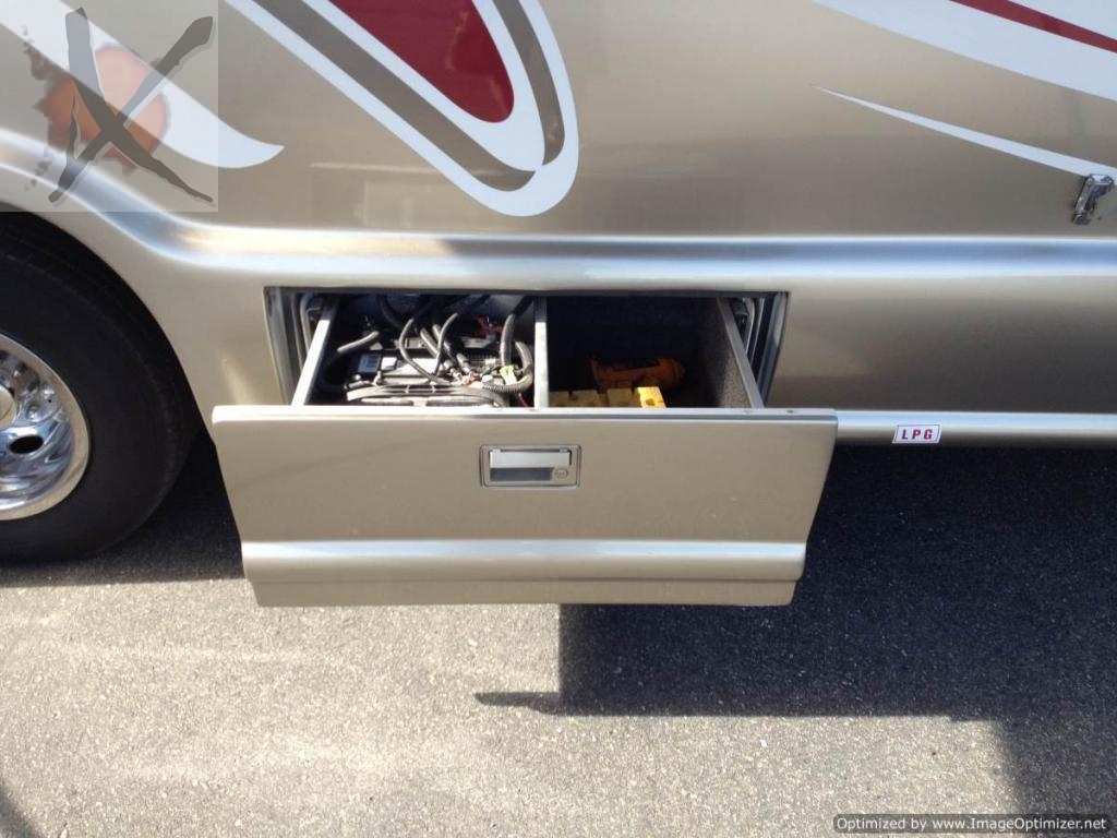

I want to make certain I've chosen all of the correct components before I start to make any purchases. Interested in opinions of the Blue Sky 3000i in comparison to the Morningstar. As I see it, the nice thing about the Blue Sky is, it could easily be blended into the location of the original unit and not look like an afterthought, like the Morningstar.
My 2 batteries are located in the left half of an exterior drawer located on the passenger side and just aft of the propane tank. There is enough room in the front half of that drawer for 2 more batteries if desired. Also, is there a trick to removing that drawer? One side acts like it will come out but the other side acts like there is a stop installed like a normal drawer slide.

BTW, most Chinooks (Concourse and Premier) have the batteries on the driver's side under the water heater, starting around 1997. So basically under the front of the couch, only beneath the floor. I know they changed the compartments around at the very end (say 2005-2006) so that's why yours are on the passenger side. So our stock solar wire run was REALLY long from that controller!

I can see wanting it where the original was, but I'd find something else to put there (built in cubby?) if it were me (actually, it was me, and I filled that hole in with fiberglass, plus cut out the TV/VCR holes to make a large square cupboard matching the one on the TV side. Not that I'm saying you should do that.
So anyway, I have my controller about 2' from the batteries, and that's a good distance. With it up where the original was, you'd be looking at something like 12-15'. Ouch. It IS doable though, and if you measure (I use a hunk of rope) and let me know just how long it is, I could let you know what size wire you'd need to keep a low voltage drop. Of course if you later add panels, then you'd have to have even larger wire (more amps going from controller to battery).
IIRC, there are some other limitations to the 3000i. I researched it when I set up and installed a 300 watt system on a friend's van. I don't remember all the other things though because that one thing (distance) stopped us from using it.

By the way, the real reason my batteries are on the passenger side is, mine is a Destiny, not a Concourse or a Premier. The pictures below are not of my RV but, ones I found online.
