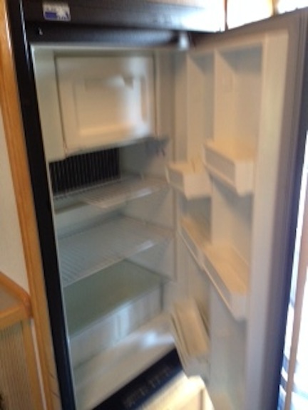

I can't speak to your 1994, but when I was Chinook shopping I looked at a 1999 Chinook Premier - with the single door refrigerator (inner plastic freezer door) - and it was a Norcold model 6053. So there's a chance that's what yours is. It looked like this (sorry for the blurry pic, but it does show what it looks like for ID purposes). If this is the model you have, I have a manual and repair guide I could upload to the reference sub-forum.

That looks very similar to mine. I'd appreciate if you uploaded the manuals.
