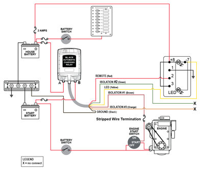

Thank you so much for your prompt response. It's nice to make your acquaintance. I think, you may have mistaken me for someone who knows more than just enough to be dangerous. I looked at the literature and the wiring diagram for the Blue Sea 7622. Looks pretty nice. Most connections made sense. However, I am at a loss as to what the box on the far right with connections #1, #2 and #3 represents and where those connections would be made. Diagram located at the following URL: http://assets.bluesea.com/files/resourc ... L-ACRs.jpg
(Also attempting to attached .jpg of that diagram)

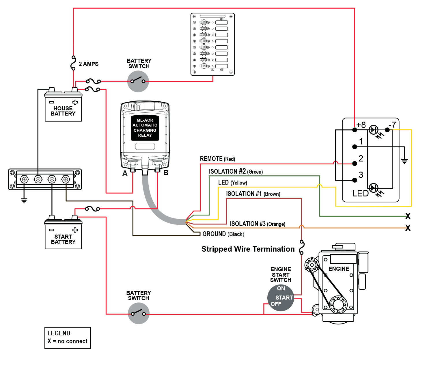

General Snafu wrote: I looked at the literature and the wiring diagram for the Blue Sea 7622. Looks pretty nice. Most connections made sense. However, I am at a loss as to what the box on the far right with connections #1, #2 and #3 represents and where those connections would be made.
That represents the remote switch (the red rectangle in the photos). You're meant to put that somewhere handy to the driver's seat.

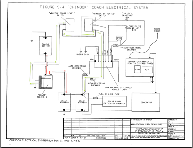

Okay, taking a minute to look at the Chinook diagram again. Reason is I have to go back and remember how the wiring ran (I have re-wired mine and eliminated much of that original wiring.)
Another note is that I don't know if your 2001 Destiny is wired up like the more common (and known by me) Concourse (I have a '99 Concourse, and I also have wiring diagrams for other years of Concourse/Premier). I'm also guessing you have a Chevy chassis, which may or may not make a difference.
Do you have a wiring diagram for your rig in the blue loose-leaf notebook Chinook manual? For now let's look at the 2000 Concourse Chinook DC wiring sketch which is as close as I can get with documentation I have available.
Figure 9.4 in the 2000 Chinook manual (which I believe I made available in the reference section of this forum) probably gets the closest. If you look at that (it's not a schematic, never fear :D) you can see that the smart solenoid has three connections. One is to the start battery (big cable); one is to the house battery (big cable); and one is to the "jump start" switch over the driver's head (smallish wire). Okay, so far so good.
From the jump start switch over the driver's head, there is also a smallish wire (i.e. not a battery cable sized one) that goes to the "vehicle batteries switch" (aka the "store" switch). BUT, as far as I can see, that is only jumpered through to get power - the two functions are not connected. From there (so essentially from the jump start switch) a red wire goes to the LVD (which in this case is just acting as a sort of power post from what I can tell), and thence to the start battery through a 15 amp fuse.
SO, long story short (and of course, I'm not a pro, can't see your rig, etc. etc.) it looks to me as through the original Chinook-installed smart solenoid and its self-jump-start function are basically a stand alone system. The LVD is only involved as a sort of pass through (possibly one could look in the LVD's manual and make sure).
What this says to me is that the Blue Sea 7622 could be installed just purely on its own. The remote switch could either be put in a new location, or in place of the other switch in the overhead console. Perhaps with some research (BS tech help is great if necessary) the original switch could be used, but I'd have to study that a bit.
Looking at the Blue Sea diagram, I see the following:
1) A large cable goes to the start positive.
2) A large cable goes to the house battery (bank) positive.
3) A small red wire goes from the main 7622 unit to the remote switch (which comes with it).
4) A green and an orange wire can be use for start isolation, optionally. This is more of a boat thing so I don't think you'd have any reason to hook it up. The idea is this: On boats you have sensitive electronics like radar and chartplotters, and so you want to make sure they are not seeing any surge from the starting process. But you don't likely have anything like that in a Chinook (indeed I don't even have a problem on the boat and don't have that feature hooked up).
5) The brown isolation wire I'm not sure if you'd want to hook up or not. My guess is no, but I'd have to refresh myself on the instructions.
6) A black ground wire.
So maybe it's not as complicated as it looks :D
I'll see if I can add diagram 9.4 here, but you should be able to see it in higher resolution from the 2000 manual in the reference section, because I think that section has higher limits on upload sizes. I put red and green lines (arbitrary colors) on the wires in question.
