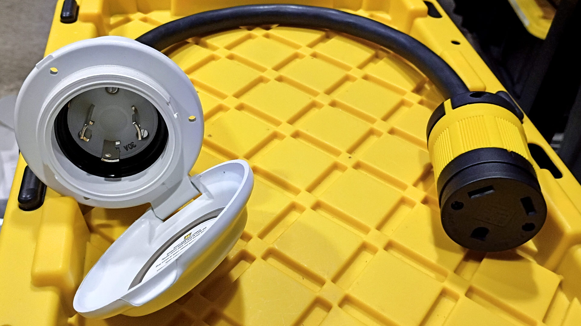

Hi everyone,
Today I wrapped up the exterior portion of my shore power inlet upgrade. I also finished building a custom cable setup that will support the different configurations I plan to use moving forward. Tracking down the right components took some research, but I’m finally getting close to the system I envisioned.
Rather than buying pre-made adapters—which can be surprisingly expensive—I opted to build my own using the existing cable from the original mouse-hole setup. I cut the cables to the lengths I needed and installed 30-amp, 10-gauge plug connectors on each end. Before installing anything, I tested each cable for continuity and proper polarity to ensure everything was wired safely and correctly.
Once the prep work was done, the installation itself went fairly quickly. Since I have a 30-amp receptacle at my home, I was able to plug in and test the new shore power inlet right away. Using an analog receptacle tester, I confirmed that everything was reading correctly with no wiring faults.

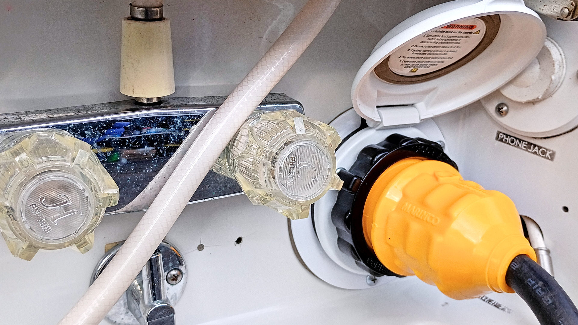

Hi everyone,
As promised, I’m uploading some photos to document the progress on this project. I’ve begun the prep work for the “Service Center” overhaul, which includes removing and replacing several components in that compartment—such as the hinges, gravity-fill hatch, cable plates, San-T-Flush inlet, city water inlet, faucet, and shower hose.
Today I received a set of hinges I ordered from Amazon. I temporarily mounted them with a couple of screws to check alignment without committing to new holes. If new holes were required, it wouldn’t be a major issue, but fortunately the alignment looked promising. What I didn’t like, however, was the opening range. The description claimed a 130° to 170° opening, but as you can see, these hinges definitely don’t open to a full 170°. I’m not sure if that’s due to the brand or an inaccurate listing, but after seeing them in place, I’d much rather have hinges that open 175° to 180°. I don’t want to rely on a second hand to hold the compartment door fully open while working inside the Service Center.
In a previous post, BobW9 was kind enough to share the type of hinges he used:
Selby 150° Opening Surface Mount Concealed Hinge – SEL-HC2000-150
I also saw that they also offered a:
Selby 175° Opening Surface Mount Concealed Hinge – SEL-HC2000-170
After comparing what I currently have, I’m leaning toward the Selby 175° unit. There aren’t clear specifications available on the exact hole spacing, so I’m hoping alignment won’t be an issue.
BobW9—what are your thoughts on these?
I’ll continue posting updates as additional components arrive.

Sorry, I've been busy and didn't check things. Your 130-170 degree hinges are not going up as much as my 150 degree hinges. Yours look more like 120 degree, maybe. Are you sure there isn't some adjustment screw on the hinges to change through the 130-170 range?
Here's my door open as high as it goes. I believe it's the same as my original hinges went.
