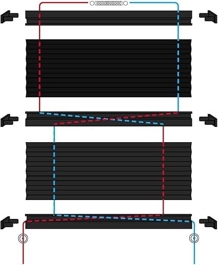

I used a kit from the company below, the RV Day Night Shades. It is fairly easy, though you really need 2 people to hang them after they've been restrung.
https://fixmyblinds.com/collections/rv-day-night-shades
They also have some repair guides to show how to do it:
https://fixmyblinds.com/pages/rv-day-ni ... air-guides
This is a diagram of how they get strung that I saved from someplace years ago when I did it, it was the view that was an easy cheatsheet for me to look at while I was doing it.
